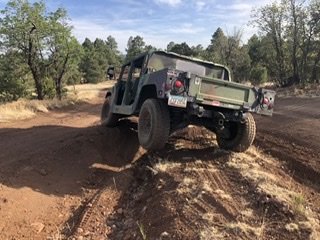

Nice "minis"...but I want to see the HMMWV.
~ More peace, love, laughter & kindness would make the world a MUCH better place [emoji1690]
here ya go,all flexed out!! Lol
