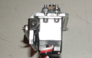

Well good luck, Like I stated, the only carnage for me was I broke one of the ears off after a bad spill down the mountain.
Made a replacement out of aluminum and added the CPE servo mount, still using it!:twisted:

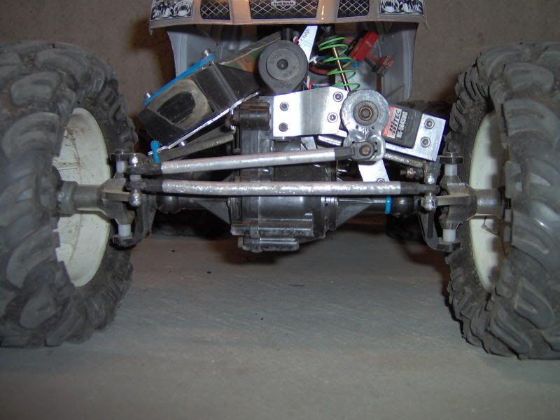

My servo mount should be more then sturdy. I've never broken a servo ear off yet this far into it.
As you can see it's bolted solid to the axle, it does not move at all. I almost always have a big ziptie wrapped around the servo. I use it just to support the servo better then ears. Actually, I don't know why there isn't one in the pic. It's just a old pic, I'm not running savers anymore either.

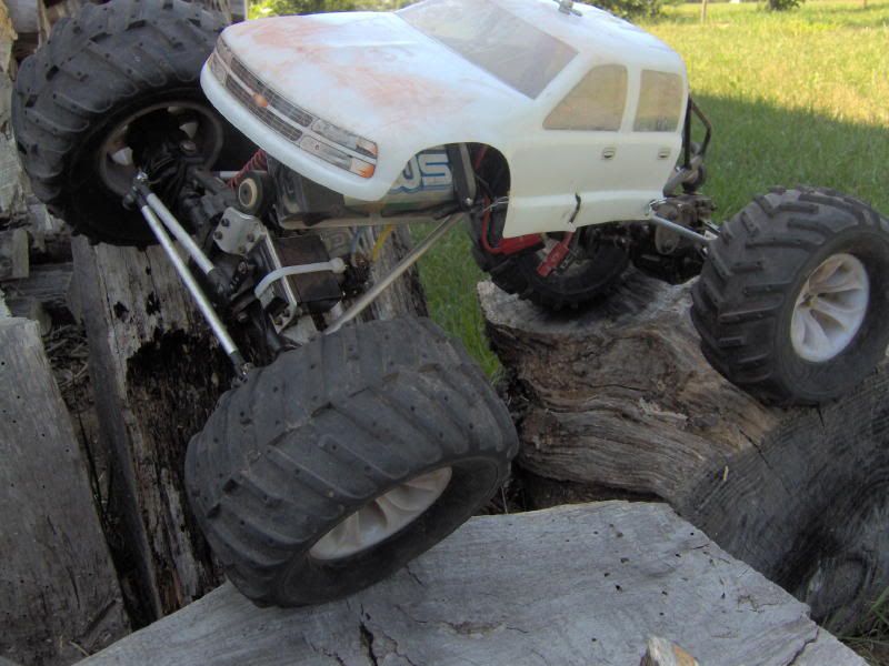

EDIT:
Found a really old pic of my previous thin metal mount. At least it shows the zip tie better.
