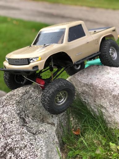

Just to post up an experience with these Desert Lizard shocks. I'm running 110/110 fr/rr on my 110 (no pun intended). I posted my setup in a previous post but now have some trail time with it.
My rig has wheel weights, an ARB style front bumper with winch, roof rack(stock), and spare tire (as would be stock). On the stock suspension, I had a baseline and it crawled well, climbed well, and sidehilled well.
With the suspension as noted, it definitely unloaded quicker and tipped over. This was very apparent with the side hilling and climbing.
So, off to the modification table I went. I got rid of the roof rack and spare tire/carrier combo off the back. I got rid of the uprights on the ARB Bumper and ziptied a thin piece of metal between the frame horns to add a little weight down low.
It now sidehills almost as good as it did before. It climbs the steeper climbs very well.
It's maybe 95% as good as it was before on these things but the flex and climbing ability is way cooler now. It definitely "shows off" and makes the harder crawling easier. The 9t pinion seems to help.
If I could go back again, I'd fill it with a heavier weight shock oil as that might help keep it from unloading. Maybe that's the next "saga" of the build along with a different set of springs.
