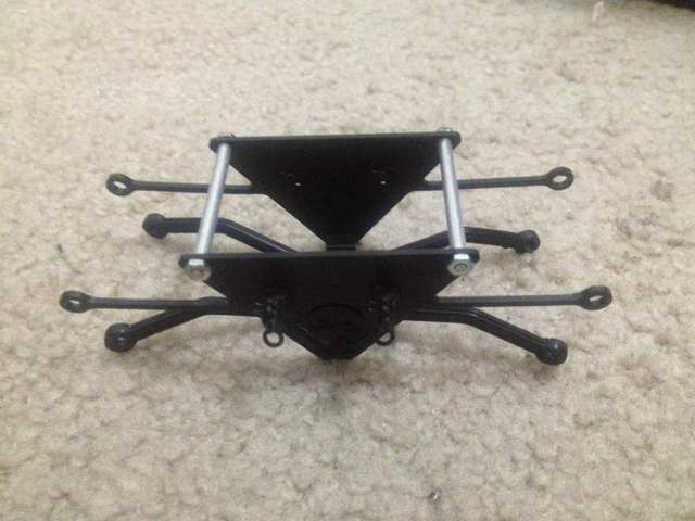

I wasn't happy with the amount of flex the blade TMC chassis had so I fabed up so aluminum supports to make it a little stronger

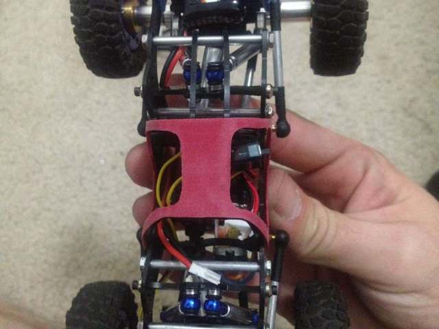

It's still in design phase but I think it'll make it look pretty cool and possible strengthen the cabin supports. I still have to come up with something clever for the hood and trunk. Any suggestions? Also does anybody know of a good glue to bond painted lexan to delrin?

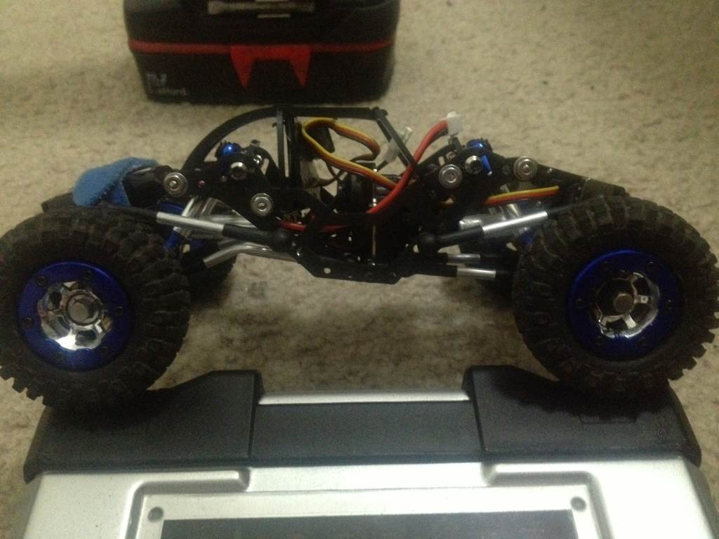

Here are some pics taken after the first run:
This thing crawls great. I love it. It's not done though. I still have to add some weight to the axles. My HR Shocks are still to tight. The wheels will drop one at a time but not the whole axle. So going over a ledge it still gets hung up on the chassis and stuck.

Holy crap that got a lot of stuff mounted to the axles !!! I bet it will crawl well tho! Nice set up. Do a video when u get it all done :)
Will do. Btw, these wheels and motor are awesome. So much friggin torque! On the tranny I only have a slight rub in reverse. Forward is perfect. Great products D! The TMC chassis is awesome too! As heavy as this rig is now I had to beef up the frame a little and make it my own, but it's still awesome. Great products guys. Now if only my HR shocks would perform better...
you know I just looked at the picture of the shocks and the angles...I don't think they will really drop well anyways. When both are angled in like that they don't like to pull straight down at the same time. Just an observation...not positive.
