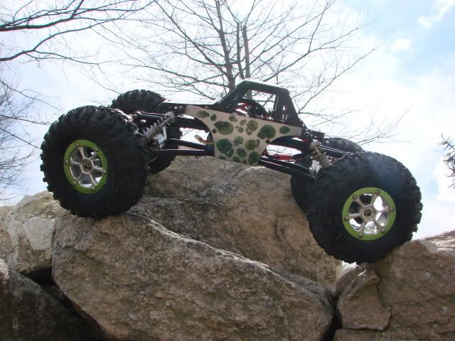

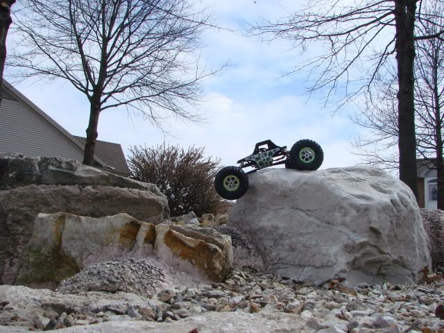

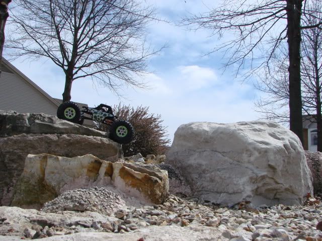

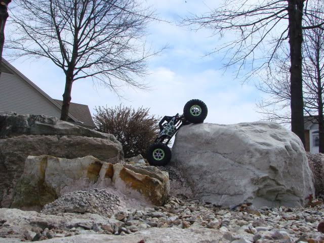

I've been runnin' the Comp Claws for about a week or so....
My 2 cents, for what its worth"thumbsup"
Specs:
Total rig weight 7lbs 2ozs
Fronts 13.5ozs ea.
Rears 10 ozs ea.

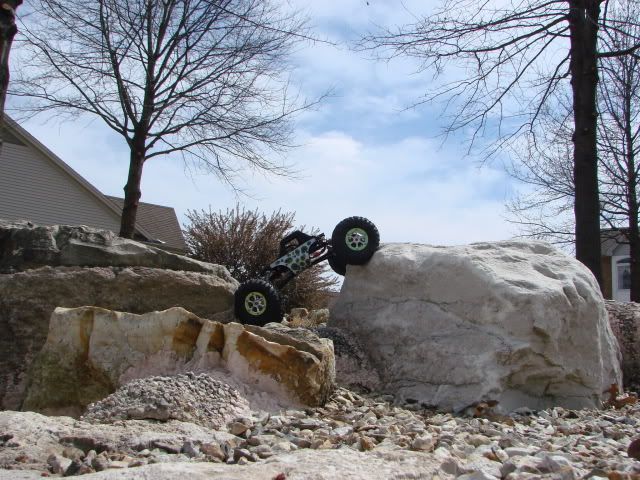

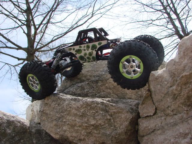

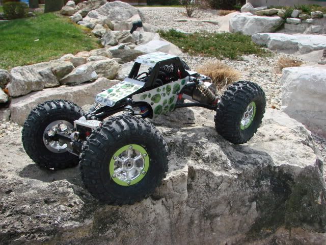

First off, like what's been said already... Stock foams WAY SOFT:-(
For a starting point I set-up the stock memory foams. The tires hooked well, but wadded under load, and rolled under on the slightest sidehills. On a 57 degree day too.
Next up NWTT all weather Reaches.
Much better;-), tires still wadding a little on steep climbs/undercuts. Side hilling is still sub-par as well.
So I decided to stuff the f*ck out of em'

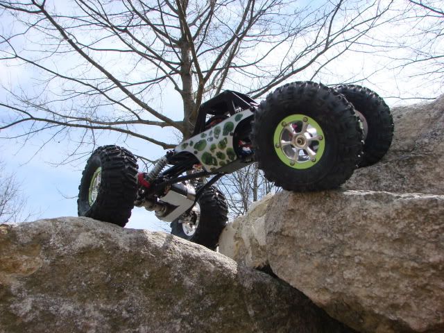

Put in HB Rover foams with a 1/4" thick, 2'' wide strip of low density foam wrapped around the outside.
BOOYA"thumbsup" The Comp Claws like it Hard:shock::lol:
After firming up these tires, they've come ALIVE !!
Hookin' like... dare I say it.... Cougars:shock:
And they sidehill like a MOFO"thumbsup"
The siped lugs really help hold a line.
All in all another good tire to add to your arsenal.
I like the 5.2" height. After running Rovers and Chisels, I feel the extra 1/4'' of GC isn't worth the 1/4'' rise in my COG;-)
Switching from Rovers, I have'nt noticed the lower GC at all"thumbsup"
Plus my rig feels more "planted" in steep ascents/descents & sidehills.
I'm gonna try some Crwler1 Memorys in various flavors as soon as the weather warms up.
Results to come"thumbsup"

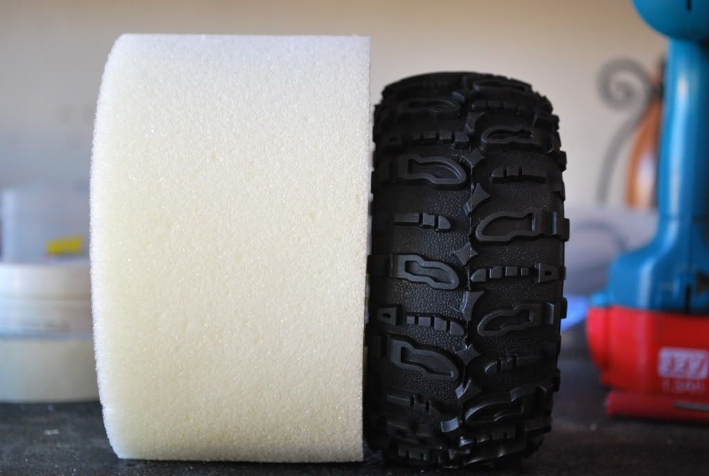

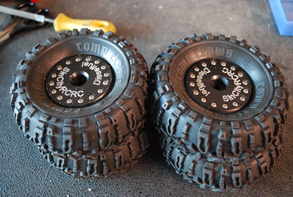

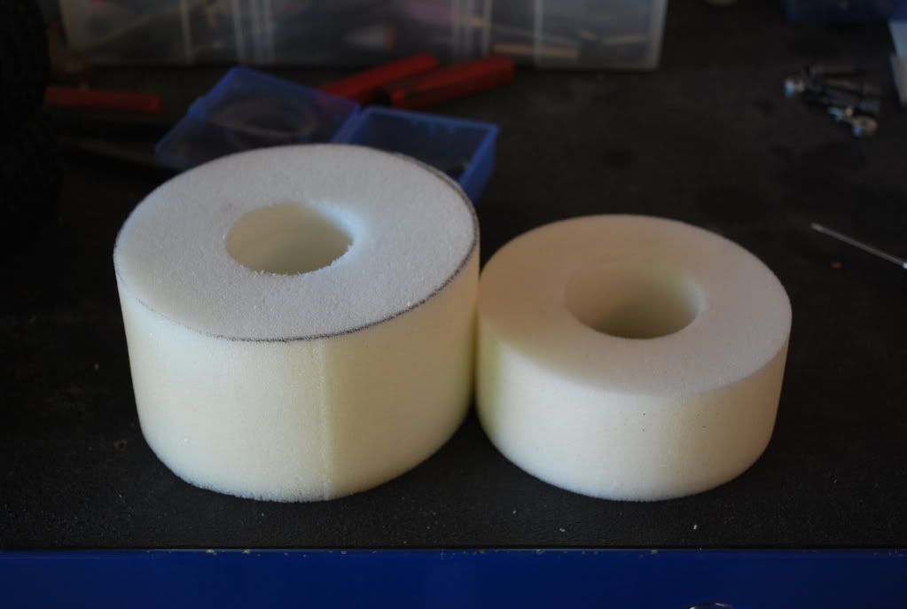

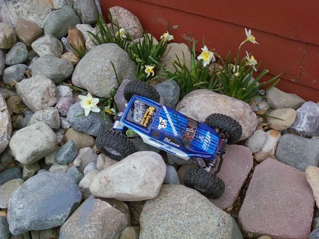

ive got mine stuffed with a new set of 5.5x3" Aced Donuts. i don't run anything else. i just got the losi comp claws today and only have about 10min on them. they're pretty stiff right now but they'll soften up a little over time. the aces are not quite as dense as the stock foam, but being so much larger they fill them out well.
mounted/unmounted
aces/stock
crammed in there
sexy

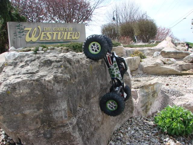

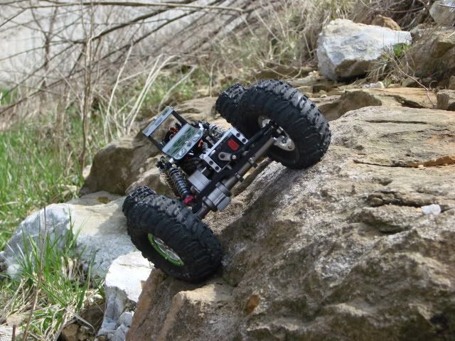

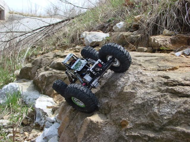

Another comp under the belt and these tires are getting even better! I think they are finally borken in. I don't think it took too long to get the best performance out of them but the are awesome now. I was making Berg lines with the Ol shafty yesterday and was very impressed.
Guys, the NWTT Hybrid reaches fill these tires out perfectly. They ran great and had great sidewall stability as well. Stock Carver foams in the rears still. I am not changing a thing for these tires setup wise.
I didn't get any pics cause I can't while driving but Todd (Rogue) did. Hope he doesn't mind me borrowing them. ;-)
