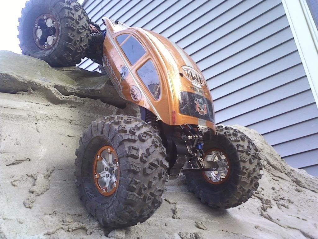

heres some pics i took a while ago and forgot to post them. im running proline oversized memory up front with pl 2 stage memory in back. they had some insane grip but i would switch to pl 2 stage up front because once you get sidehilling they just fold right under. might even try some pl oversized memory with 1/4 inch stock axial foam on each side to give it that support it needs.
heres my favorite picture of them. you can see what i was saying about having some insane forward grip

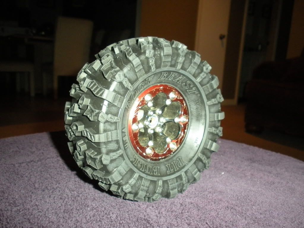

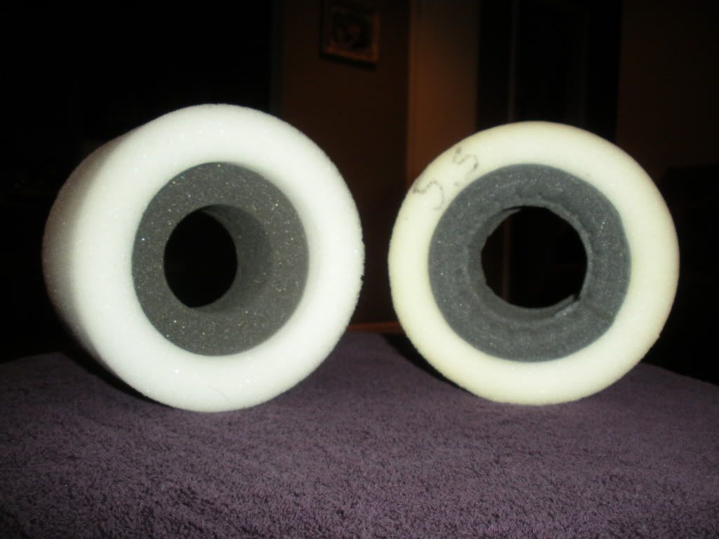

well ive been running the Dos Piezas 2 stage foams for a few months now,,during my testing ive been able to find out what these tires are really capable of...Mike and the gang at Pit Bull really came up with an awesome answer to the foam issues for the ROCK BEASTS,,,they are a huge foam,,but paired perfectly for the stout ROCK BEAST,,the outer ring is a soft non memory foam cnc cut for no seams,,and a medium to medium firm inner ring also cnc cut,,,
now in the past ive had very good to great success with Eddies nova foams in various combinations of the DD foam from 5 to 5.5 in combos as suggested by Eddie him self as well as my own ideas,,,but there was always some thing ,,the tires were either over stuffed,,or not filled enough,,the taller stiffer foams worked for me but were bouncy until really broken in,,the shorter foams just didnt seem to fill the tires enough,,,even while having good results on the rocks,,they just seemed like the tires needed more..
I feel the brand specific foam was the answer for the questions of what to use,,these foams really fill the tire properly in my opinion,,and the combo of density's between the 2 rings i feel are matched really well for the full potential of the tires on my rig,,my rig itself is husky at best comin in over 6 lbs at full running weight..these foams support my rig in any and all situations,,ive been able to drive with more confidence that my rig will do what i want it to when i want it too,,and my scores have shown it lately...onto the pics,,,

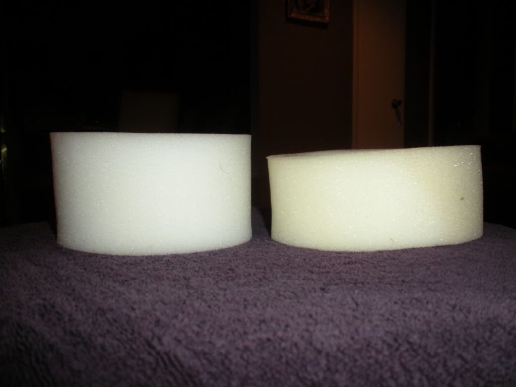

for size comparison only i have the Dos Piezas on left and Novas DD 5.5 on right
