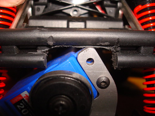

Over the axle servo.... and of course, a Dremel is your best friend (also, the servo saver of the WK sucks!)

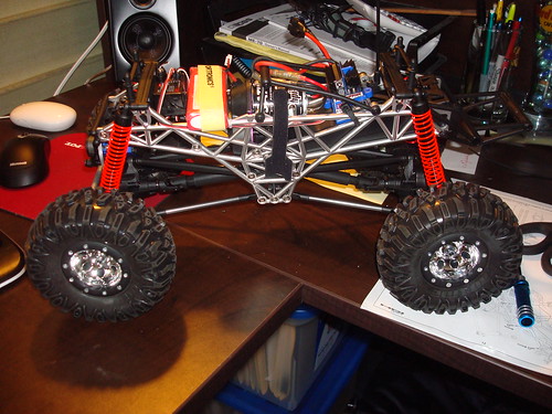

Finally, you can see the battery location for crawling, the 2S lipo lets me have plenty of torque and power...a 3S would be great, but the xl-5 esc will not handle that voltage. If I am going in reverse in a small incline, I can hit forward and the WK will wheely, not a full "I need the wheely bar" wheely, but enough to impress people and have fun. With a 7 cell nihm in the stock location, it is a "I am vertical" wheely!
