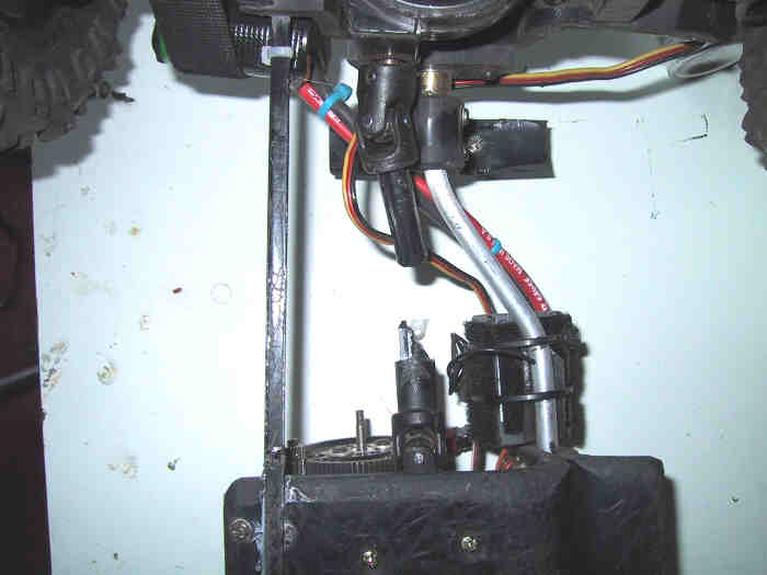

gotta love that revolver power LOL just blew apart a tmaxx drive line when the front was bound up........I MEAN IT EXPLODED! a big POP and shattered into many pieces.
notes: use only kevlar or Kimbrough spurs.......the rest dont hold up
