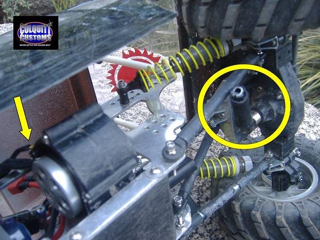

Cloak got hung up and couldn't keep his sausage off the trigger.Snapped the shaft and the motor kept going.I'd buy one now.Nice product John.
BL-owned!
It sounded bad too. Floyd tells me it looks like I took a saw to it how it snapped so cleanly.
