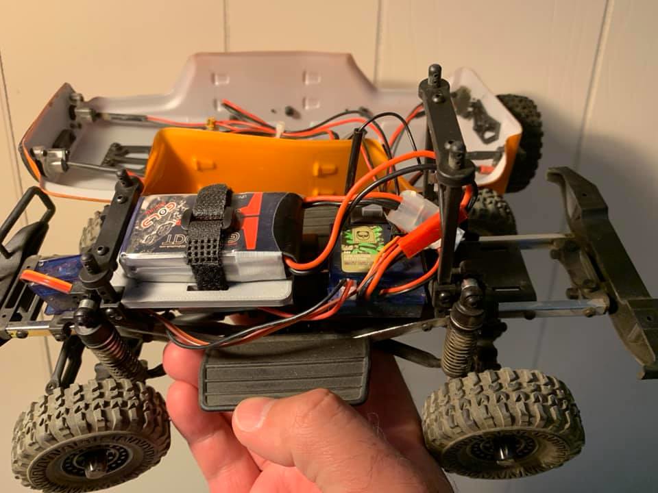

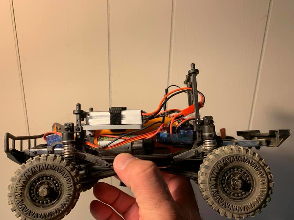

Would you be willing to share the design and/or sell some of those trays? I would love to move the battery to the front.
And I am also watching Amain and Amazon closely, hoping they start stocking a full range of parts and hop ups. I'm still waiting for a motor and set of shocks (really just need the spring cup, but can't find anything like it) to arrive from China for one of our Tetras, and my son took a tumble and broke a lower link and bent an axle... all parts not yet in stock stateside.
Send me a PM and we'll see what we can work out.
Glad you could use them!
Where did you get your little velcro strap? It's the perfect size.
That’s the stock one off the rear tray. It’s a tight squeeze with the thicker battery and thicker tray, but enough to hold the battery in place.
