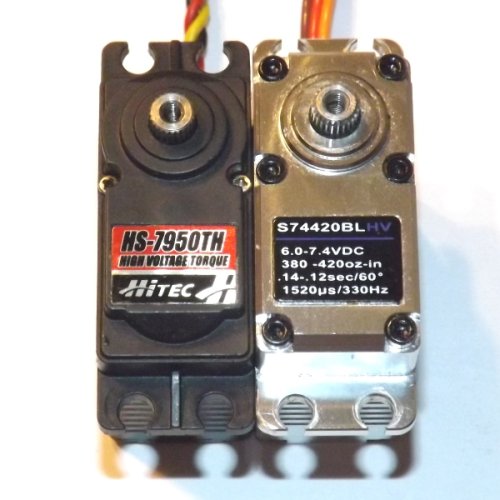

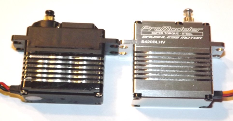

They seem pretty similar as far as size. Could you post a pic showing the difference in height from the mounting points to the output, please? Maybe spin them around from the way that one is taken, so the outputs are near each other, and from an angle that doesn't hide the topside, if possible. It looks like a few mm taller than the 7950 up there, I'm hoping this will fit without raising the servo arm up too high...

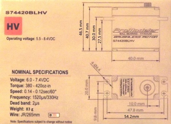

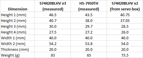

While checking the sizes I found something rather important - the dimensions on the packaging must be for the v2 servo and have not been updated for the v3, which is the one we are discussing.
EDIT - This is correct, I found the old post by Slayso that shows the v2 dimensions (which matches the current packaging) and the v3 dimensions are in inches.
Here is an image of the dimensions from the box updated with the actual measurements from the v3 using a digital caliper:
Here's a table comparing the v3, HS-7950TH, and v2 primary dimensions:

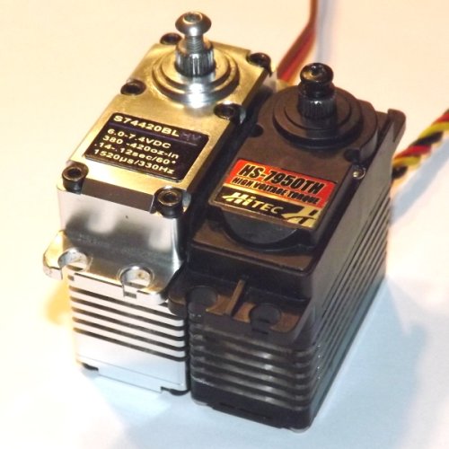

Thanks!
The output on the ProModeler protrudes 3.0mm farther than the HS-7950TH when mounted.

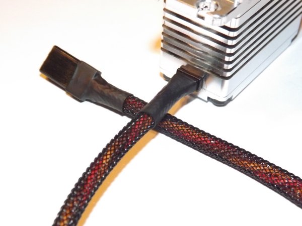

Back to the original reason for pulling my servo out tonight - to put on cable braid. I was inspired by this post from Heckler to use this stuff and it makes the wires look great, adds protection and makes them easier to route. "thumbsup"

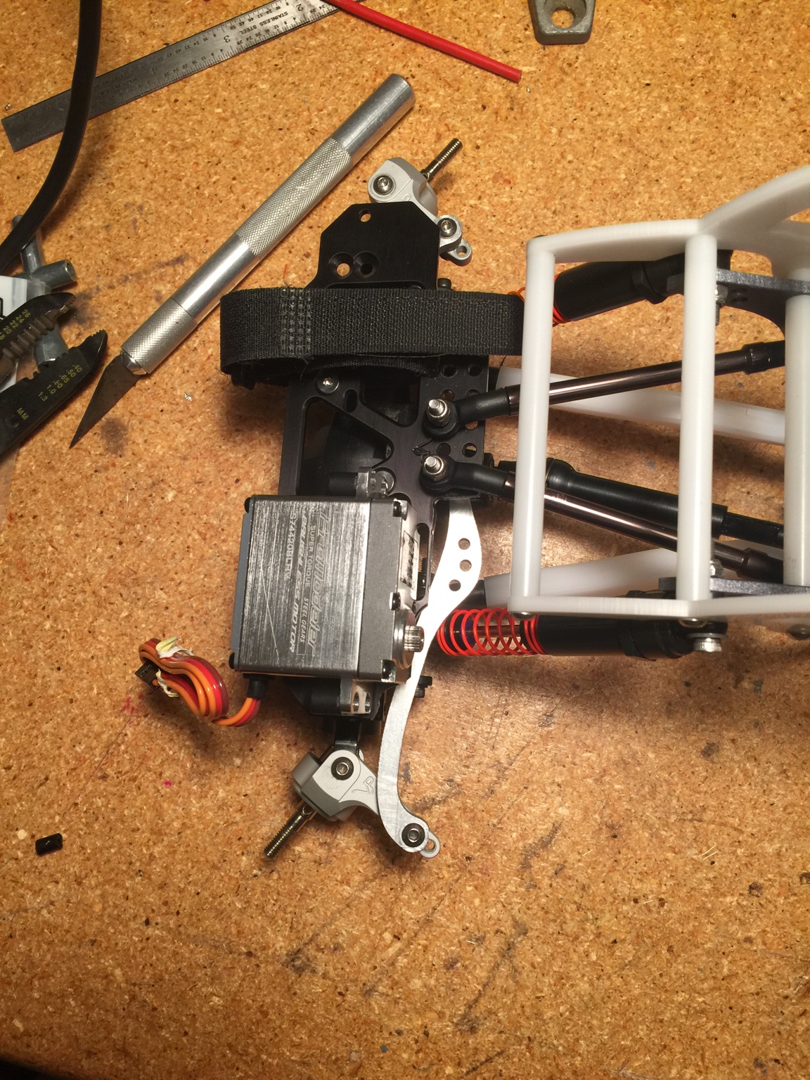

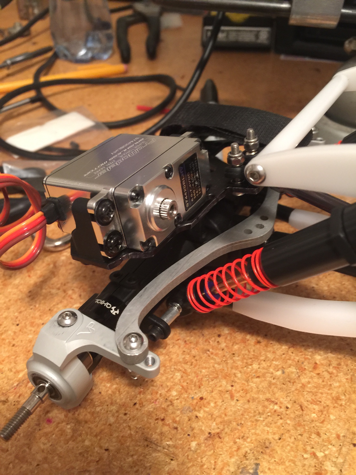

Which rig is that? Dope!
