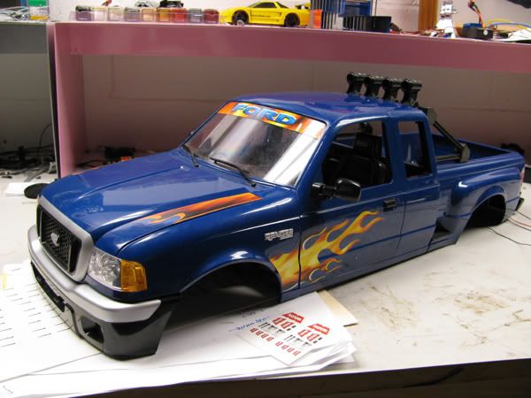

Trying to get as much of the front end design worked out on the computer as I can before wasting time on the work bench :D Scales out to be around 24" of travel which is slightly more than what they are getting out of these trucks with these kits but not too out of line.

Well the bed is cut off, pulled the headlights and grill and cut out the fake engine.
Started on the cab wall. After I got the piece cut out I realized that they painted the clear window blue to try and make it look like part of the cab wall. I'm going to redo it and cut that part off the window so the window is clear only and make the cab wall all one piece.
