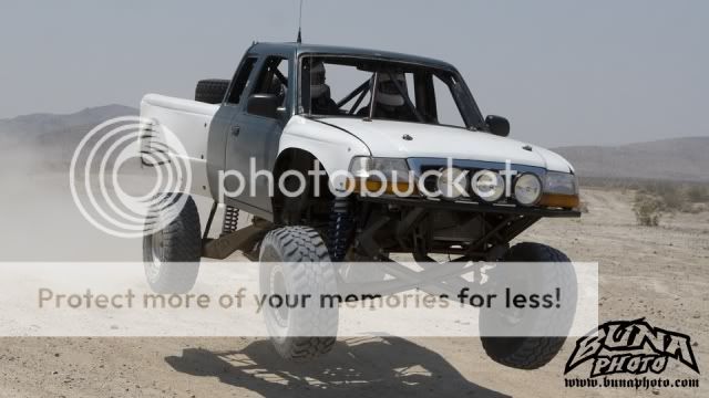

heres some inspiration
It does just not crazy aggressive. I think he was running like 3.5 to 4 inch bulge. I was that you posted up on dezert rangers, look in the updated pics thread theres enough in the to boogle the mind.
