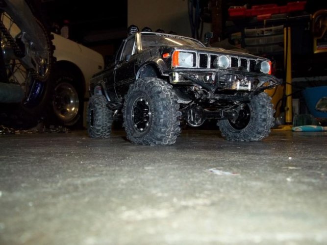

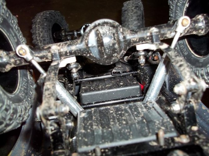

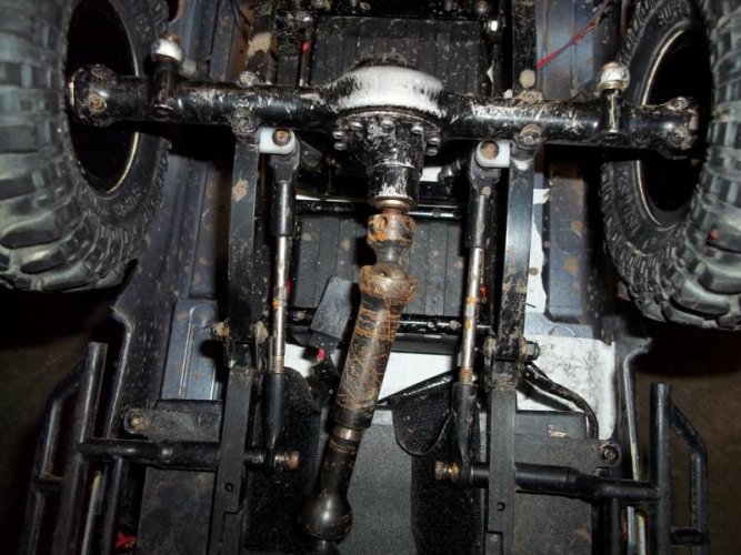

Looks like you have already got it sorted but heres mine anyway"thumbsup"

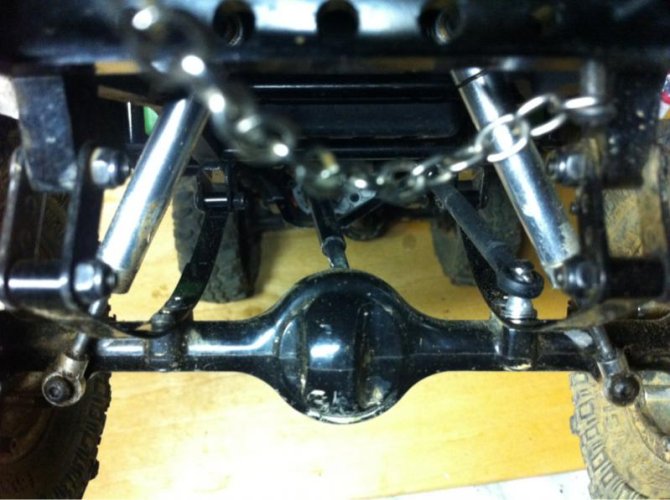

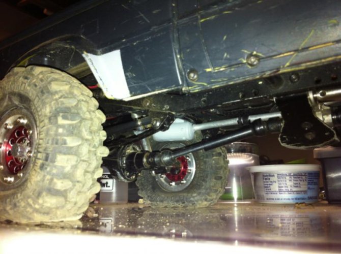

With the help of lunatic and his pics of his rear anti wrap bar I whipped up a rear anti wrap bar too. Tested it out on my rocks here and it's a vast improvement over stock wobbly rear leafs.

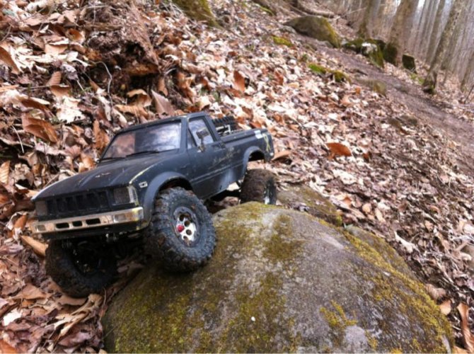

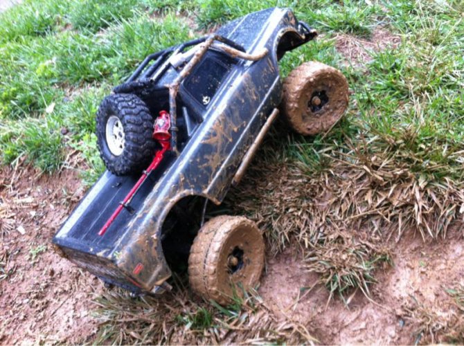

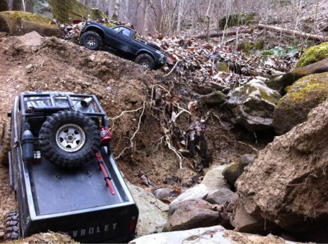

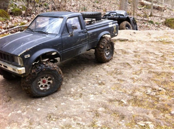

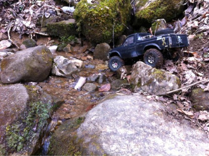

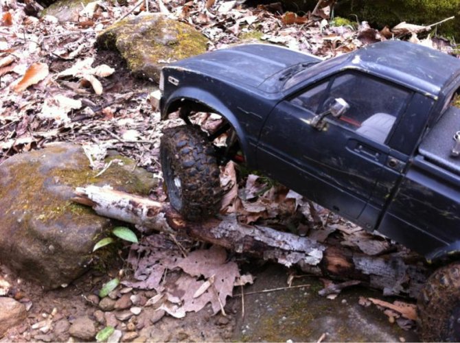

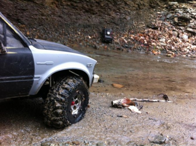

Had a good crawl today, hiked quite a bit, ran 4 batteries. Trailfinder did absolutely amazing and those anti wrap bars made it even better. I siliconed the electronics in the tf2 and I would call it "water resistant" lol and it did just fine, no issues what so ever. Did have a knuckle and steering screw come loose on the c-10, easy trail fix. Here's some pics!

Your exactly right. It makes you pick a realistic line rather than the near impossible ones that a modded scx10 can destroy! It's why I like this rig so much more than I thought I would. It's definately more of a veteran crawler rig but its also really straight forward to assemble and can be enjoyed by beginners "thumbsup"

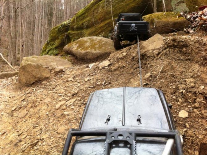

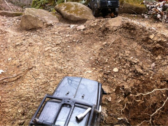

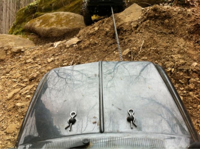

As you can see in the trail pics from yesterday, the c-10 got pulled out by the tf2! Lol :lmao:

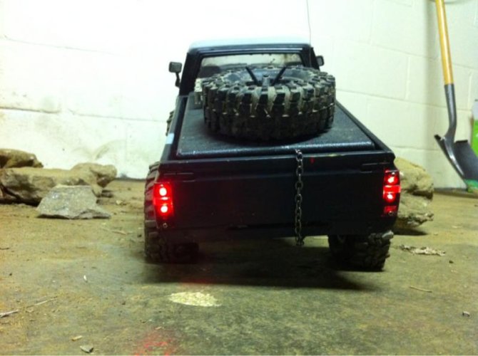

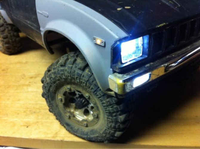

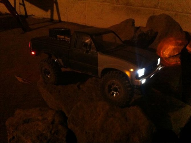

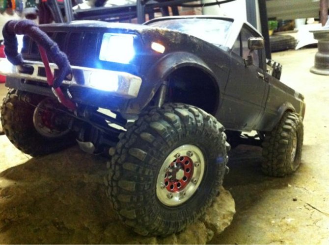

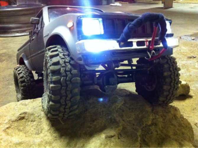

Update time! :) got a light kit and new leafs from rc4wd today. The leafs needed to be replaced and the helper soft springs added. I also covered the rear anti wrap bar in black vac tubing.
The light kit is absolutely fantastic and is completely plug and play. No fuss, no control unit to hide. And an extension cord with connector to unhook for body removal.
Snapped a few pics, here ya go!

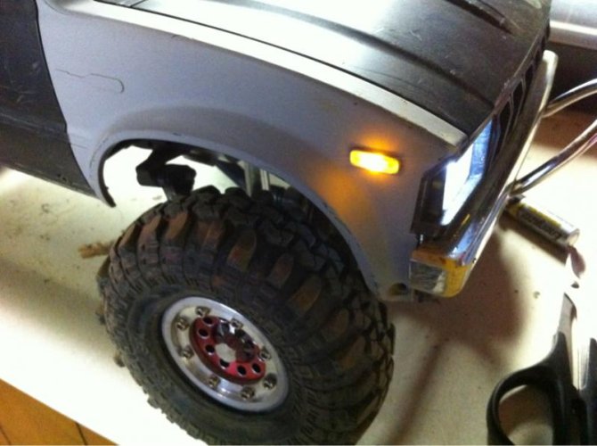

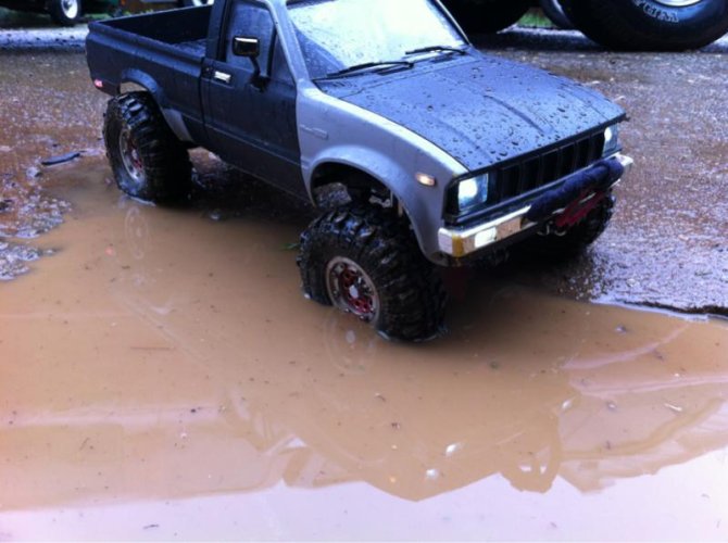

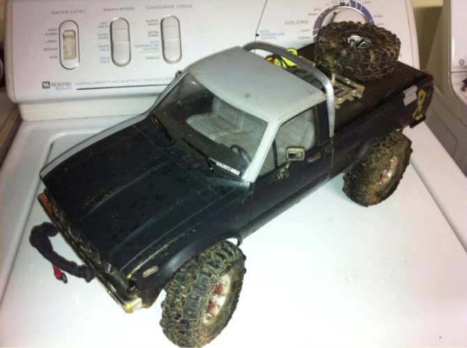

Made some changes to the tf2 today. Swapped some wheels to the tsl's. the 8 holes were getting worn. The new ones are metal and give it a slightly wider stance. It's a little more stable as well.

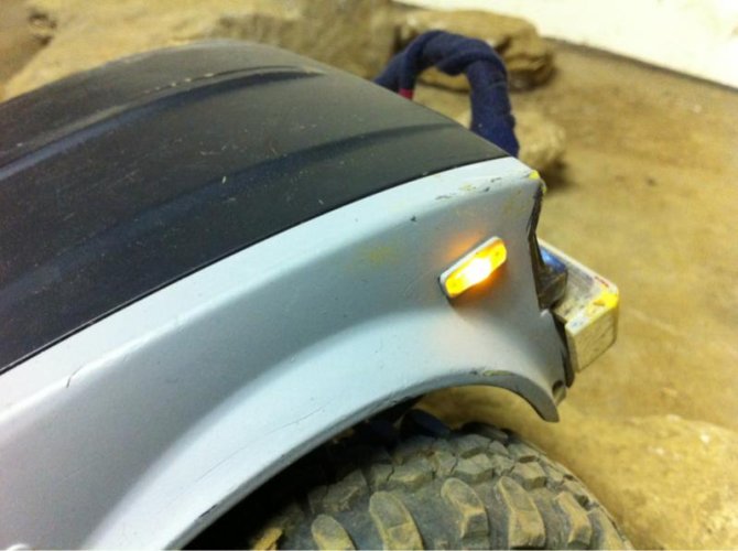

I fab'd some corner "lenses" from a clear coat spray can lid that had been scuffed and trimmed and glued to the fender. Free and missing lens problem solved!
While I was at it I fab'd up a "scale" exhaust system with a "muffler" too, also free! ;)
I've painted the roof to repair some scratches, done in primer as well. Also made a skid plate for the front diff to protect it from sharp objects, mainly rocks.

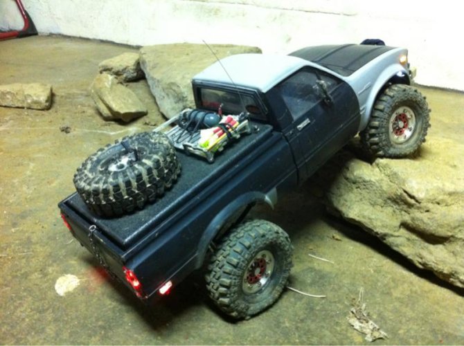

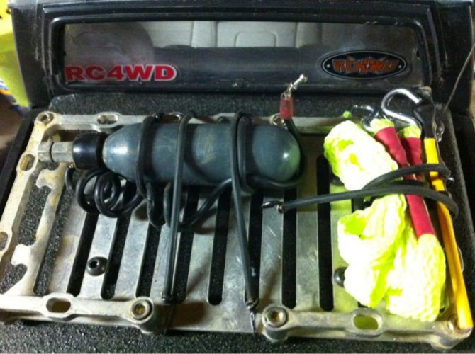

Cleaned up the rear rack and changed accessories around, including my home made c02 trail tank and the home made bungee cords too. Oh yea, the show string tow ropes with s-hooks too.
Here's some pics! Hope you guys like it and all comments appreciated! :)

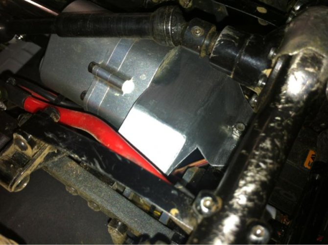

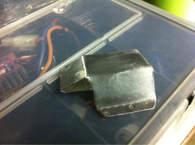

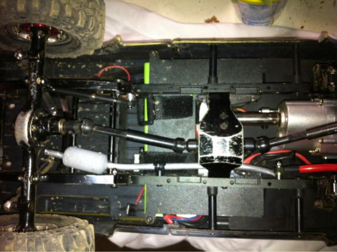

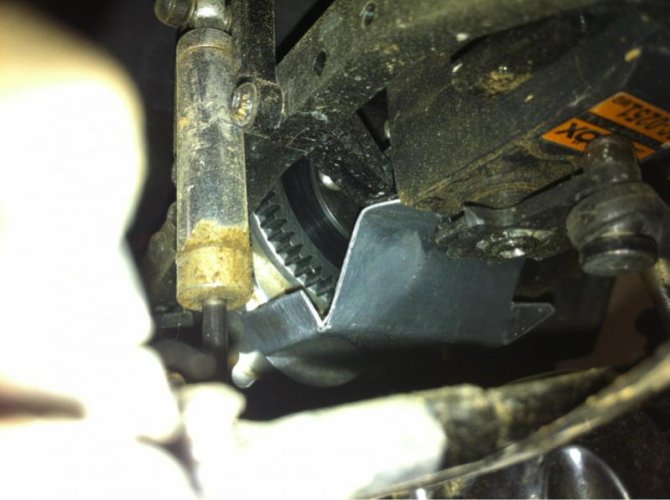

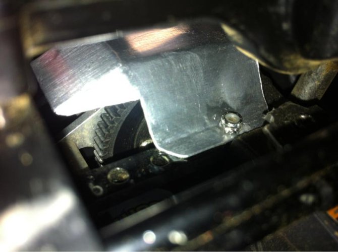

In addition I fab'd up a skid plate for the spur gear. On trail runs I'm always pulling leaves, twigs and crap out from under the chassis and I'm always in the back of my mind hoping that I don't get a twig or rock thrown up into the spur gear an ruining my day lol. So I came up with this. Used some thin cardboard to make a template and then transferred to some thin aluminum stock. Bent it to shape and scuffed with some scotchbrite. It mounts to an extra long steering servo screw on the servo mount with a locking nut holding it in place. The other half rests on the transmission and is very solid. No rattles and plenty of clearance. Here's some picture porn!!! Lol
Bloody good idea "thumbsup"
Never considered myself as a thief :shock:
But i,m gonna pinch your idea
Thanks bud! :) by all means, feel free to use this idea! I mind not the least bit! Glad I can come up with something useful for other people to use. I'm honestly surprised I haven't seen some sort of idea like this done before, may have been I'm not sure. I thought it was a great idea though and very cheap and easy!
Great idea indeed. Let us know if it really does keeping debris away from the spur.... Or collecting it all in between.
I'll keep you guys posted on success rate... I plan on going on a good trail run with a fellow member local to ky on Saturday. He just got his first tf2 after many scx10s and he's pumped lol... I'm ready to get out on the trails too.
I thought that it might be a catcher of debris rather than blocking it, but short runs have shown it to do pretty well against twigs and pine needles around my house and in my back yard course. If it does happen to catch a small rock I think it would have to be the size of a marble or smaller. to get up in between the spur and inside of the skid plate, there is only approx 3/8ths of an inch to get in from just one side. If it has a down fall I'd say it'll be that one perfectly sized rock to get in there. But for twigs and leaves, it's got them beat!! We shall see Saturday I guess.

The skid plate idea is doing just great so far(which is just trailing around the house) but I did remove the motor/trans and decided to disassemble the trans and grease it since it's been known to come with a q-tip sized dab of grease out of the box.. I can confirm that it was very little amount of grease for smooth operation. It worked but I could see some shift quality issues down the road if I didn't do this... So it's a win win, I KNOW there is proper amount of grease in all operating parts in this rig and that it was cleaned and maintained.
I did switch out my old shift servo to my rc4wd mg servo for shift duties, set the EPA's and dabbed some grease on the servo horn to protect from water intrusion. It works great for this duty and looks good too. I also water proofed everything I could think of, well I should say water resisted everything to as best as I could lol. I won't sink or submerge this truck.

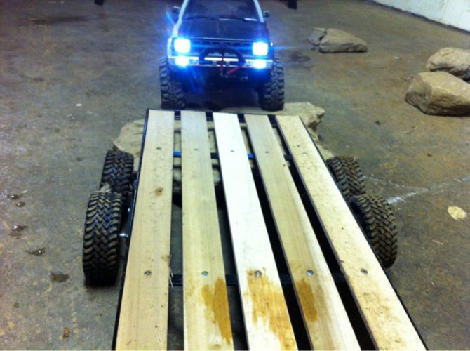

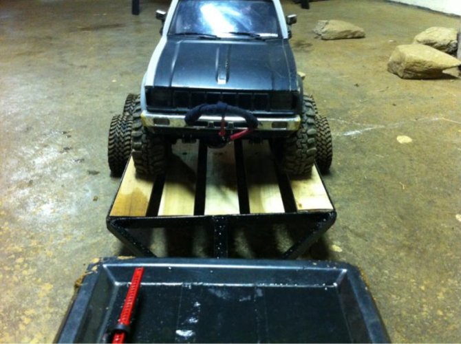

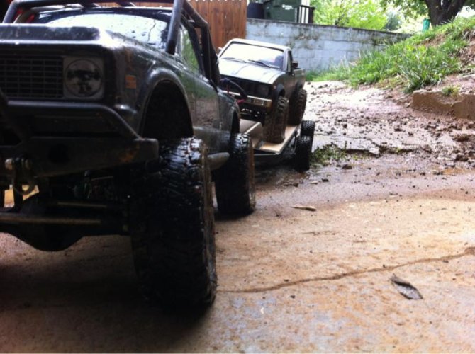

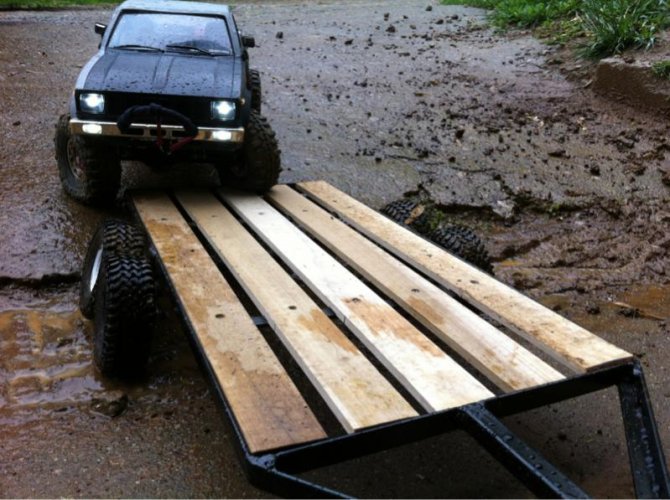

Then I did get some time to shoot some pics of my trailer I built, nothing fancy, functionality was kept in mind while cost was also a big factor, at work and with materials it didn't cost me but approx 35 bucks to build, plus the wheel/tires are stock 1.55 from a tf2 kit.
Anyways, enough gab... Here's some pictures. :)
