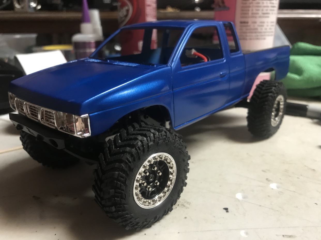

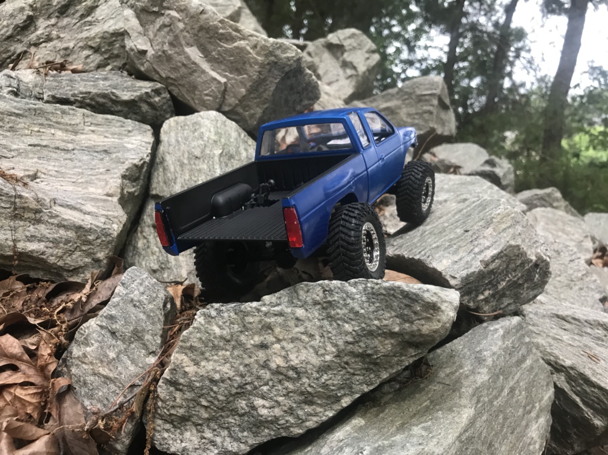

Starting this thread after it’s mostly built and didnt do to well taking pics while building but let’s get up to speed on where the truck is at now.
Originally didn’t know where this build was gonna go but the local hobby shop had other plans in mind so a new rig and new model kit later and here we are.
Made it home and the thing just exploded.

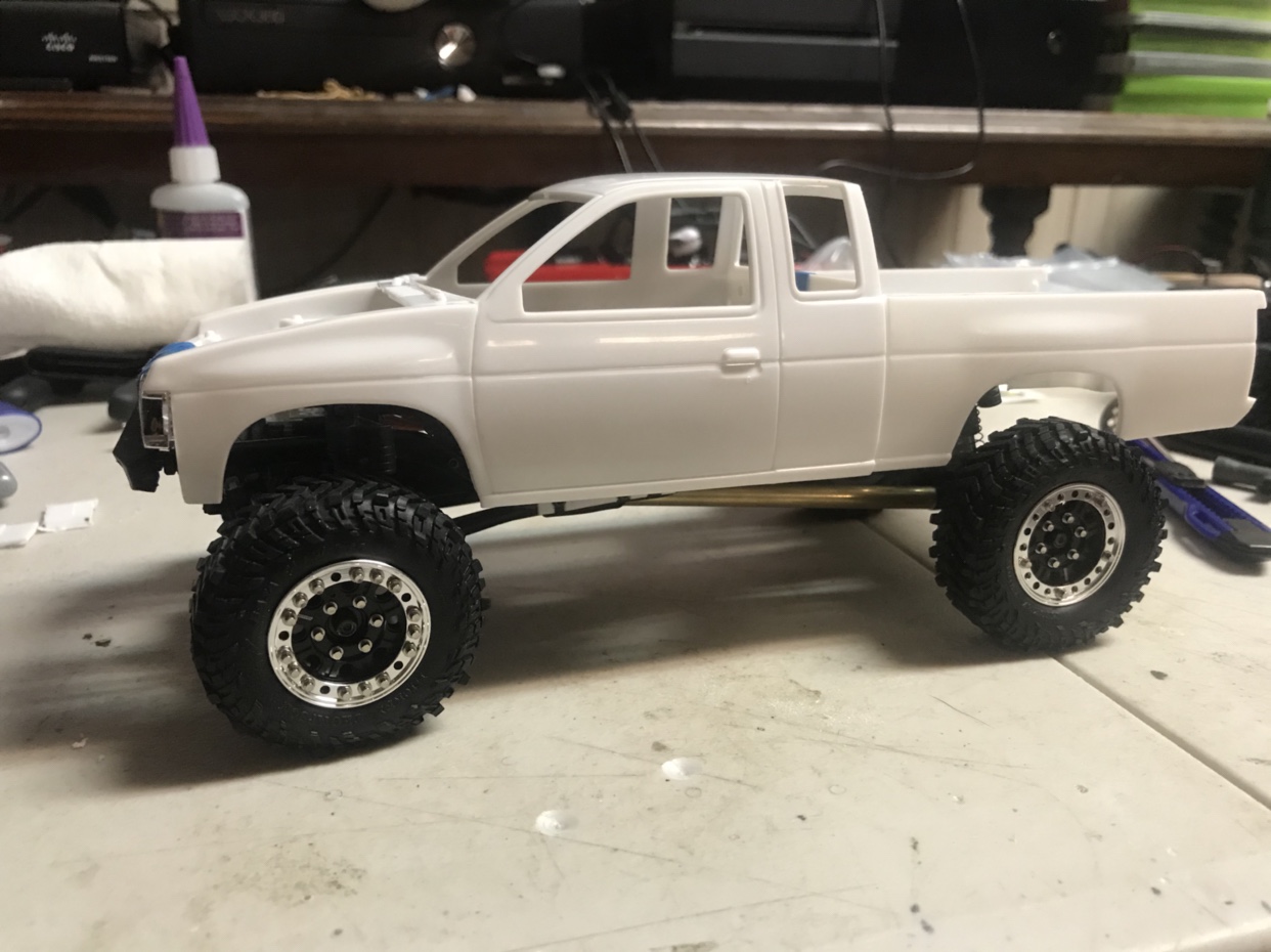

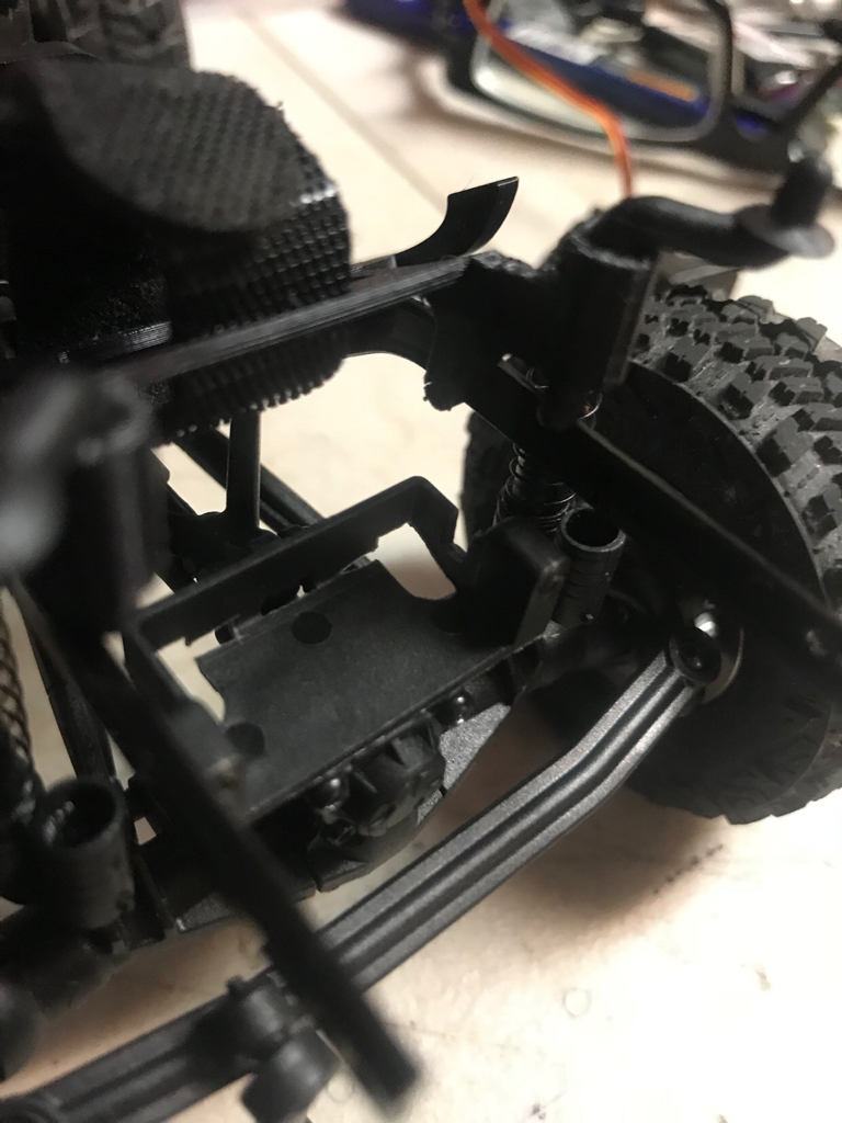

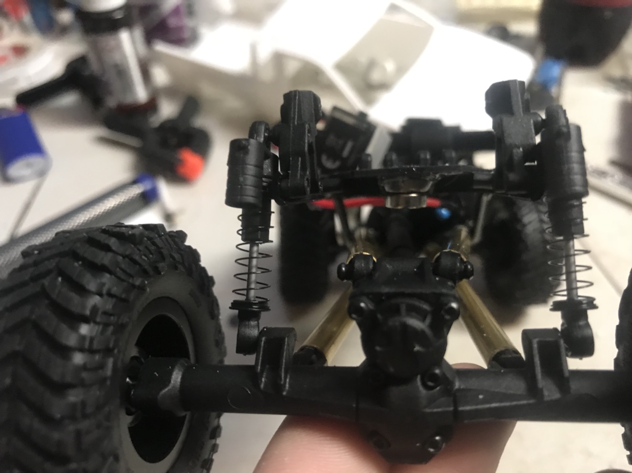

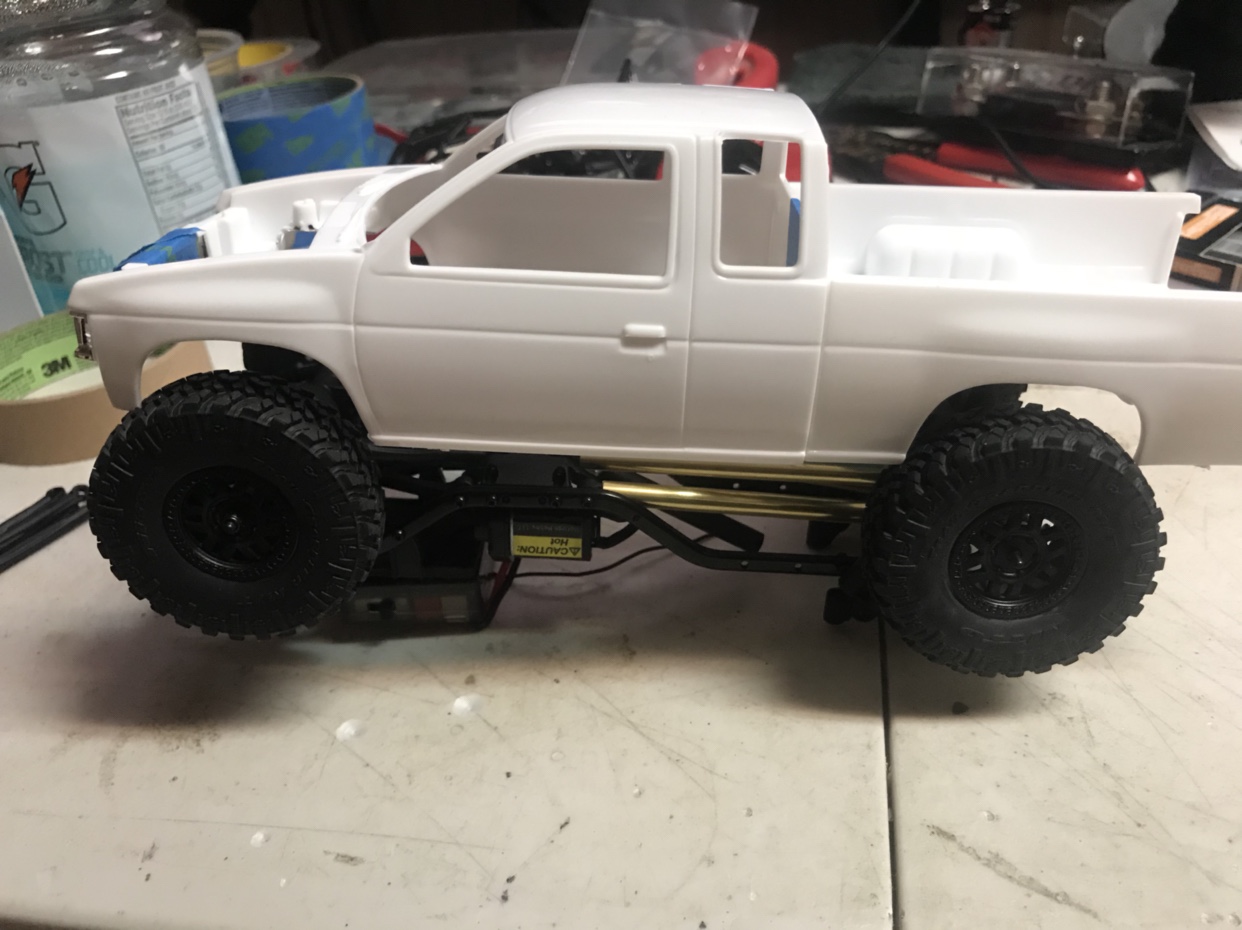

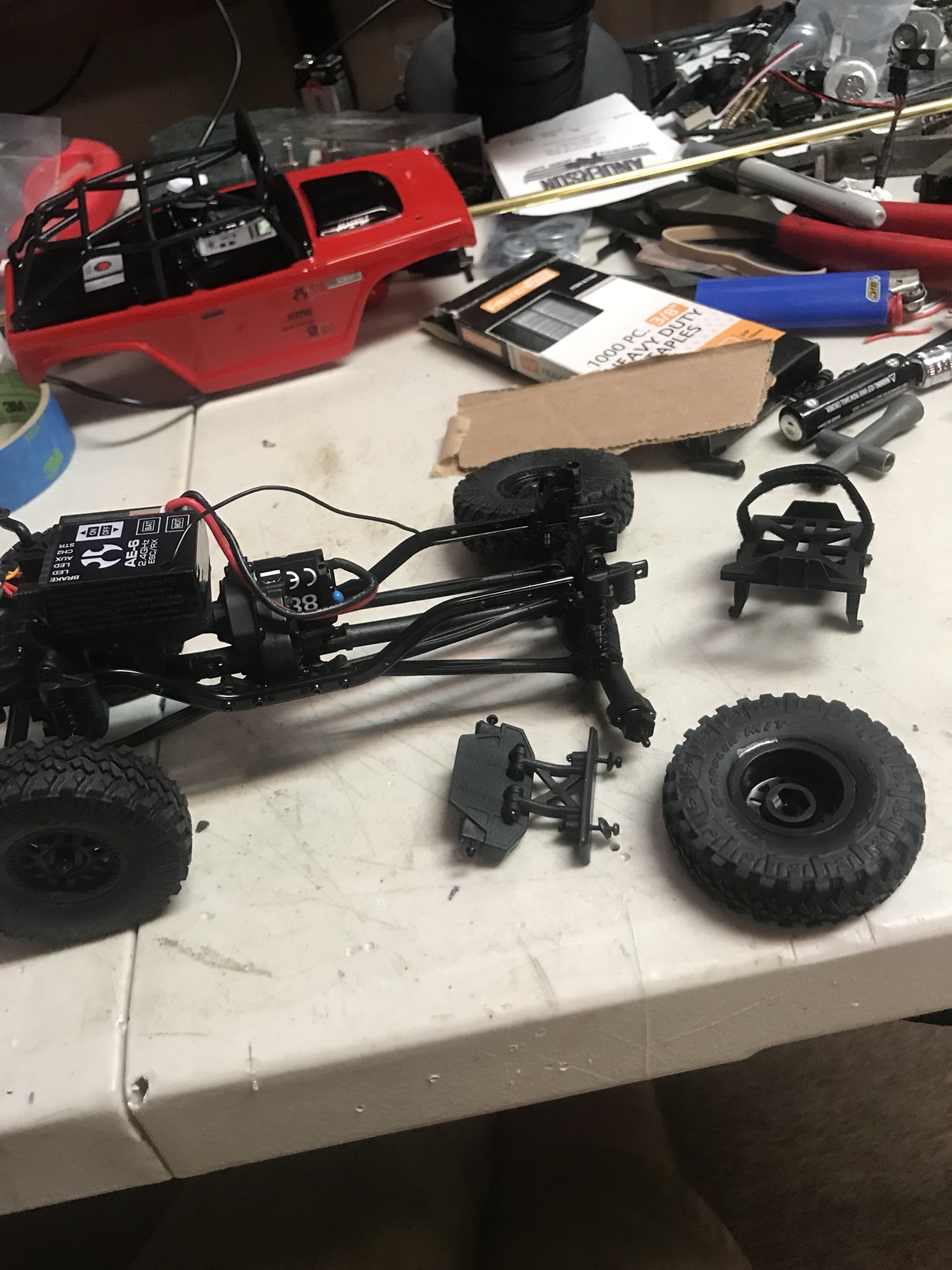

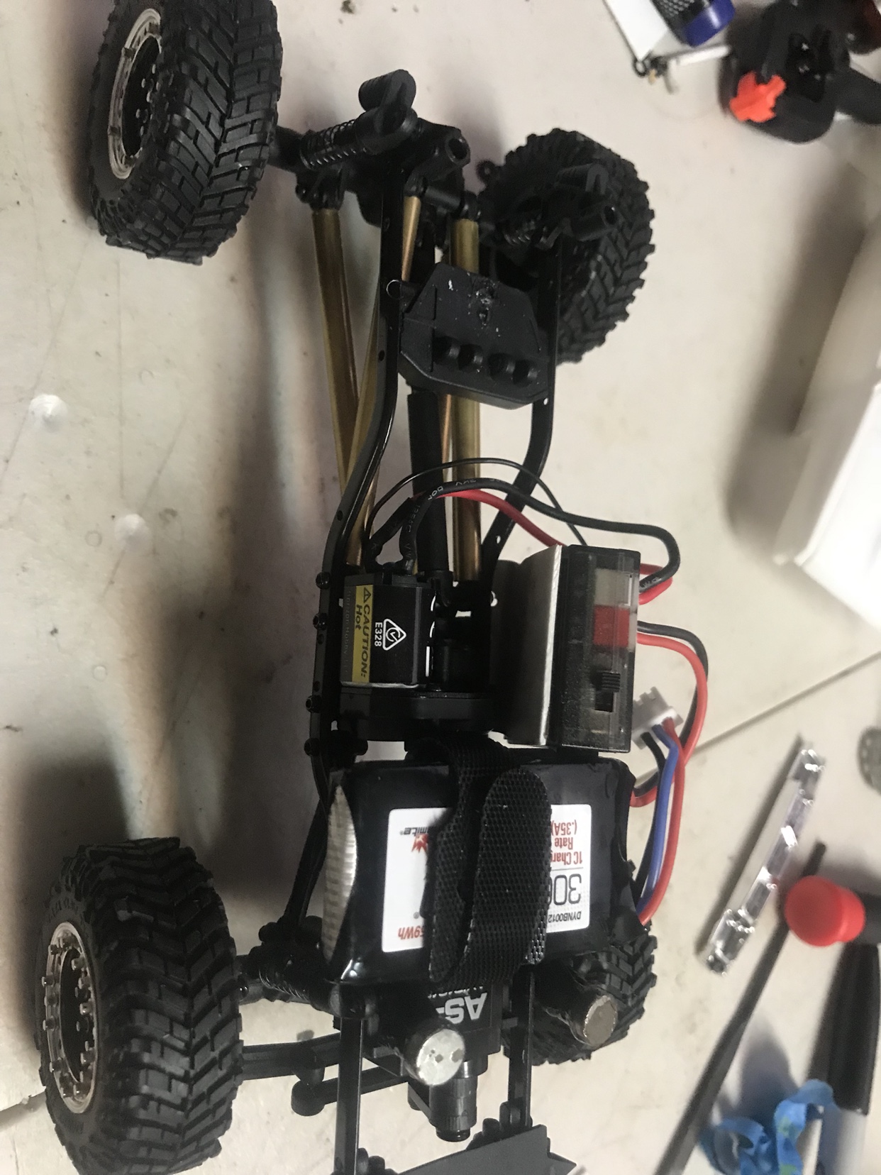

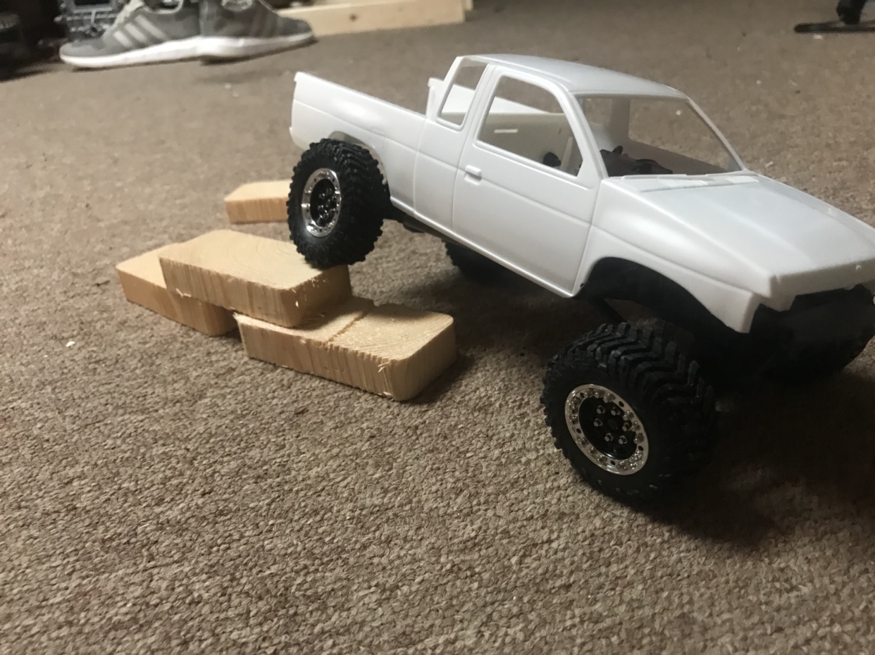

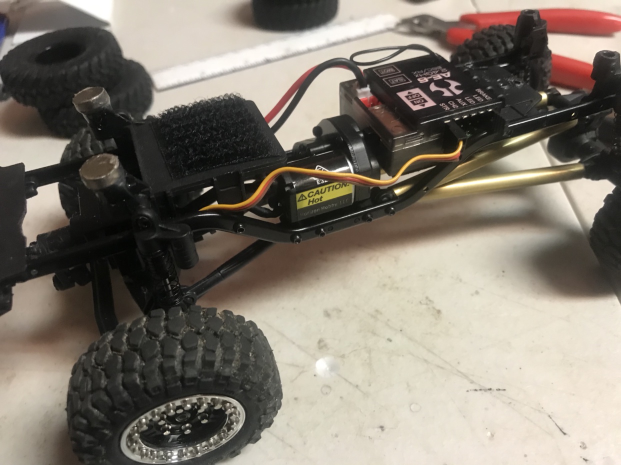

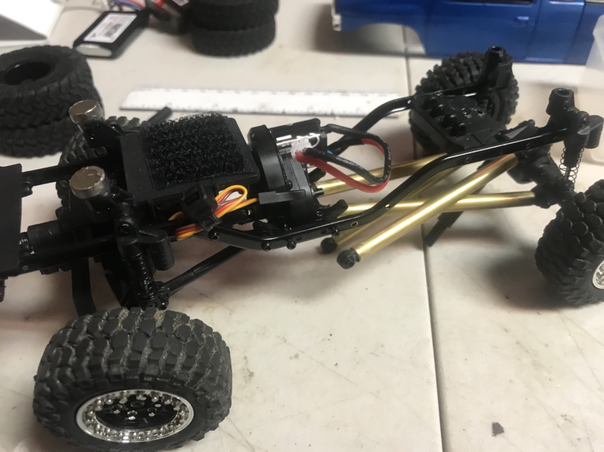

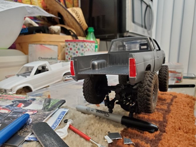

Welp minus well get the links made to extend the wheelbase. Took the factory links and chopped them in half and glued them in some brass tubing and bam it matches the body.
It’s about 5/8” longer than stock wheel base. The drive shaft was next on the list and couldn’t have been easier thanks to axial. Using the extra driveshaft half they included and a cut up make end and it’s a mini wildbore hd shaft.
