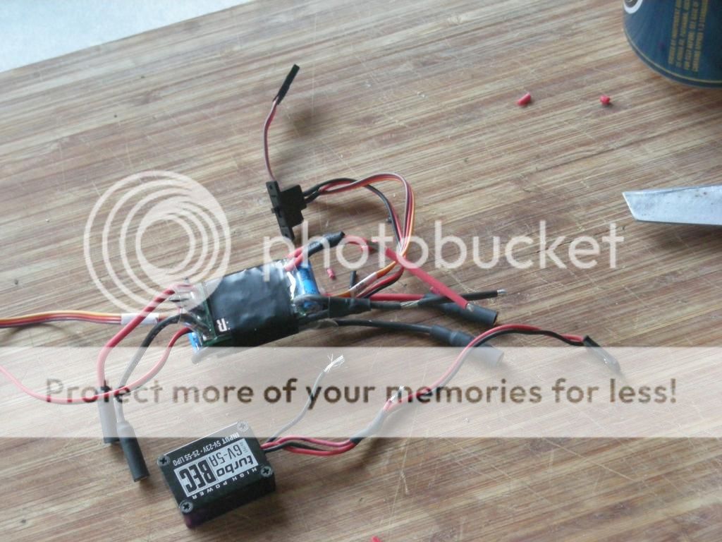

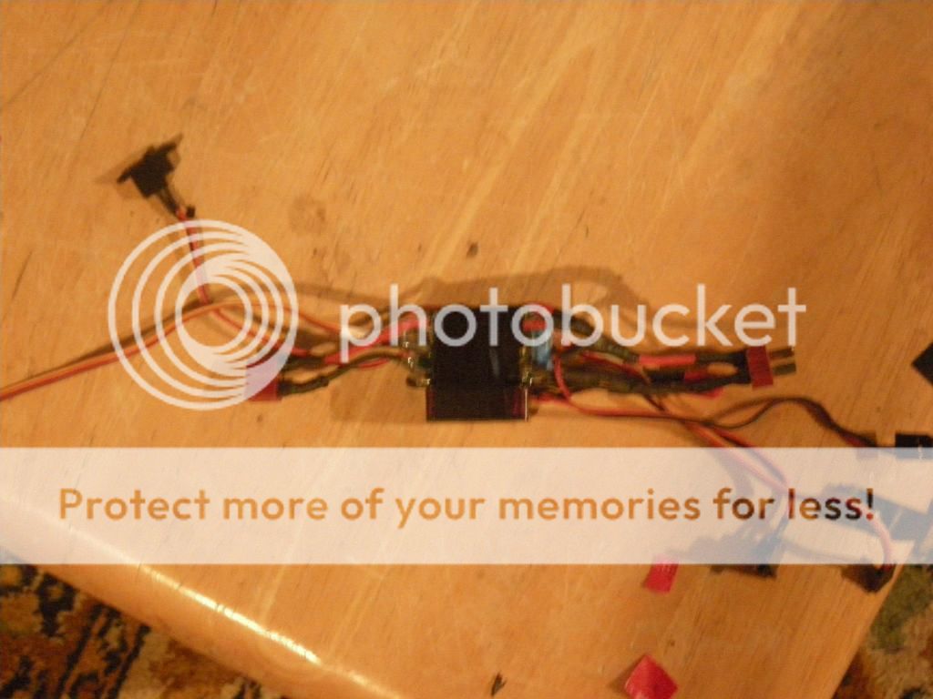

Im still running the original BEC that came with my bully way back...
Sounds like its the same one you have. None of the other electronics remain, but the BEC is still there, and my rig is no doubt heavier than yours.
with 2 x castle escs
Yes looks like exactally the same BEC. Interesting. How many years you neen running it now?
I never ran mine, swapped it out. Sat in a box, went to sell a dual servo crawler, needed a bec, that worked perfect, servo taped it to the hood
Imo the rc4wd BEC is to bulky. I'd use the castle creation BEC.
It is indeed bulky due to the plastic case. It can fit in the space I have though, so works for me.
There cant be much difference in weight though. Even the RC4WD BEC can only weigh a few grams.
Even if the CC is half the weight, it would only be a couple grams. There are IMO bigger fish to fry, bigger gains to be made elsewhere, especially if money is an issue.
Its not like its full of led.
Honestly, I would use the cc bec just for the fact your getting more ounces running higher volts. Why not use the rc4wd bec in your other project? Your going to want as much power as you can get in your bully.
I said volts, 6v vs 7.4v depending which bec is used. To get more out of that 7955, it should be ran at 7.4v. Rc4wd bec is only good for 6v.
