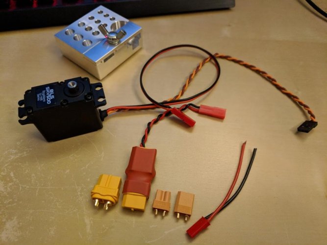

Are those as small as the JST's? I've never seen one in person
See the pic below, XT60 on the left, Gearhead RC XT60 w/JST powertap in the middle, a male/female pair of itty-bitty XT30s and then a wimpy JST on the right.
They are pretty small and will handle a lot more load than the JST connector.

I run the large XT90 on all my crawlers and road cars, I do have some XT60 for the plane and the XT 30 I use on small batteries, bec’s, and lighting.

I must have tossed the JST connectors I had, cannot find any to put side by side.
Anyways here are the ones I use... XT90, XT60 and XT30. Added a wheel nut and a dime for comparison.
Edit again: I usually get all mine on eBay in bags of either 5 or 10 m&f sets that way I always have extras for myself or anyone needing one.
XT30 10 sets $6.50 free shipping

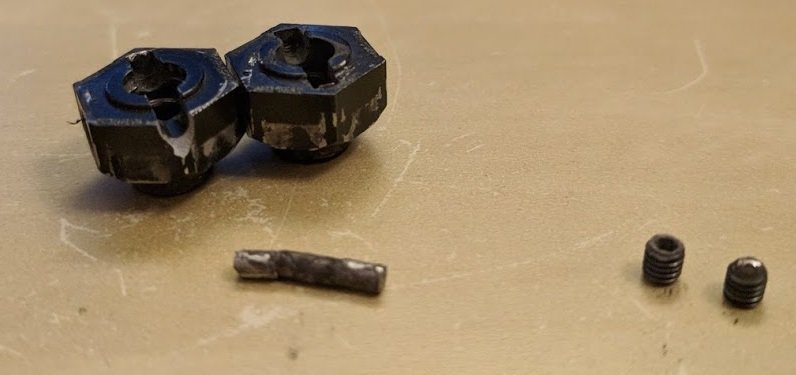

I did however, notice that my passenger rear wheel is no longer "driven", it's freewheeling.

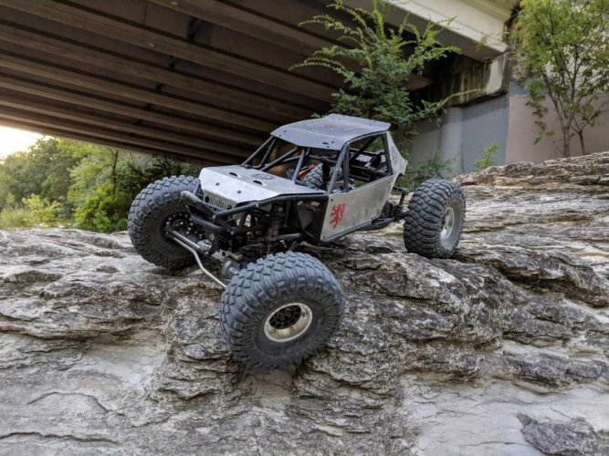

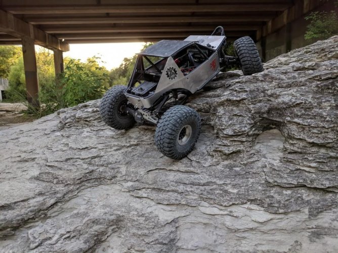

A Green Heron came within 6 feet of me and was just chillin' in the creekbed, and later I saw a little watersnake zig-zagging across the water... 8)
It was a perfect spot for low-key driving, in the shade of a bridge - because of the time of day the shady area was much larger than the last time I was there.
Couldn't really open it up, though.
Later on - after between 1.5-2.0 hours of slow-crawling (I'm pretty sure I nearly took the SMC 4300mAh to the low-voltage point - it was at 3.65 per cell and being put on storage charge now) I went to my apartment parking lot and switched to my cheapo Venom 3200mAh and did some flat-out running across the cut grass and was satisfied overall.
That's when I noticed the rear wheel not getting power...

It's still attached, and it free-spins on the axle.
Ah-Ha!
I just snapped a pin and broke part of the hex - no worries, a new pin and hex will fix that right up!
The cheapest and easiest fix I could have!
EDIT: Other axle had bent pin, gonna be proactive and change out both... "thumbsup"

Well, I tried to use Vanquish locking hexes, but try as I might I couldn't get the Gearhead wheels to slide over them.
Using LURC narrow hexes instead...

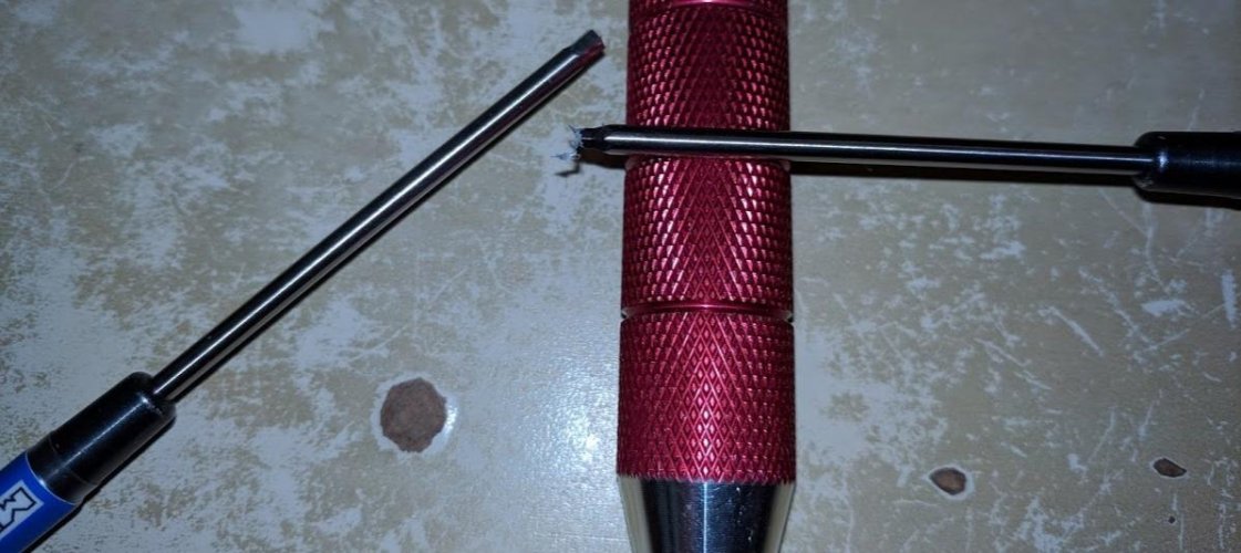

After previously breaking off the tip of a 1.5mm MIP hex driver, I now have done the very same thing to a MIP 2mm tip!:shock:
All I was doing was changing out a servo horn, not even bearing down hard - check out the flaking metal (the so-far-unbroken 2.5mm is there for scale):

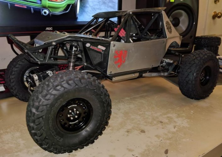

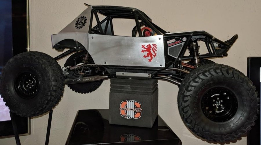

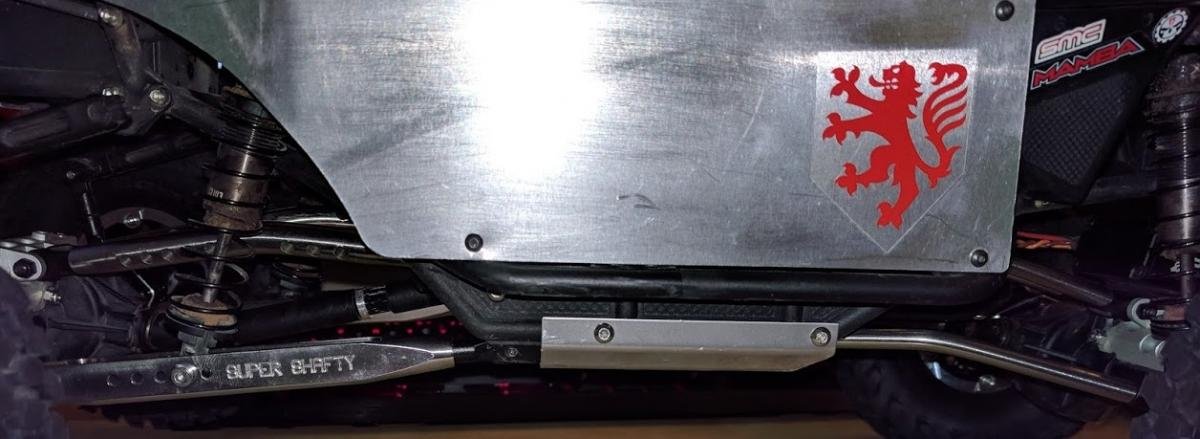

Decided to (at least temporarily) install all the JEC Racing stainless links as well as swap over to kit tires on Incision MR307 wheels with CI Double Deuce CompCut foams.
Once again I was reminded what an exquisite pain-in-the-ass Bombers are to work on... and mine requires removing rear and side body panels on top of the usual.
Troubles ensued because I hadn't noticed one and a half years ago that the links were accidentally shipped with extra upper front links in place of upper rear links...
I contacted them and it will be taken care of, but since I was so into it I wanted to finish for a crawl session later today - I made it work by swapping in some Jato rod-ends for some of the Revo ends.
Lots of trial and error, however!
At one point the rear driveshaft sliders were so compressed that after using up about a half inch of travel, the driveshaft was bottomed out - not good!
i now have it all worked out, full travel, no binding anywhere.
The rig is MUCH heavier than before, all that stainless replacing aluminum or titanium (steering was SSD ti, the rest was aluminum - everything is oversized SS now).
It's also lower to the ground because I've dropped from 6" tall tires to about 5.3", so it should handle pretty well.
We shall see!

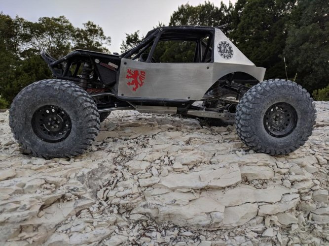

Yeah, I'm not a huge fan of the relatively limited access the Bomber presents. Glad you got straightened out.
You must have a French bomber like Jboucher with those Peugeot emblems on your side panels. ;-)
It's a lion from the coat of arms of the City of Braunschweig (aka Brunswick) in Germany, where many of my German relatives live.
I was given a sticker sheet ages ago and thought it looked really nifty....

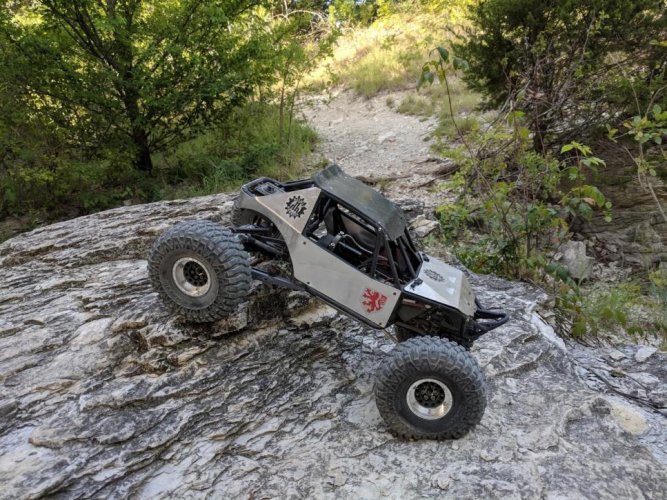

For now, here are some stills (I noticed the steering link was drooping after the head-on shot and fixed that):
