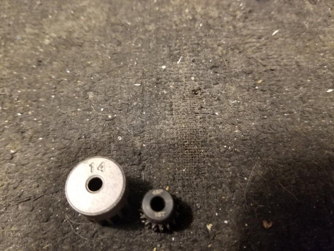

Pinion idler and spur are 32p, tranny internals have smaller teeth, could be 48 but personally just assembled it without comparing gears...
By the instruction sheet the stock 14t 32p pinion is AX30569, and by the Horizon site picture, that looks like the correct pinion, with large shank and M4 grub.
Maybe it's just a misprint on Horizon page 48vs32...
According to their info, spoken to me while on said phone call, the Capra's pinion is...48P.
That is incorrect. It is most definitely 32P.
Ok, so I just took apart my Capra. Visually, I am in complete agreement...it definitely looks like a 32P, not 48P. So, to be certain, I, measured the pinion diameter, and calculated the pitch myself...14T, with a 12.85mm diameter, comes out to 31.8P...or, rounding up, 32P. So, here's a more important question - Why is Axial/Horizon Hobby telling people it's 48P?

Here is the stock 32 pitch 14 tooth pinion next to a 48 pitch pinion with more teeth. Notice any difference?
