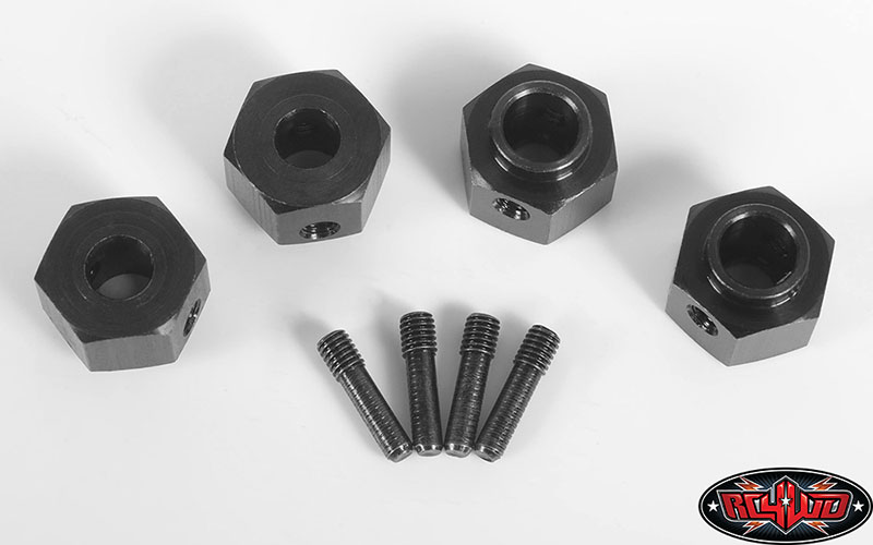

Got ssd hexes - what is up with the raised flange around the axle stub? I had to drill out my wheels to fit them on.

The ssd hexes are made specifically for their wheels. The raised lip fits into the center hole on their hubs for a tighter fit to limit slop around the axle shaft.

l have some ssd steelies...wonder if they would work better. It's surely a different setup, but can always use the stock hexes. I thought I was being smart getting beefier ones...now they don't work with the cheap-ass wheels. LOL

Nice, they should. If your other wheels are slw hub compatible you can also throw on the ssd wheel hubs themselves. The ones from your steel wheels should work, or there’s offset and brass options available.

Well, I did not realize there were various hexes and configurations for wheels - just thought all 1.9's were the same. Dear god.
So I got a set of alloy hexes from RC4WD and keep the stockers as backup. I guess the stock ones aren't very strong, made of unobtanium alloy. LOL
And I ruined my wheels drilling them out, which then ruined the SSD hub/nut axle end nuts. The sleeves are just plastic and won't hold the wheel on if the hole is bigger than the nut inside.
