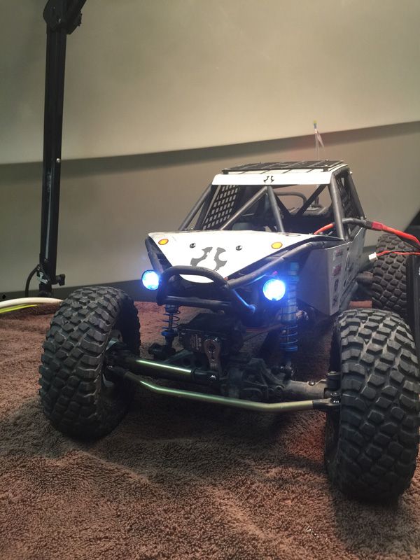

Did a simple plug-in for lights on my Bomber too, these headlights are $5 led lamps from china, they worked out great. Powered off the receiver.
