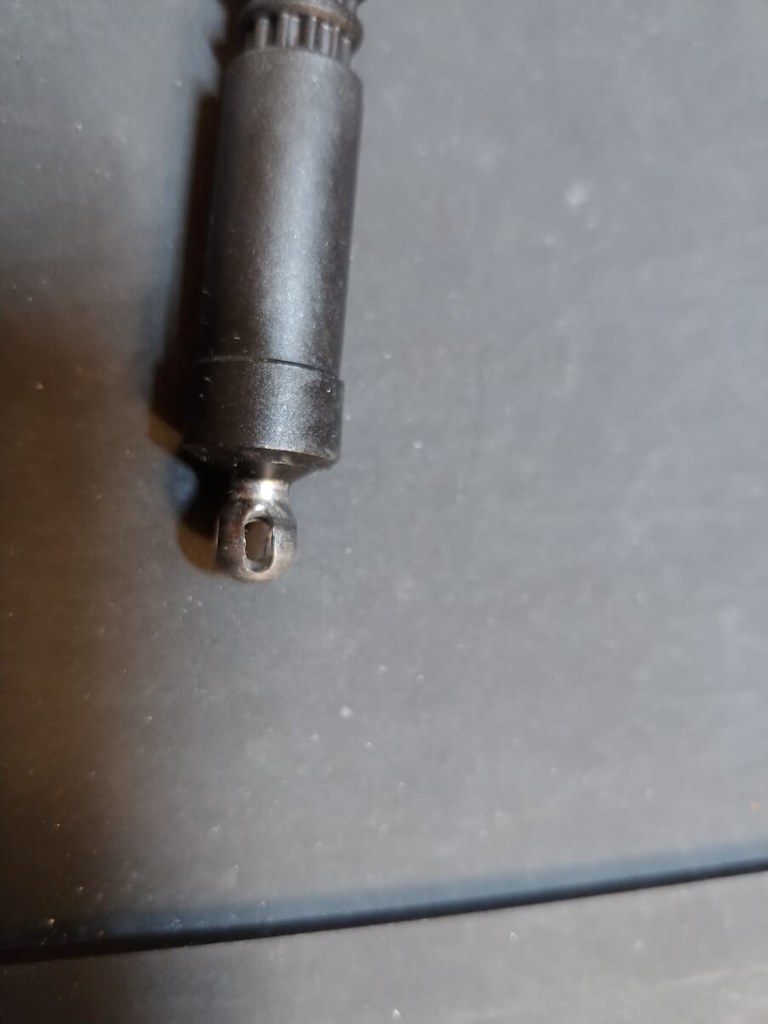

So I've been documenting my build, but haven't made a thread yet. Anyways, I ran into a snag at the driveshafts. One of my output drive CVD joints had an abnormally shaped slot for the pin causing it to bind on rotation. Sucks. So 3 out of 4 of the output drives are fine... just this one. I've had this same issue with a Junfac driveshaft CVD joint part before, and they replaced the joint for me no issues. Hopefully I can get a replacement for the Traxxas one soon. My build is halted for now, as I don't want to go out of order for documentation purposes.

Here's the issue I'm having.
So the slots are cut at an angle instead of straight up and down. To make matters worse... the other side has the slot cut at an angle as well. So looking from one side only... one side is / and the backside slot looks like \. Both should be | and |. This causes the cvd pin to bind on rotation of the shaft.

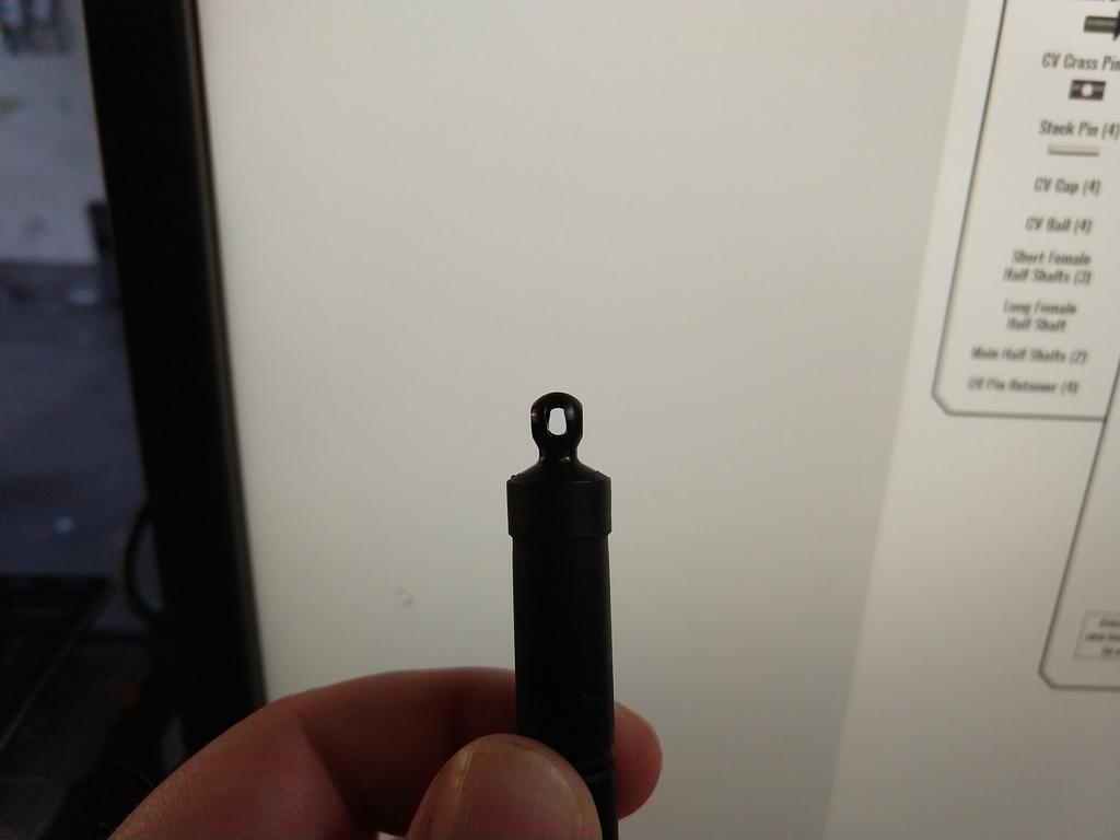

Just got to this step in my build today, and discovered the same issue with the slots in the CVD not being parallel. My drive shaft really binds up badly. I guess I will call Traxxas and see if I can get a replacement part.
So I opened my bag of driveline parts and put them all together. Out of the four pivot balls one has this cross-legged hole thing going on. I had a rat-tail jewelers file that goes much smaller than the pin slot so I just filed it out a bit and smoothed out the outside of the ball and assembled it - works smooth as silk.

I'd call up Traxxas anyway and get your replacement. It was really quick and no questions asked other than what part, and what's your address.
