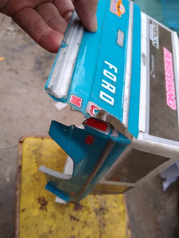

I bought a used Ascender Bronco with extra sets of wheels and tx/rx off ebay just for spares. I don't know what the other shell is and the cage is definitely home made. The Bronco shell has had the rear almost completely ripped off, so it's either bin it or maybe try a cab build. I'm keeping the chassis built up so I can use it to prototype some RULR's aand other stuff.
It looks like it's had some rough treatment, but as long as stuff like axles, trans and drivetrain are good then it's worth having. Ascenders don't seem too popular over here, so having some spares is worthwhile as ordering stuff takes a while. The tyres are Gmade MT1904. They look like they might work in the damp terrain around here so will give them a go.
You should see the bolts going into the body. At least 8mm lol. Must have been a blacksmith that built it
You should see the bolts going into the body. At leaast 8mm lol. Must have been a blacksmith that built it
:ror: when I zoom in I can see the Nuts. Hilarious. Now we know the 'N' stands for.

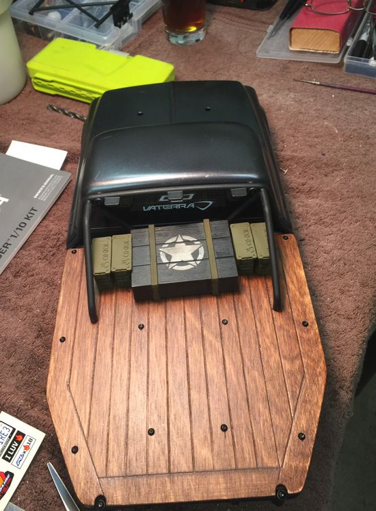

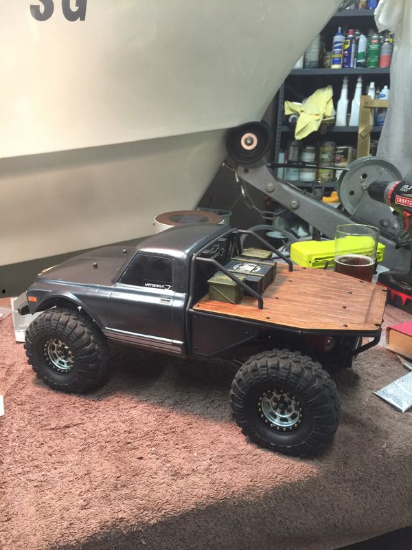

K10 Redux...
This one has trained 3 new drivers, been thrashed to death, repainted twice, and now a new lease on life. It still drives great.
HW1080 with stock Dynamite 35T, plus-1 pinion
Beeftubes in front
Extended rear lengths for WB4, stock front, puts WB right at 11-7/8" or 301mm. Just did this last night - works out well. Shocks have been out-boarded. Trujillo mod yet to do for shocks.
ADS-15 Arrma servo - DS3218 in the box.
I had robbed the rear cage for my other crawler so got a new one for this project...mod'd for a 3mm birch plywood flatbed. Works out quite nicely, have to trim down the rear body mounts that are not used for the K10. If'n I ever want to run a different body will likely have to get new shock towers.
Body has been lowered, front bumper raised and pulled in. Tamiya lexan paint on the outside. Yes, this was a yellow truck when it was new. 8)
SSD Steelies
Oh, and I got to put to use all those little ammo cans Axial packs with their kits. I always wondered what those were for. LOL
