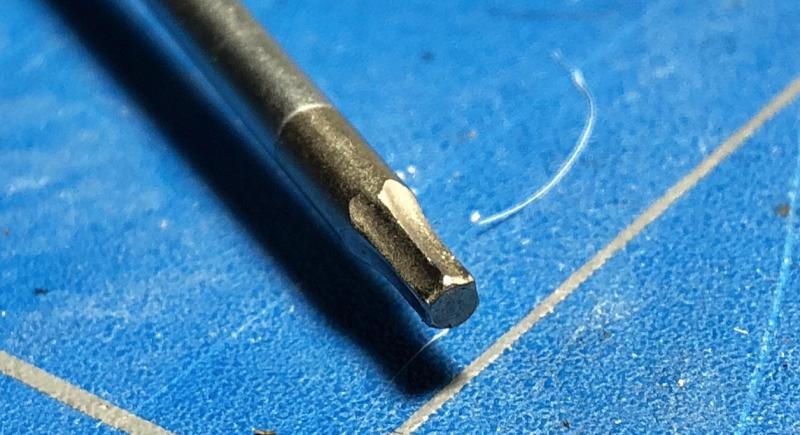

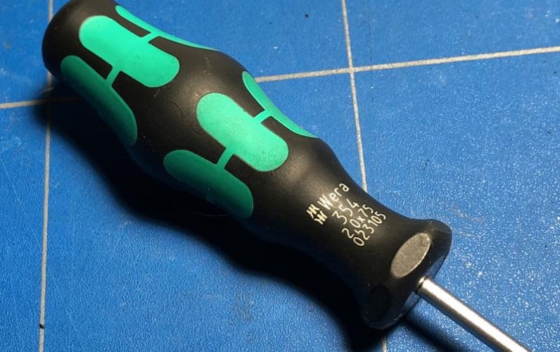

I throw my 2 cents in here: "WERA KRAFTFORM PLUS" from Germany (you can get them on Amazon).
Whenever I had a stripped screw or one that was overly tight (e.g. someone used a power drill to tighten screws), this one beat every single other hex driver I had so far. It is unbelievable until you try it out. The hex tip is shaped concave which just grips soooo much better than regular hex tips.
