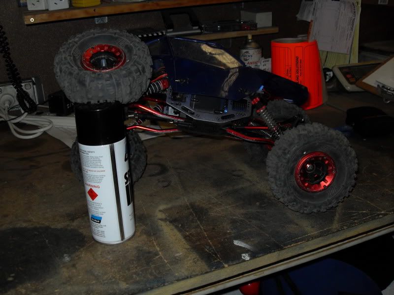

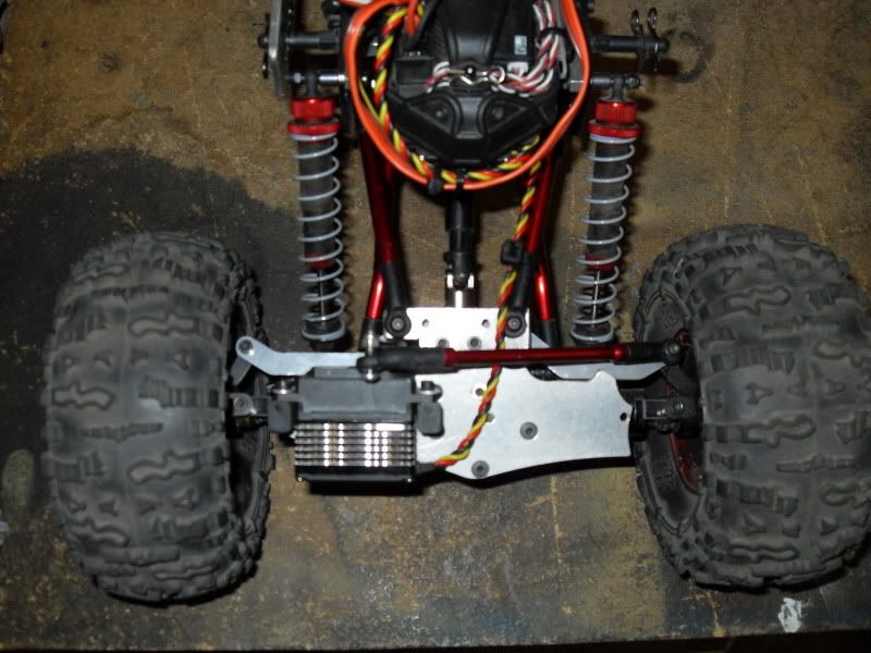

So I had too mate the shop/warehouse for my parents this morning so instead to doing nothing I made a adjustable rear 4 link plate, took the steering protecters of the diffs and fiddle with a few little things and tested it driving around lumps of timber and pallets and crap like that.
Wider arms made a big difference on steep inclines, still squats on flat ground tho. I'm not worried about that but. I also found out that the cralwers has a MASSIVE Epiliptic fit when the controllers battaries are low/near death.

The upper link arms are wider/further apart now on the diff side. Still needs adjusting/changing. I've looked at heaps of pics and read a bit but wanna do my own thing.
Will upload pics soon mate. Keep on eye on the post too dude ;)

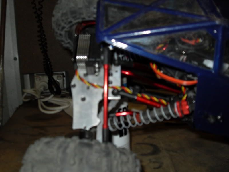

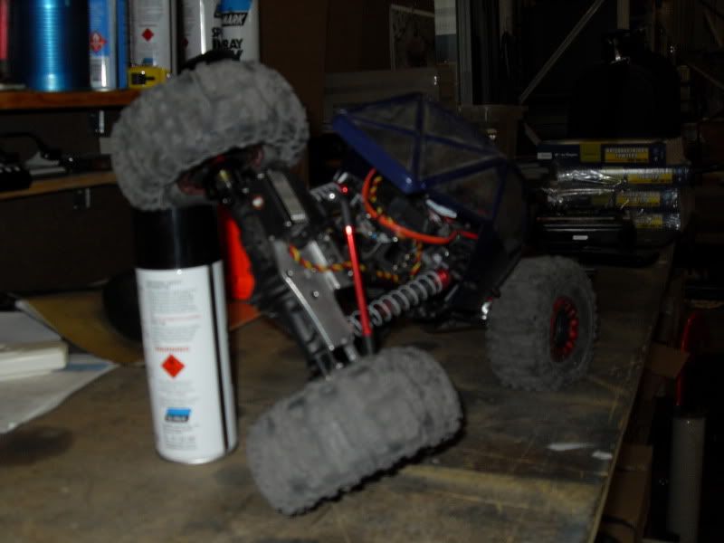

pics -
i appreciate the pics. i think they confirm my concerns about the ckrc BTA kit. if you pulled your shocks inside the lowering link mounting tabs (which i've done to give the tires room to swing in) it looks like the bow in machined drag link that allows it to clear the diff would hit the shocks. looks like the up-and-over drag link is the best option at this time.

Correct. That's how I put my together first.

Sorry Ben Imissed the fact that plate was the rear plate. Did it help getting the links up and out?

It's made a big difference that they are out. How does the up help? I could put a spacer under them too get them higher but what does that change?
Look back at the diagram in the Tips thread,,,raising them helps with anti squat,,spreading apart helps with roll center

if Im not mistaken from your pics...it looks like your front upper links are close together on hte front axle plate. If so then thats why it dives. spread them apart but keep them low at the axle.

The front link's are in the factory mounting spot. I'll put the rear plate on the front an make a wider and hiegher rear plate, if the rear steer will fit with it.
