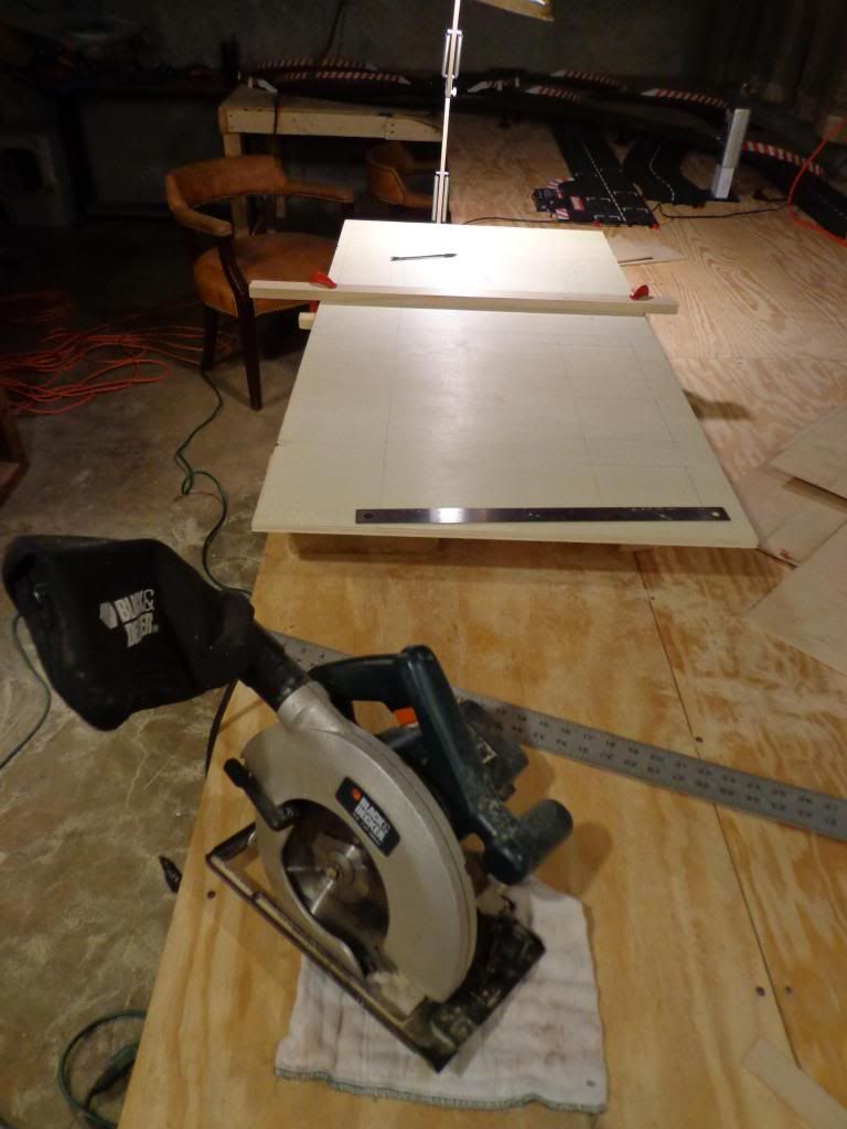

Step 2, Cut 'em out. I quickly realized that even with cutting the big sheets down, my microlux table saw wasn't ideal for this task. The thickness it could handle but the table just isn't big enough.... so....
Improvised a rip fence with C clamps & used my circular saw & then cleaned it up on the mini table saw.
Had a good day of solid work on this. Got all my wood cut. That to longer than I thought & things should move along better now.

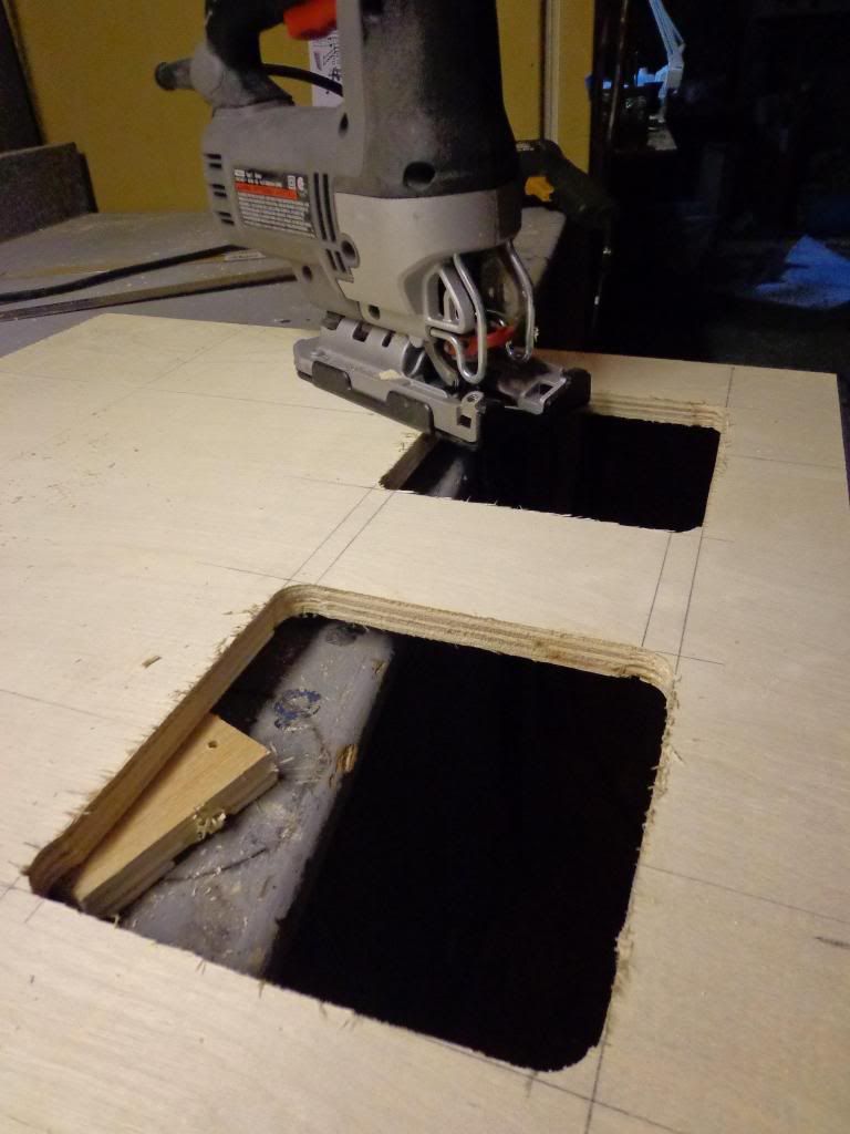

I buggered up exterior walls when I cut the windows out. I plan to do a block facad so not a big deal but here is how my tecnique evolved to avoid this:

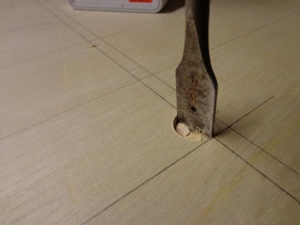

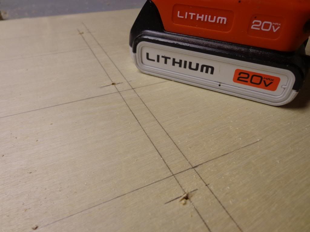

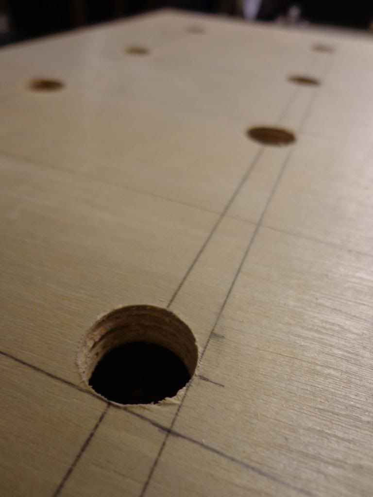

Using a 3/4" bit, I offset window lines 3/8" & drill la small hole:
Then use the 3/4" bit & just go down far enough to go the first layer or two of ply.
Flip it over & drill from the other side via the intial pilot holes and wallah! Nice clean holes, everyone appreciates a nice clean hole.
Then hack 'em out with a jig saw.
I clean the edges up a bit but with the prefab windows, it covers up the rough edge.

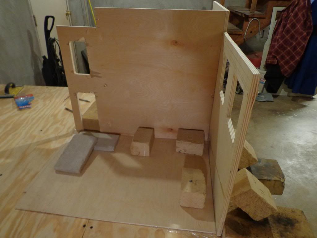

This is where I finished last night, Two main support walls, which form a T, glued together & the floor on either side of the "T" epoxyed in. These four pieces define the basic squareness of the building.

So... once I got the two support walls that form a "T" & the store floor in, the basic squareness of the structure is defined & things move faster.

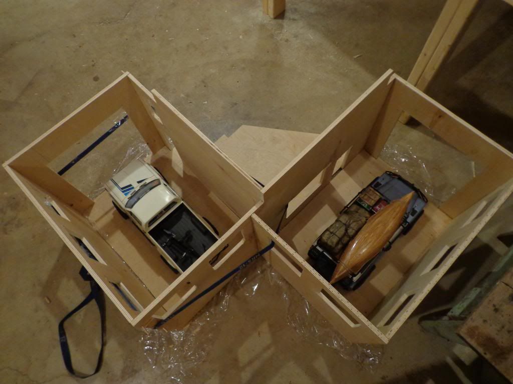

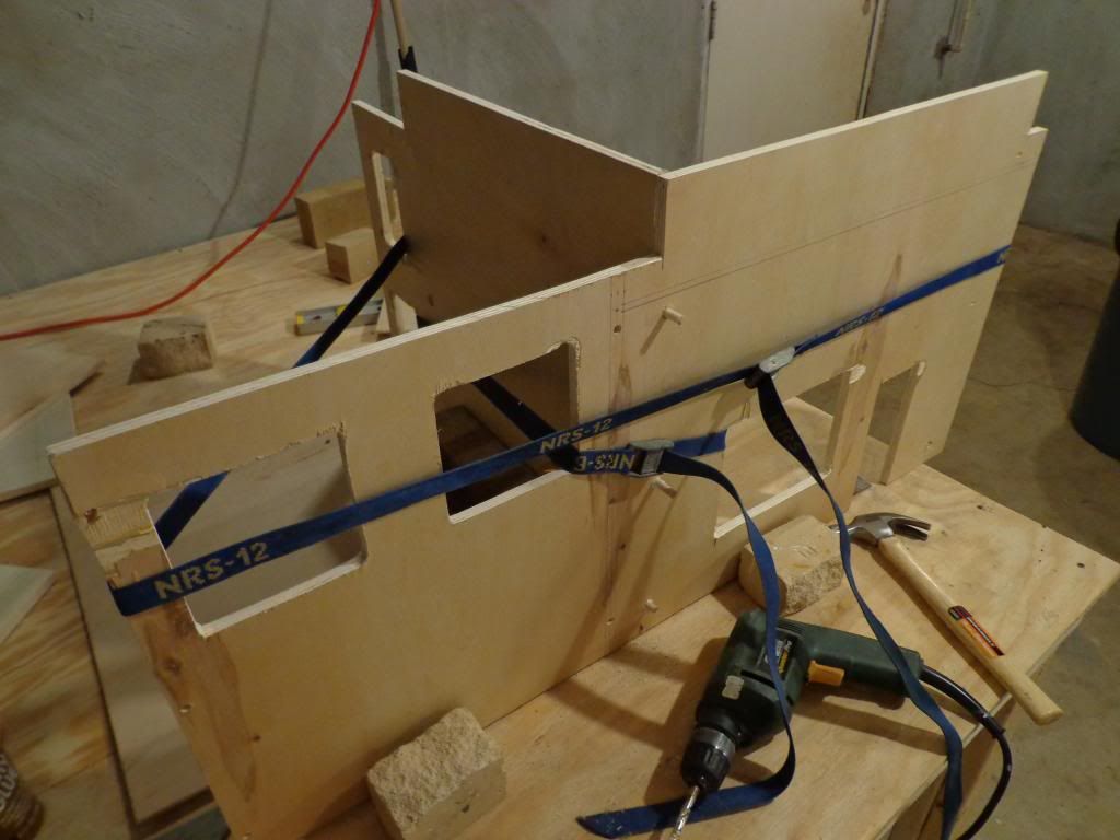

Next is to build the two bays. I found these old river cam straps really helpfull. I use saran wrap anywhere that epoxy might come in contact with something I don't want attached to my garage... like the basement floor.

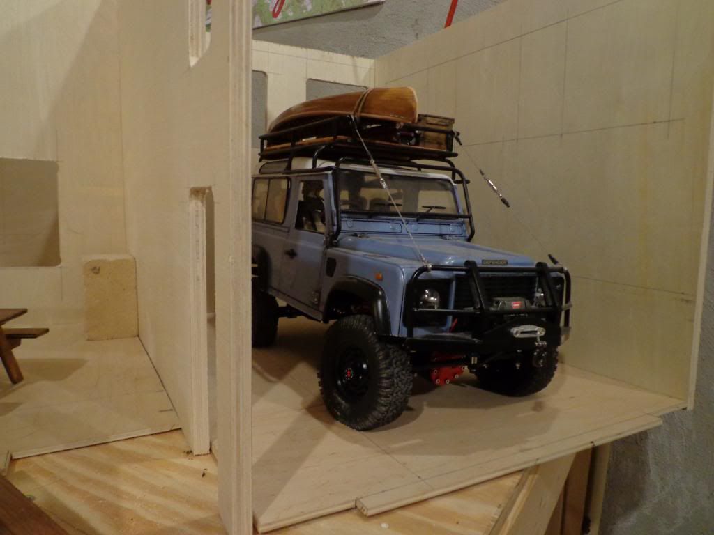

Bay 2 walls in/poser shot:

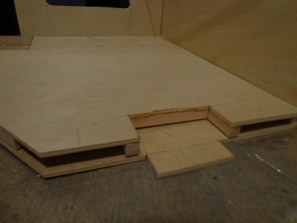

Now working on the raised floor in the store area & ran out of epoxy so I stopped here for the night (actually it was 2:38 am, I'm tired)
I'll get this glued in tonight & start working on adding some filler to the window cut outs I botched & I'm going to put in a hardwood floor in the store & get some of the inside work done before I put the store front walls on.
Here is the floor epoxyed in & primed. This thing is sturdy now. Start cutting & sanding wood strips for the floor (what fun)
Detail on the raised floor.

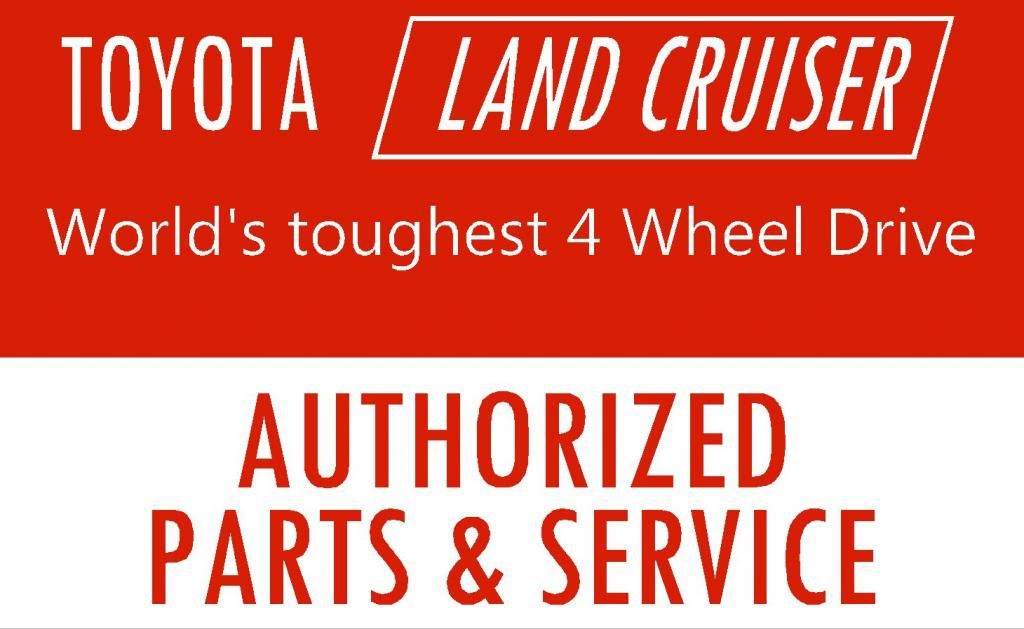

And... I said I was going to do the exterior before I started on the inside, but I found this cool old Toyota sign image from an ebay auction & it wasn't good enough to use so I made a vector one... even found the Toyota red RGB colors: R:216, G:30, B:5

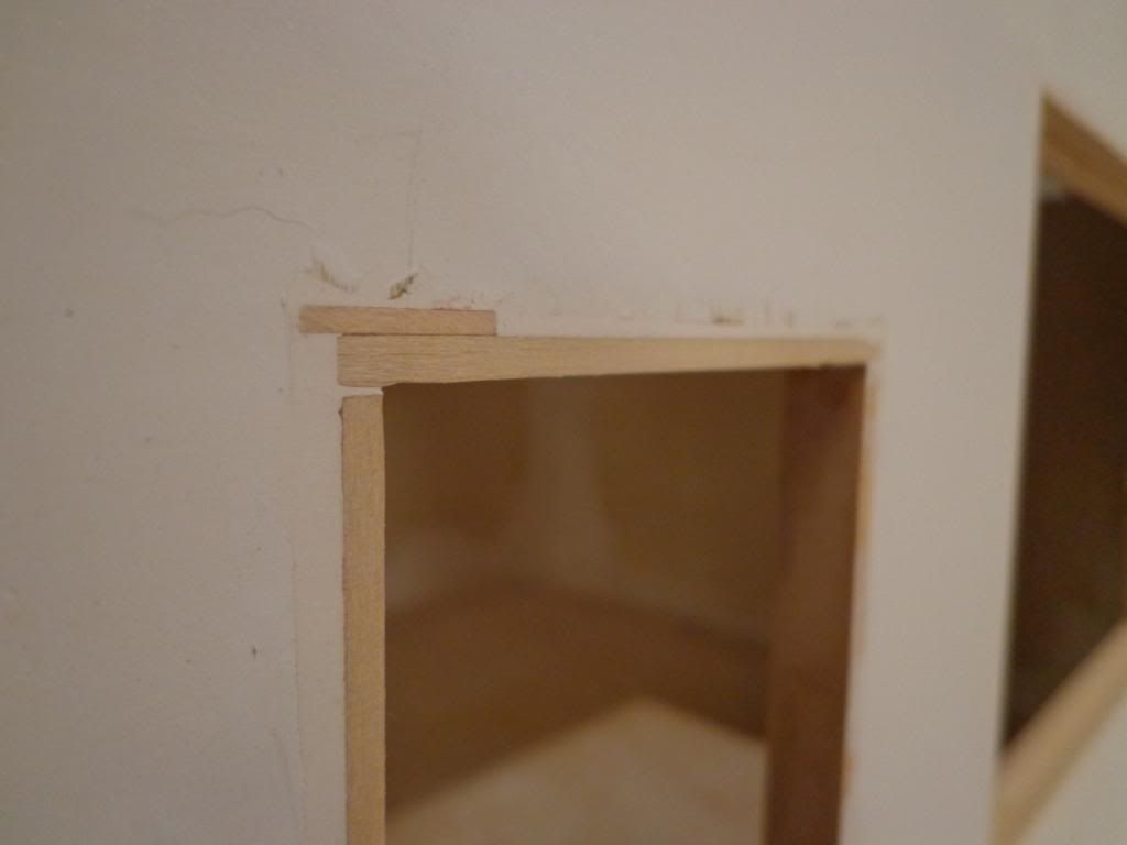

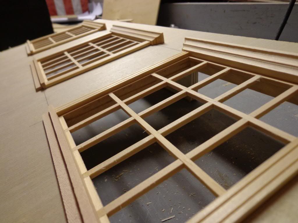

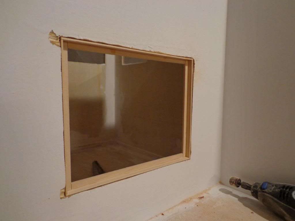

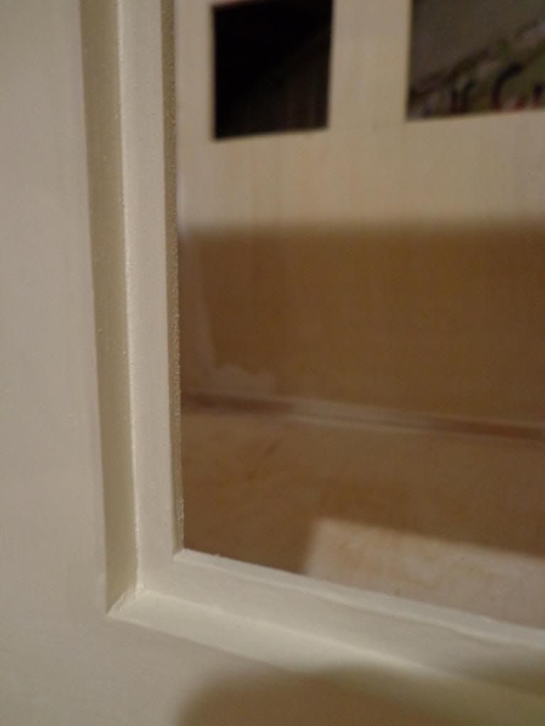

Update. I've been painting the prefab windows. They really look good. I have two windows and an interior doorway though that I'm going to have to scratch build, big plate glass looking winders.
So, I made a frame from basswood, glued it into the opening:

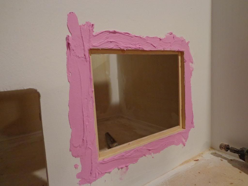

Gooped it up with spackle:

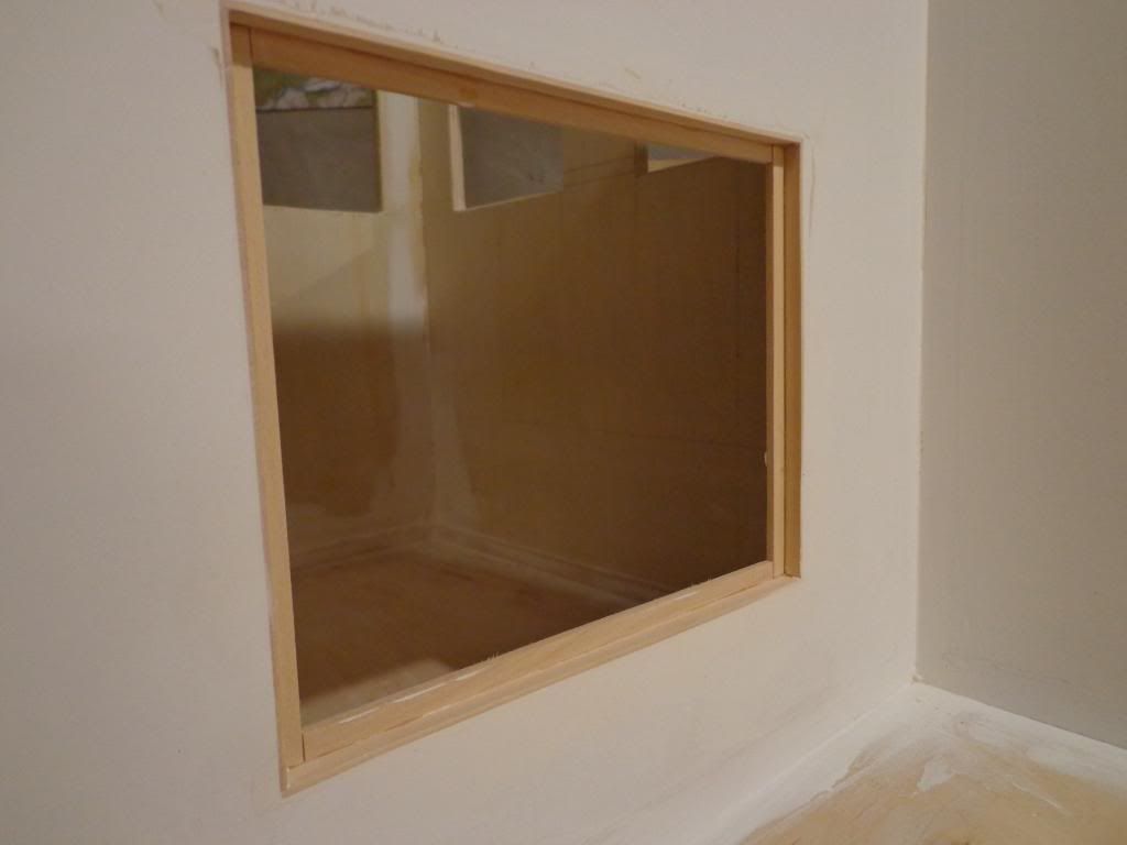

Sand smooth:
And paint:

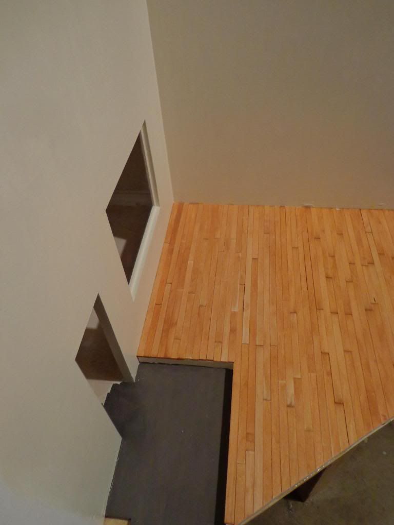

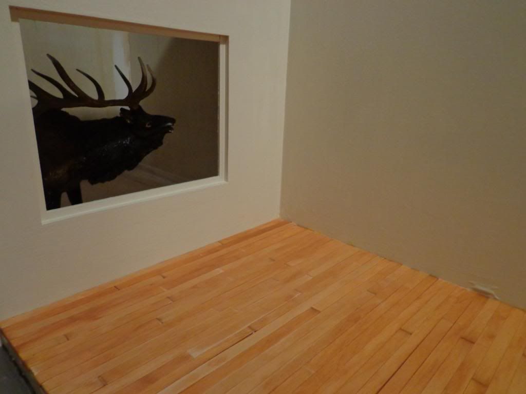

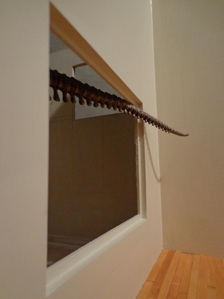

After I got the interior walls of the store painted, I ripped 1/4" basswood strips for the floor.
