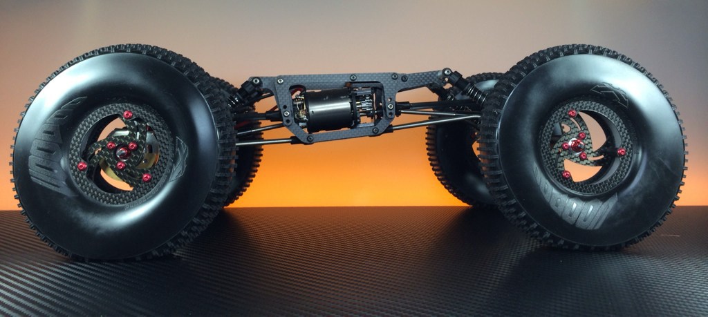

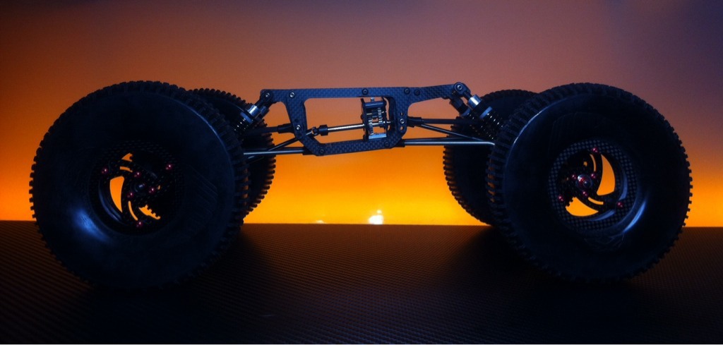

Today fritzthefly and me did have the final buildsession bevor nats of spain.
Changing since last week.
- changing the shocks from the bling,bling pro shocks to the cheap SCX10 original ones.
- going deeper, specially on front
- changing springs front/extrasoft rear/soft
- changing steering link to the NCD Version
- going down with servoplate(red spacers have to go)
- changing caster
Today:
- Fritz "titanhopupsticks" for the shafts...think 40g for both are not so bad...
- new front lower links - straight one's
- put the motor inside(my old team brood's...we change them soon)
- elektronik finish
With these changing the SuDu one FL is ready for real live...comping
If i could find time i will post some more pics.
B I G thanks go to Fritz...great job my friend!!
