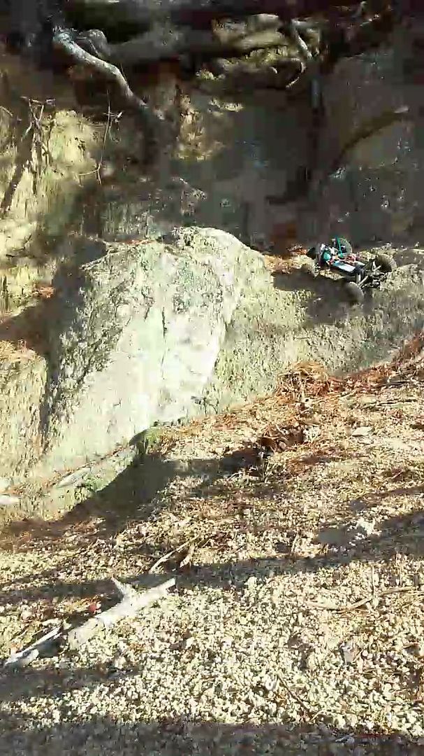

Some pictures!
Just the truck getting ready to go
Front end weight. It's a dewalt bit container full of lead sand from an ankle weight.
When it warms up, I'll kayak out there for some real fun,
I was able to carefully maneuver my way all the way down and around this trail I'm showing. That was fun!
I almost think traxxas should have made this come stock with the velineon esc, and the 21t titan motor. This thing is right at home with the titan and 3s power. I guess they wanted to put 30 mph on the box. Or they could have given us the mxl 6s and the 21t. Ha! Then it would be waterproof, and we could run 4s and they could still advertise the 30 mph!
