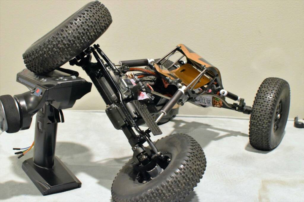

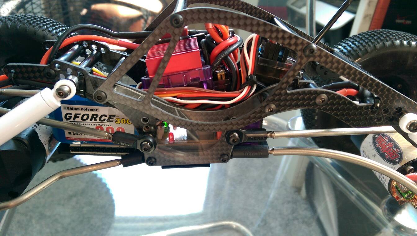

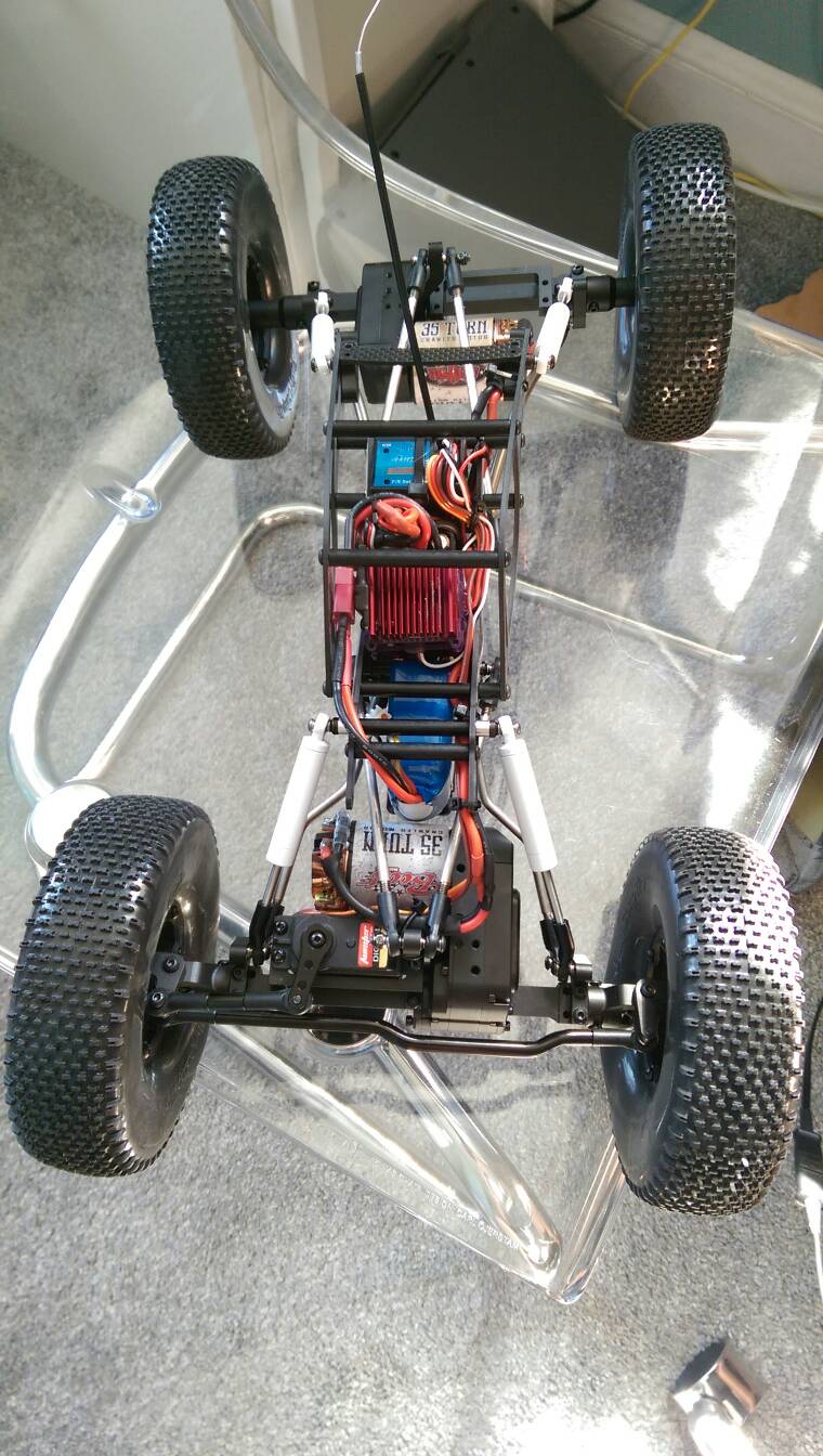

Pics soon after getting the rig but cleaned up the wires but there were still a ton of wires:

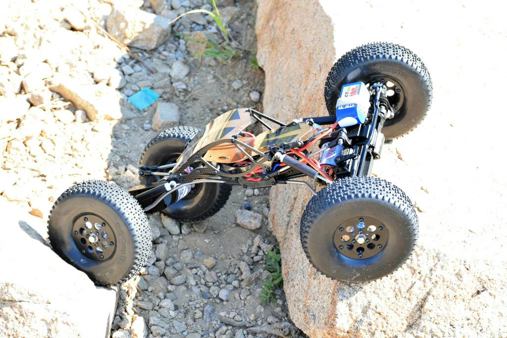

Then I went to a local ECRCC comp after painting some panels, changing the esc for a cheap hobbywing which worked better than the outcry, cut some pins, added rc4wd extenders and mounted shocks/links on what others did on RCC. Oh heh and cleaned up wires again:

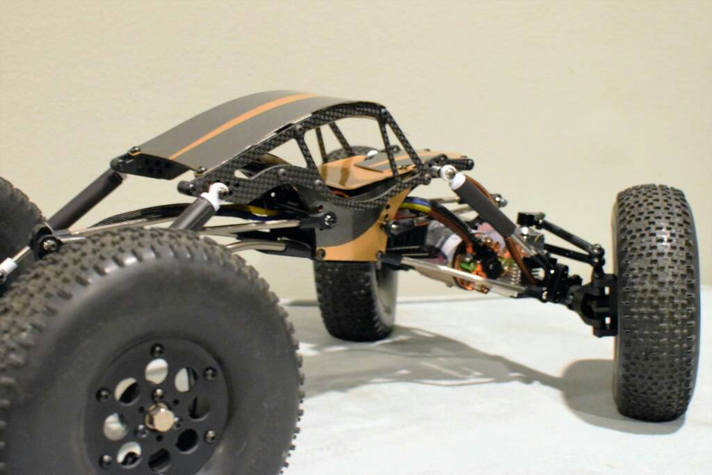

Then I got home after not completing any courses but was happy enough with my true first runs other than climbing children's toys. I learned a ton more and will be getting back to work on it. Started by adding the 2nd hobbywing esc to run dual on the cheap to learn and hacking my GT3C which was fun. I also painted the side panels now. Installed CI foams (DD6comp cut softnarrow front - DD5.5med narrow rear) and installed promodeler 420oz servo. Also cleaned up some wires again and placed my steering link on top of the knuckles. I'm waiting on a castle bec and 2661 shocks with losi springs and dlux standoffs plus no preload retainers..... Think that's all for the moment.

Looks good. Dig the colors
Thanks, planned on airbrushing but it didn't work so used what I had lying around. Might be in need of a few decals, thinking about it but might just keep it simple. Decisions, decisions, decisions.....

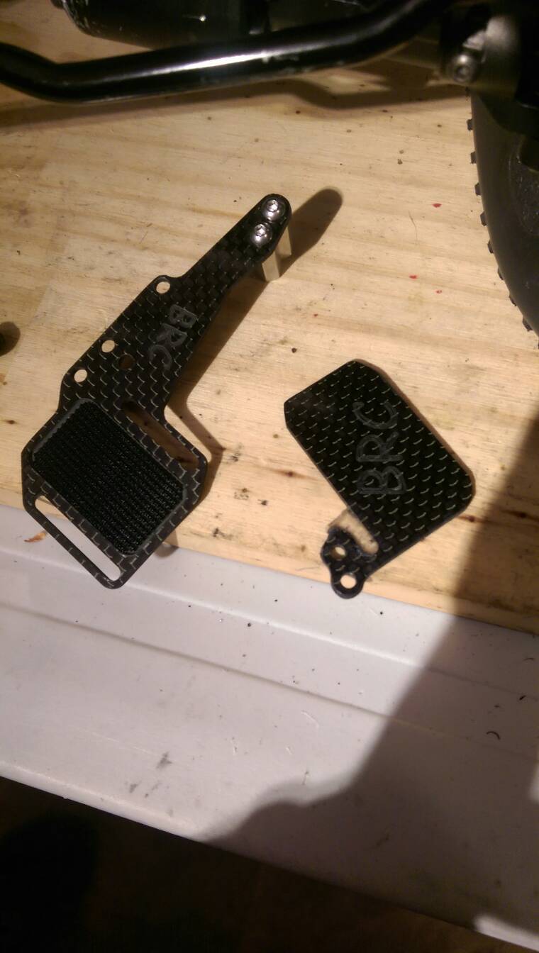

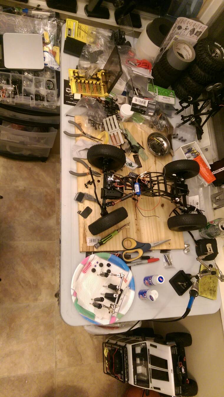

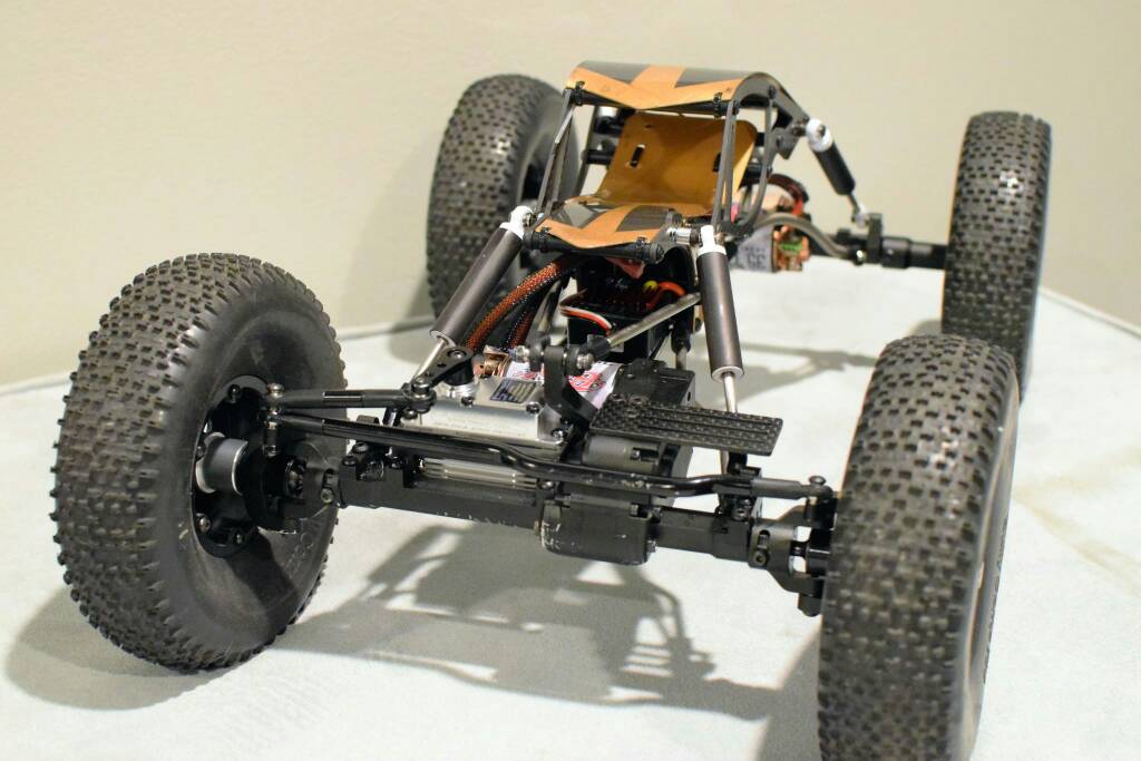

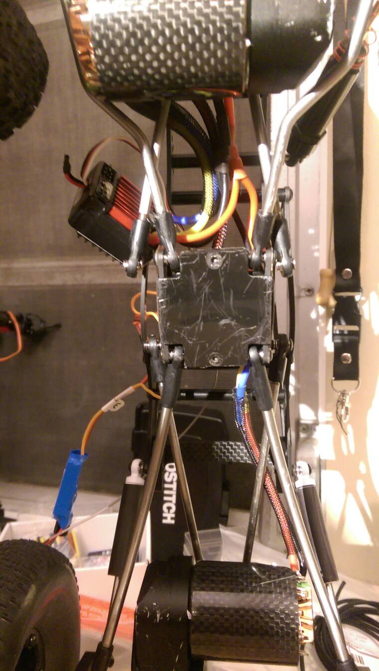

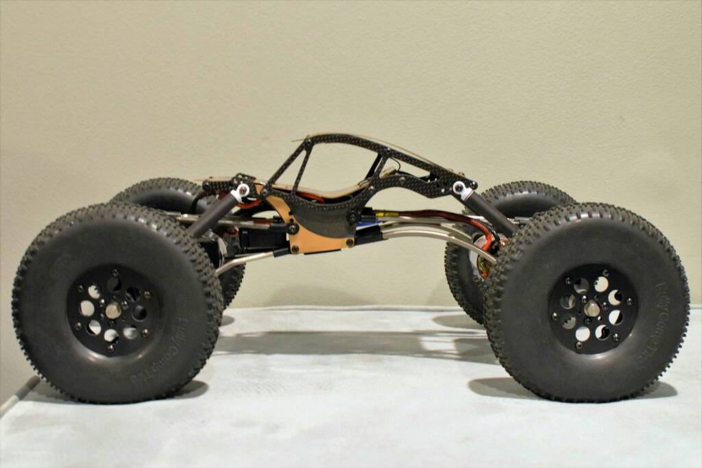

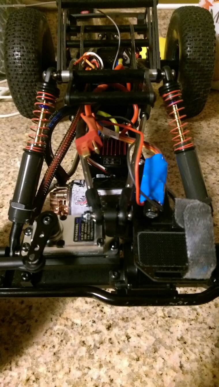

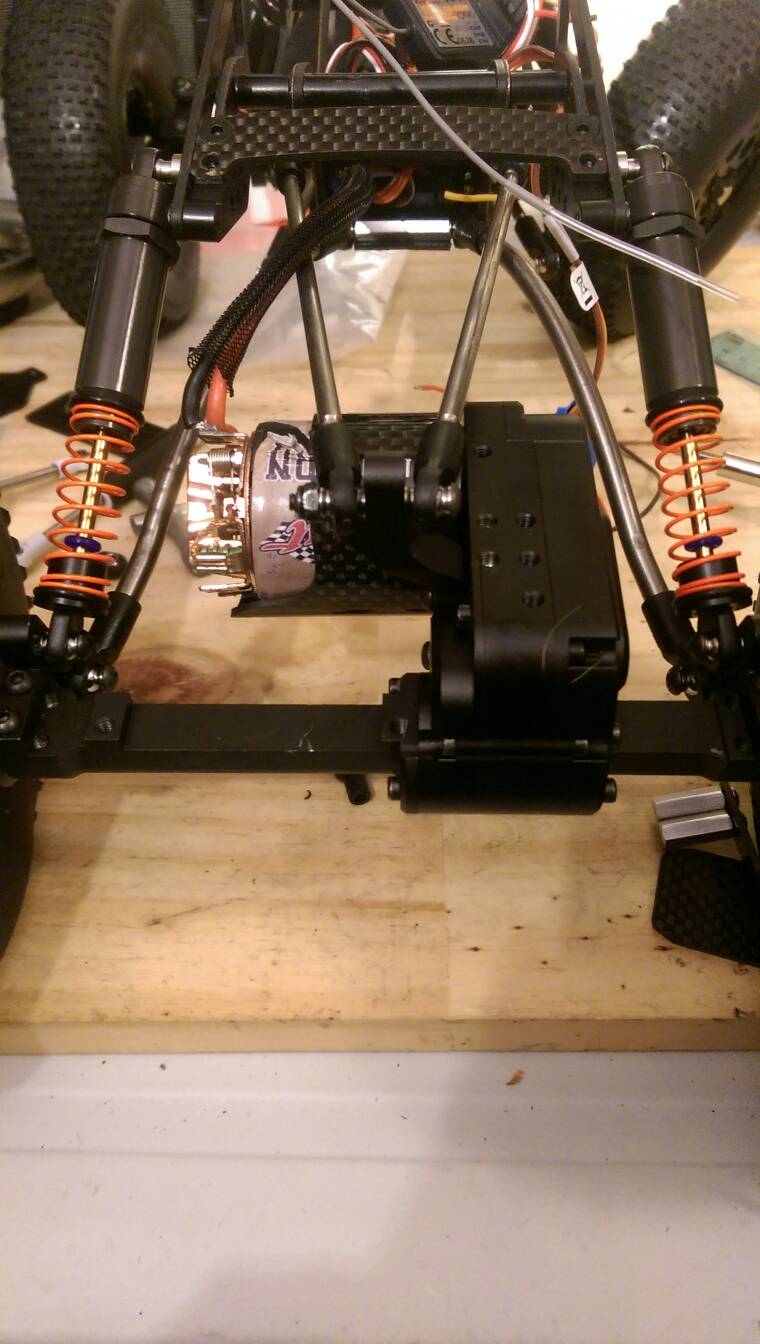

Ok so I've done a couple more updates and took it out for a spin this morning and it feels like it has improved and the dual esc is a really nice feature even with them falling into the cheaper variety. Here are a few pics of the updates and my mess of a workstation:
Had to modify Barry's batt/electronics tray

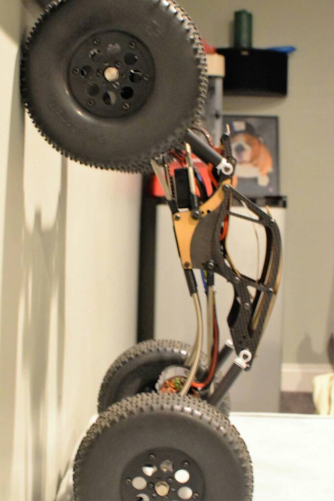

Out with the stocks and in with the big bores
What a mess!
Cap modded the front shocks
Used DLUX no preload retainers all around and his shock ends on the rear

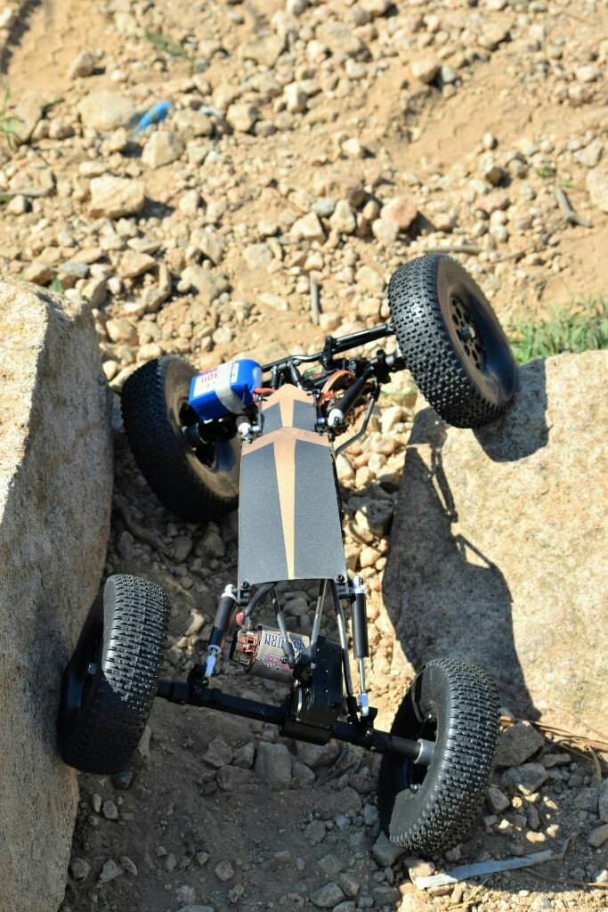

Cut down the chassis a bit.

Lookin good! Should notice a big difference in performance. What weight oil did you start with?
Went with 35 front and 50 rear, don't have a ton of options on hand. Other eta I had were 25 and 30
Sent from my HTC One_M8 using Tapatalk
Orange or pink springs?
HANG UP AND DRIVE !
Actually doing the red(med) in front and orange(hard) out back. Still seems to have plenty of flex but not super soft. Can always switch them out to test in the future.
