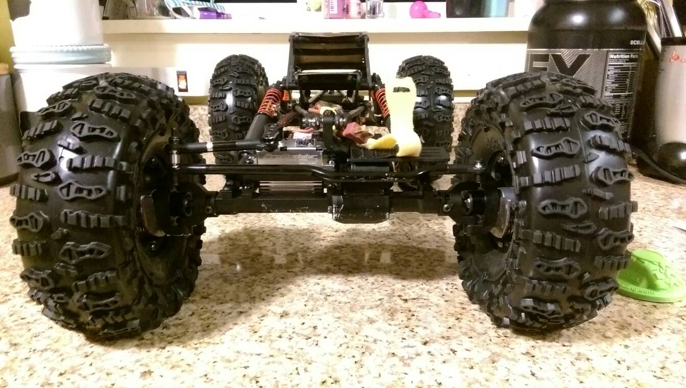

Mounted the Ruptures up with out any mods other than some air holes and running CI foams. Now I'm about to go test them out a bit on my new found spot!

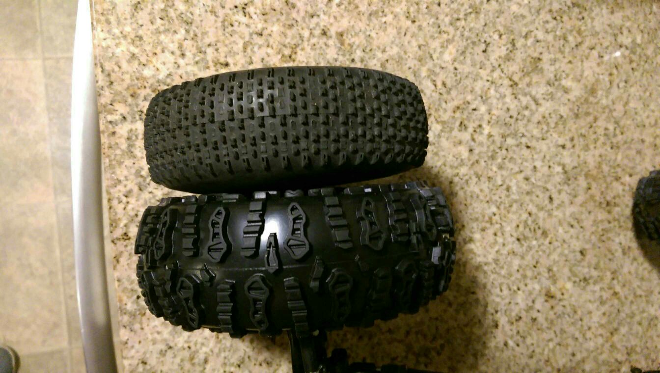

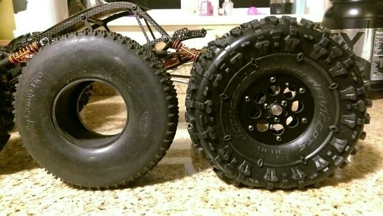

Are they that much wider than the stock bully's ?
I have a set on some wide proline wheels for my yeti. One of my favorite gripping tires down here , I was thinking

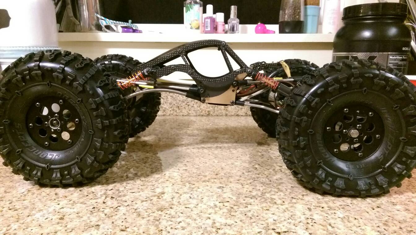

Here are a few pics:

What do they measure for height? Huge difference from stock but they need some narrowing, they probably rub a lot on the links. Added height will make a big difference, I cant wait to get some taller tires.
Just under 6" and they do rub at the moment but not as bad as I thought they would. I couldn't get a true comparison because the rocks were damp and the wheels were damp from some wet grass/dirt. Felt they were performing better but also felt like I was flipping over a little more. I still need a knuckle weight system and will be working on that which should help a lot.

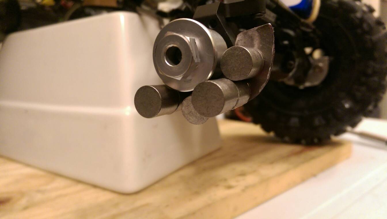

Added these weights on for the time being because I'm not ready to buy new wheels yet for other weight options and already have backordered rc4wd weights waiting on towerhobby with using tower cash so basically free.

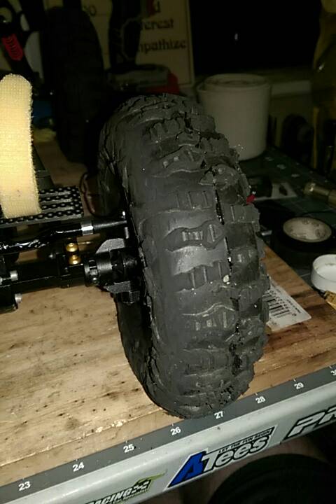

Yes I have searched for ruptures narrowed as well but yet to see them done I have a set coming in I'm going to narrow.. And shave the sides down. My idea was to remove all the smaller center blocks and possibly the inside tips of the larger blocks? To take 1/4-1/2 inch out of the centres. And the second set just shave the side walls and see which is the better option.

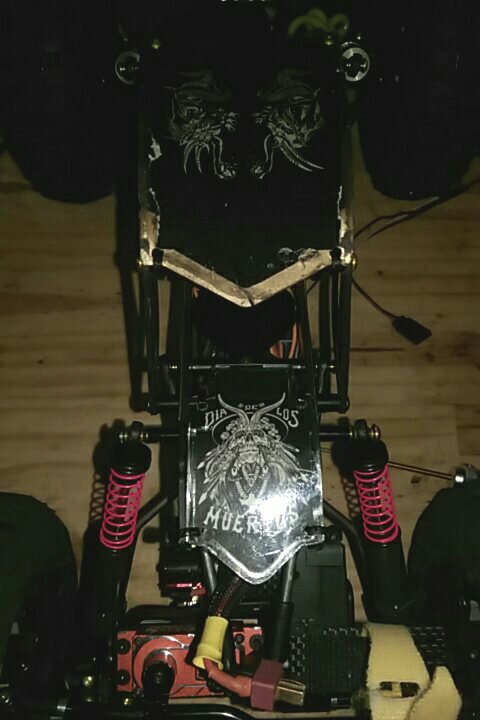

So it's definitely been awhile, added a few more to my growing fleet but here are some changes this rig went through. Now to find the time to run it with 2 small children, a wife and busy weekends. At least I'm prepared when the time comes.....
75g rc4wd weights

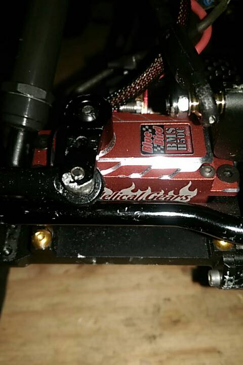

BlueBird H50C (moved the promodeler to a shafty)

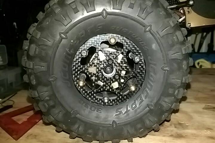

Narrowed and shaved the Ruptures
Printed my own hood (sticker and laminate protectors to underside of lexan-it's taken a small beating so far)

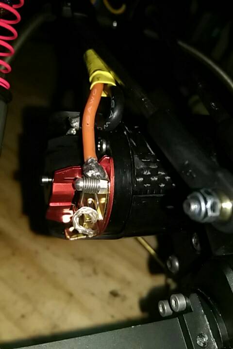

Aluminum screws in some areas and bored the rear tube some.
