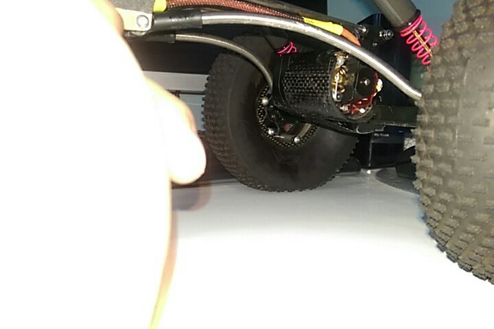

-clocked axles a little to bring the motors back down to lower cog

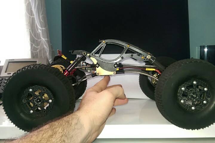

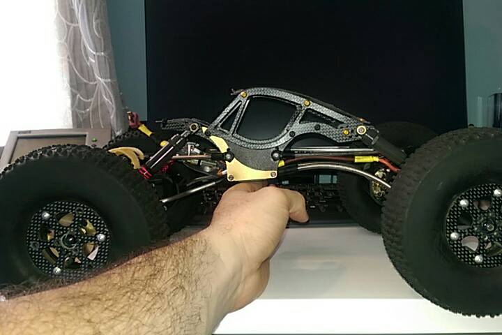

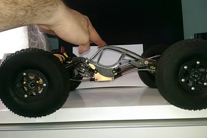

A couple of questions to ask along with my pics.

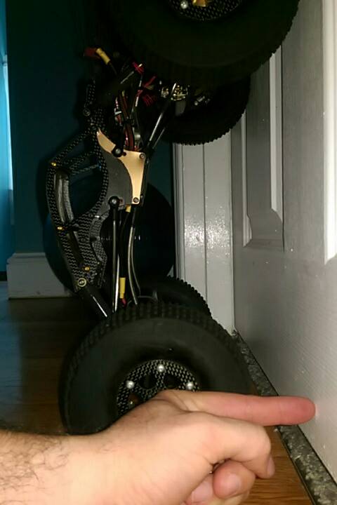

-Should it be able to sit flush with the wall? (Pic is as far as it goes before tipping) And if it should get closer will clocking the axles down a little more help with this?
-Does ride max/neutral/min ride height seem to be on par?
-Do shock angles seem to be about right?
I know it's hard to tell from pics with angles but did my best.
