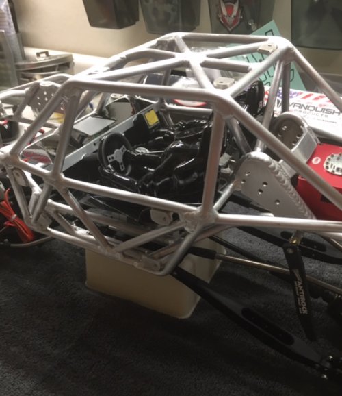

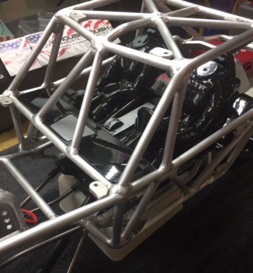

I got the stock Bomber interior panel trimmed, painted and the decals installed - finally! I still have to paint the helmets for the interior panel, but we've had a small little winter blast, here in Michigan...:flipoff:
I got the interior panel in the BGR chassis, but I'm gonna have to get a little creative on the mounting. I have the rear mounting figured out, but still have to brainstorm something for the front. I want the actual method of mounting the interior panel hidden (no screws, zip ties, etc. showing). I have a couple ideas, just have to figure out which one will work, or if either will work!

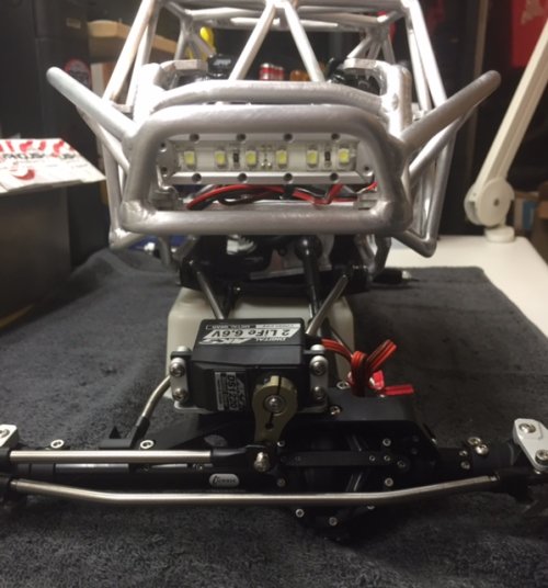

I also got the Vanquish 2" Rigid light bar mounted right behind the front bumper. I can't really take credit for the actual "mounting" of the light bar. Bill actually had it mounted, when the chassis was shipped to me. I just removed the light bar after I received the chassis.
So basically, I remounted the Vanquish 2" Rigid light bar! ;-)

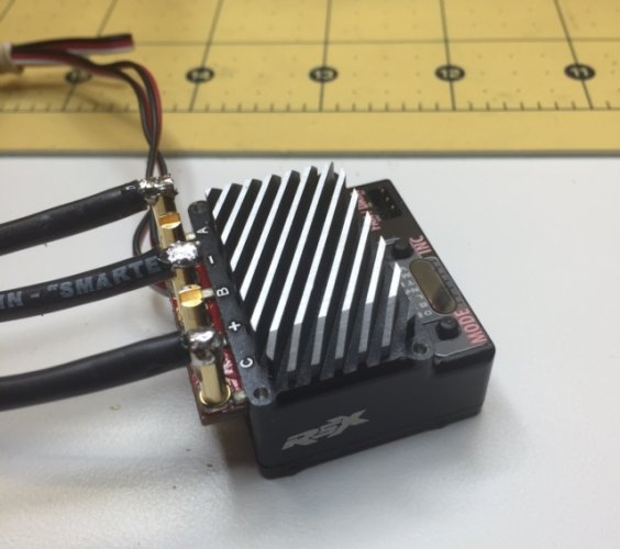

I had a bit of time today to get some stuff wired up and soldered on the Bombdiggity! "thumbsup"
Disclaimer - My soldering work isn't the best looking! It's not horrible, but it's not the greatest! I've never had any cold solder joints, or anything come loose!
I started off soldering the wires on the Tekin RSX. I did it a little backwards, though. :roll: I soldered the three motor wires on first, which made it a bit of a pain to get the capacitor soldered on the + and - posts. I was able to get the cap soldered on! "thumbsup"
I did end up using all black wire from the ESC to the motor. I really didn't want the red, black, and white wires showing. I did use red and black for the main power wires going from the ESC to the lipo.
I got all the wires soldered on, and the fan assembly back on the ESC.
If there's one thing that I dislike about Tekin ESC's, it's the posts that you solder the wires to. I really wish they would do something different in that area.

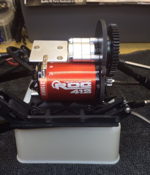

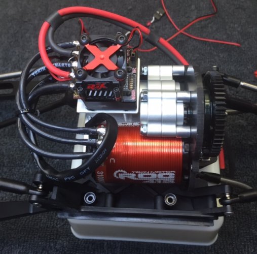

Now, it was time to break out the motor and get it mounted on the tranny, and get the ESC installed on the shelf that I made. I like installing the motor, then soldering the wires to it. For me, it makes it easier to figure out the length of the three motor wires.
I finally got everything soldered up on the ESC and motor, and got them both installed! I did solder a smaller gauge power and ground wires to the positive and negative posts on the ESC, so it can be ran back to the fuel cell / receiver box. That small gauge power and ground wires will be used to power my BEC, and the VP 2" Rigid light bar through a HeyOK light controller.
I think it turned out looking ok. Like I said, my soldering work isn't the prettiest, but I guarantee there won't be any cold solder joints either!

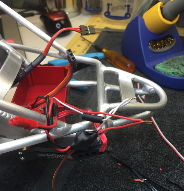

I didn't get many pics of me routing wires and getting it wired up. We all know what that's about!! Probably one if my least favorite things to do when building a rig!
I ended up mounting my CC BEC under the interior panel, towards the back. I mounted the receiver and the Heyok lighting controller (along with the extra wiring) in the RC4WD aluminum fuel cell.
It's definitely "50 lbs. of crap in a 5 lbs. bag", in the aluminum fuel cell. A little more "packed" in the fuel cell than what I like, but everything is good and it will work!
You can see some of the "50 lbs. of crap" in the pic.
I used the expandable mesh wire loom covering all of the wires. That stuff is not the most user friendly, but it's not too bad after you get the hang of it. I also used black shrink tubing to finish the ends on the expandable mesh loom. I used small black zip ties to keep the wiring close to the chassis as possible, but strategically placed the zip ties so they won't be so noticeable.

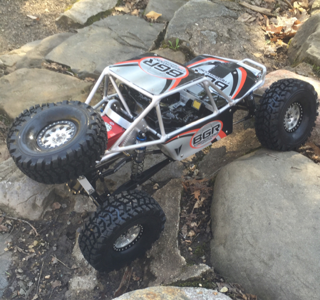

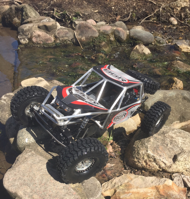

I got some teaser pics posted up, as you may have seen....
I am so damn happy about how it turned out! I love it!! :mrgreen:
It's not finished, though... I still have to get a T-handle (hint, hint, Bill) to mount the spare tire. I have to paint my helmets and install them! Those headless drivers are gonna ruin my BGR Bomber!! :shock:
I want to add a radiator on it, in the rear. There's a few other small aesthetic things that I want to do to it.
I would also like to drop the suspension just a hair more. The spare tire in the rear is heavier than what I thought, so I may end up having to put some stiffer springs on the Pro Line Pro Spec shocks, in the rear.
I'm not quite sure yet on how I'm going to drop the suspension. I'm at the very top hole on the front shock towers on the BGR Chassis. There is a little room to drill another hole higher, on the front shock tower. I don't know if I have the guts to do it yet! :ror: The rear shock tower has a couple more holes above the one I currently have my shocks mounted to. So, lowering the rear should be easy!
I was able to run it for a few minutes, but just in my front yard. I do think I'm going to go down a tooth on the pinion gear and see how I like it. I dialed back the throttle EPA on my radio and gave it some decent amount of negative expo, and it still seems a little too fast on top end. I could maybe try dropping the current limiter setting in the Tekin RSX and see if that helps, but I doubt it will.
The MKS servo seems to move the 2.2 VP Methods and Voodoo U4's pretty well! "thumbsup" So far I'm impressed with the MKS servo! We'll see how it does in something other than my front yard, though!!
Like I said, I am very happy with it! I couldn't ask for anything better or different on it! I just gotta finish up the few cosmetic things, play with suspension and gearing a bit, and she'll be ready to rock!
I'll continue to update the thread as I add things or make changes to anything, and let you know if I like them or not. I'll also include pics as I add some of the cosmetic things to it!

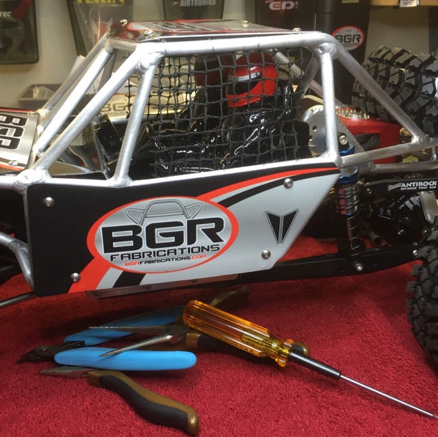

I got my helmets painted for the interior. I went with two full face helmets. I painted them red to go with theme of the skins. Nothing fancy, just painted red with the decals added!
I also added some window nets to the chassis. I was unsure how I was going to attach the nets to the aluminum chassis without it looking horrible! Bill came up with the idea of using a really small gauge wire (safety wire) to attach the netting to the aluminum chassis.
I purchased a small roll of 28 gauge galvanized steel wire. I grabbed my Lego netting, wire and I went at it!
I don't think it turned out too horrible! You can't see the wire in the pics. It's visible if you look closely at it. I wrapped the wire around the chassis tubing, along with the netting, pulled it tight and twisted the wire a few times.

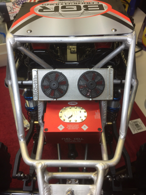

I also got my radiator installed. I'm not fortunate enough to own a TSS scale aluminum radiator, since TSS no longer produces them!
I painted up a plastic Yeti radiator and used that. It didn't turn out bad, but wish I had a TSS scale aluminum radiator (if anyone has one they would sell me!), but this will have to do! LOL!

The netting turned out nice. I tried but couldn't see how you mounted it so "thumbsup".
