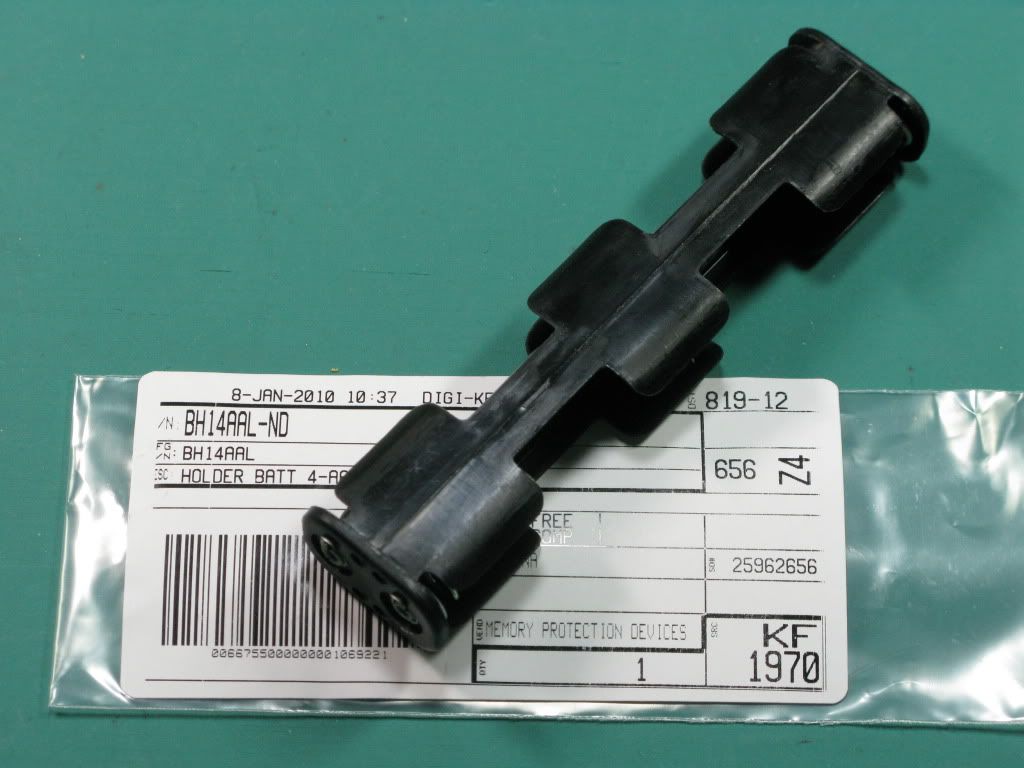

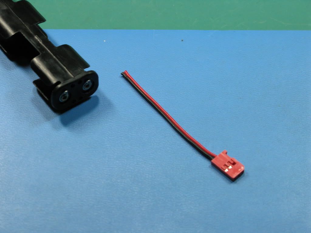

I had resigned my self to just wait for this item to be released by Futaba for sale, knowing it would probably be at least $20. Then the idea hit me, make one, so off to Digi-Key I went, $.89 later, here is what I got:
I had a old switch laying around, and I cannibalized the connector/wires.

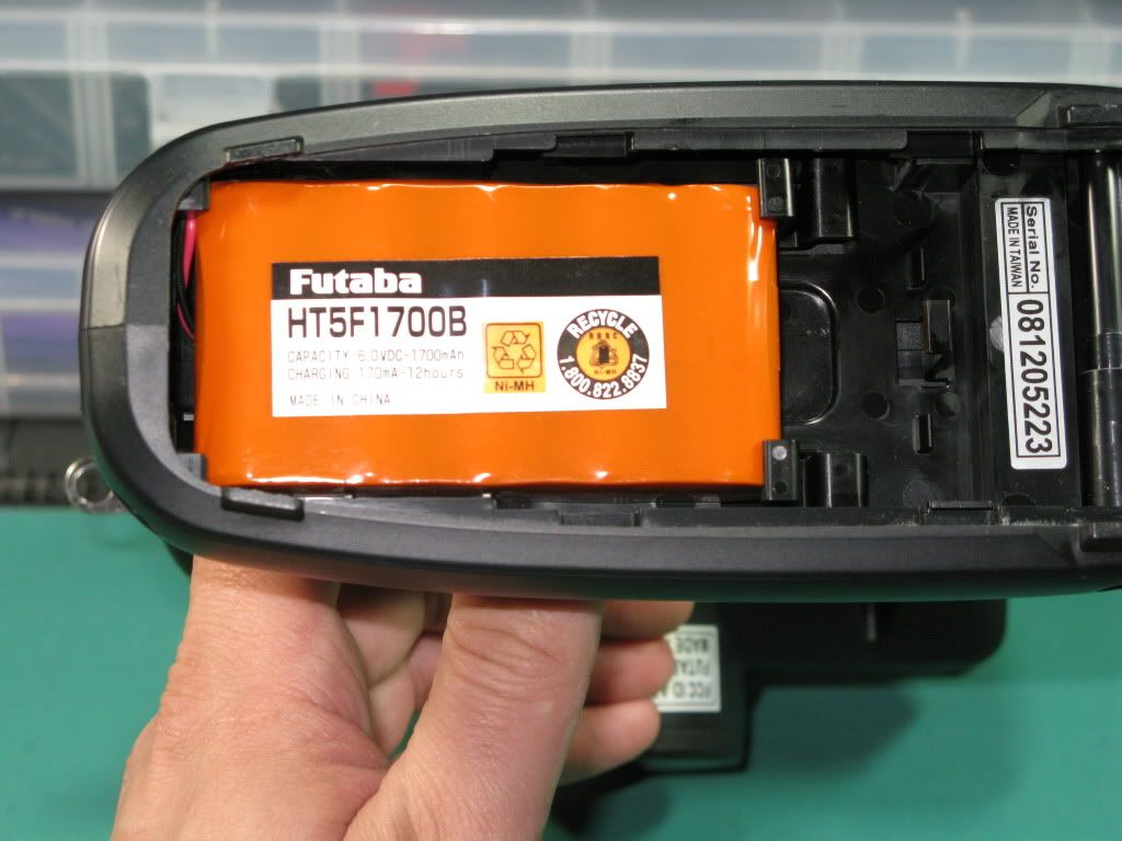

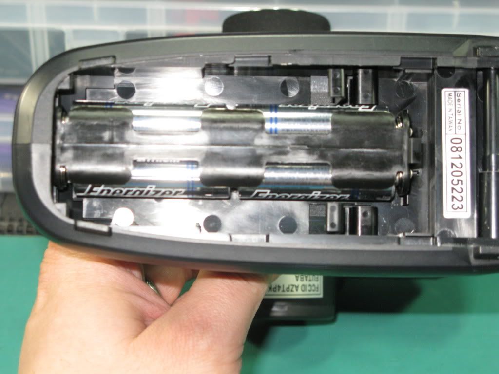

Here is a comparison of the stock pack versus the 4 cell pack:
Stock Ni-MH
4 cell holder

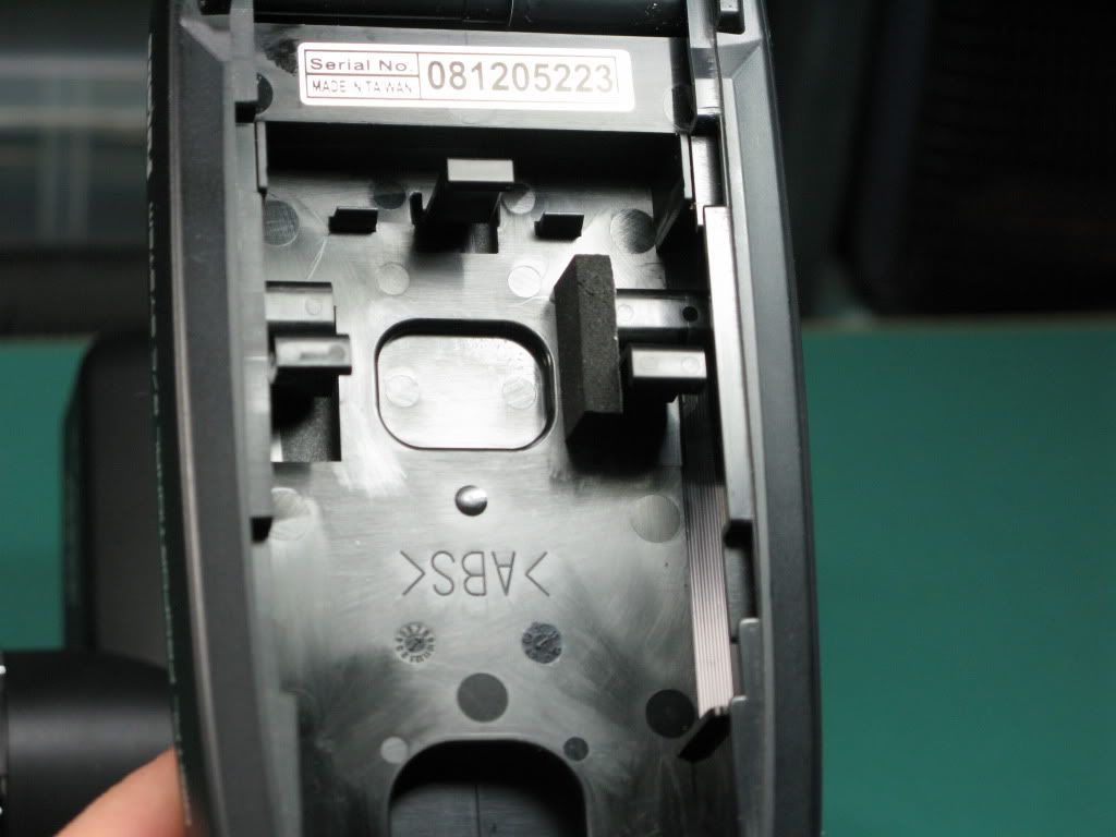

Once installed there was a small rattle when the transmitter was shaken, so I placed two small pieces of self adhesive foam (1/8 thick), one in the battery compartment
and the second on the battery door
Next it was off to change the battery type in the menu.

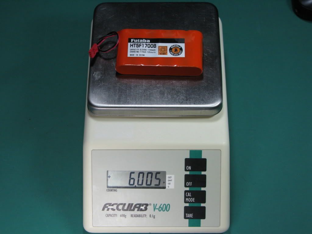

Just in case you don't believe there is a weight savings by converting over, here's the proof:
That's a savings of almost 4 ounces, at a cost of less than a dollar...
