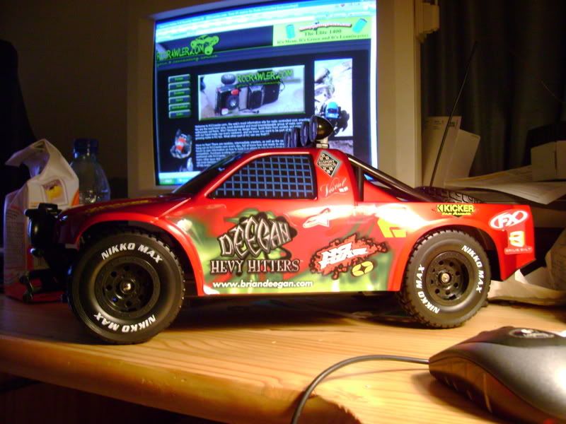

MIGHT NEED SOME WORK PENDING ON HOW MUCH DETAIL YOU REALLY WANT.. ahh sorry all caps.. but this one is from walmart it was like 49 bucks for the whole truck running... (i got it for the body and working lights
this one is on my xrc chassis..

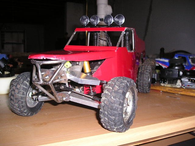

Prime,
That looks great. Post up more shots as you get further allong into the build.
Will do. I will be starting my build up thread soon. I have the front suspension arm mounts almost done. Just need to figure out shock and mounts.

microgoat,
Now youre just teasing us:flipoff:.
Give us something to drool over, PLEASE.
That is insane, looks like THs Truggy.
Very nice, looks great so far.
What bugs are you working out of it?
What bugs are you working out of it?[/quote]
mostly suspension set up and trying to put her on a diet somehow
i have a mamba max and a 7700 in her very fast but i need some sway bars on it to keep it from rolling over.
i have a mamba max and a 7700 in her very fast but i need some sway bars on it to keep it from rolling over.[/quote]

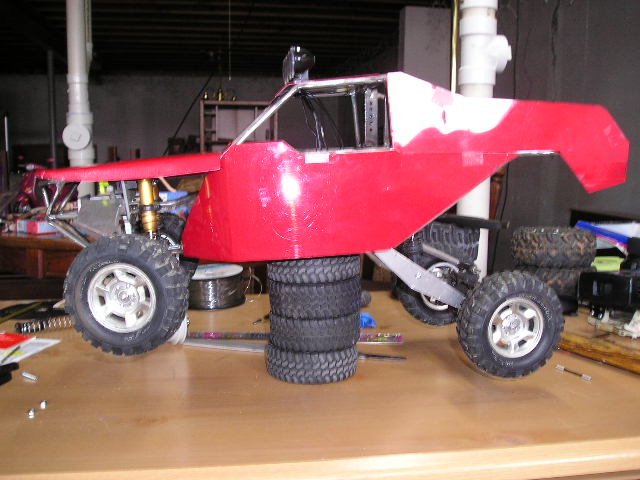

you just need an even bigger motor to get the wheelspeed up even more so it doesnt wanna flip.. lol j/k got any videos yet ?
LOL yeah bigger motor, I' actually working on a second one thats all aluminum welded up to save some weight i guess i could put my BB .32 OFNA engine in it HMMM
The 51R will be rolling by the end of the month, running soon after.
If I did the math right, it'll be as fast as a T4 with a Mamba Max 4600. And there's no tranny.
