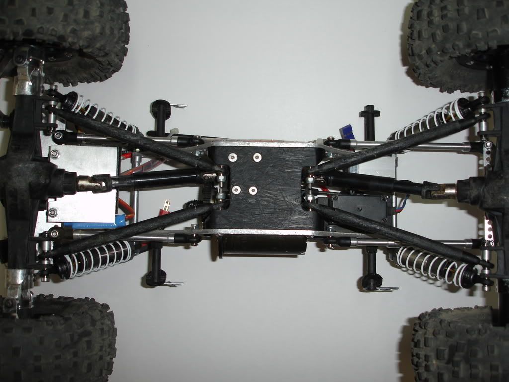

***CDW 1.0 Chassis Build***

what's the wheel base? can you make it longer? what if i don't want the banana styled side, can i get two rights?
It's 12.5"WB...you can make it what ever you want if you dont care about the rules...sure you can get 2 braced sides.
What size spacers did you use on the axel where the link mounts....
On mine they are 7mm spacers, but I'm using axial rod ends, while his are revos.
the axial and revo balls are both 7mm the tmaxx balls are 6mm the opening on the axial axles where the link mounts is 15mm so you would need a total of 8mm's of spacer in any combination aslong as its 8mm's"thumbsup"
