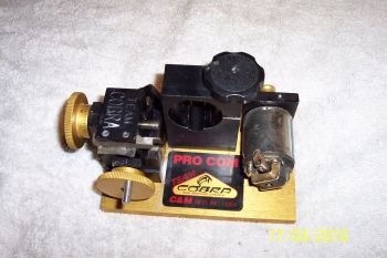

Holy OG stock motor comm lathe batman!!! Check out this jewel of the early days that just got posted in the sale section...
