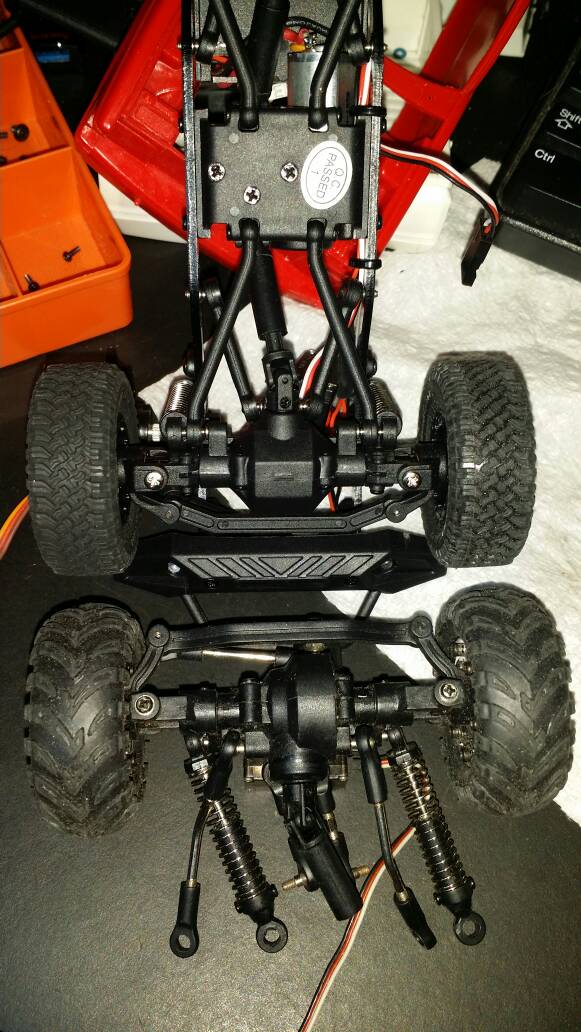

Here is a picture of the current setup on my Barrage. Re purposed the o ring to tie batteries to the servo, works plenty good. I wanted to get more weight in the front of the rig for climbing purposes.
This is going to sound retarded but how the hell did you get the o-ring off of the rear? Im going to just velcro mine to the front but I want the dam o-ring gone but don't want to just cut it.
Mine just came right out if I recall. Just look where it's caught and pull it out.

Can anyone who has one of these tell me what the width is hex to hex on these axles? I’m curious if they are narrower than the Sumo axles.
I had the exact measurements written down somewhere. I'll look again tomorrow, but they are nearly the exact same width at about 4". Maybe a mm or two difference between them. The Barrage axles are pretty similar to summo axles. The ring gear is identical and can even be swapped, though being the same it doesn't gain anything. The pinion isn't the same tooth count, but won't swap without mods.

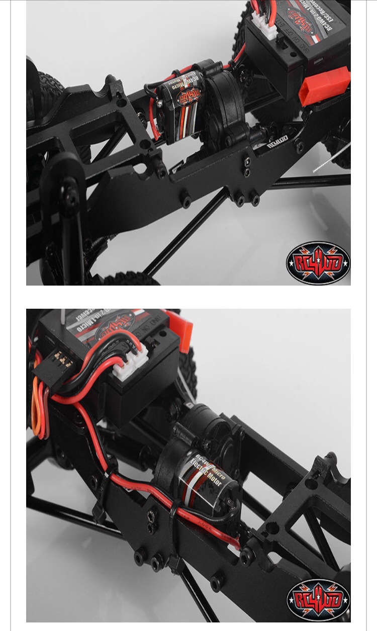

Can anyone tell me if the new tranny of the gelande II 1/18 can fit in the barrage? It’s 3,5 mm wide

I already broke down the ecx and counted the gears, and took a bunch of pictures. I was going to do an updated compatibility guide soon.
Fwiw the 1/24 ECX barrage axle ring gear is 24T the pinion is 12T for a ratio of 2
The sumo ring gear is also 24T ,and the pinion is 13T for a 1.85 ratio
Interestingly the Sumo & Barrage ring gear will swap fine in the housings and on the axle, but being identical it wouldn't have any benefit. The 12T & 13T pinion gears however don't swap.
It fits between the rails fine but you will have to fab some vertical tabs to bolt it up. The links connect to the stock skid plate. Or you could fab some new link mount points and put the RC4WD tranny between the rails.
The higher axle ratio seem an odd choice since they call it a crawler and clearly could have gone lower like the Sumo.
Sumo gears top, ecx bottom

I may be confused here, but if the barrage has a 12t pinion, and sumo a 13t, and they have same ring gear, wouldn't the barrage be geared lower, more crawler oriented?
Correct, that's what I get for rushing haha.

Do you know what the reduction is on the gelande transmission to even know if its a benefit?
