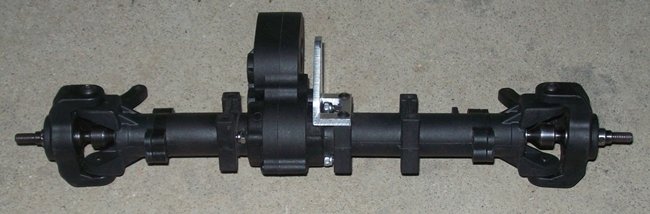

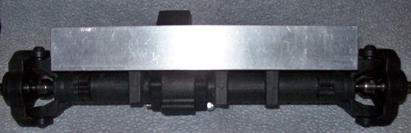

This thing got really rigid, really quick. I shaved the mounts flush with the tube, and set it with 4mm screws. Most of this will be cut away once everything is mounted... there is plenty of room to play. I swapped sides on the Cs, so at 10* caster, the brace is tilted back enough to even the leading edge up with the front of the tubes.

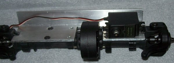

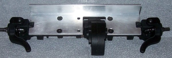

Here's a pic of the fit on the servo. Lots of options here, if I break down and pay for 1 decent servo, I can put the batts/rx on the axle, too. With the ESC mounted with the clamp, that would put an entire powerplant on each axle... leaving the chassis empty, and ready for the stand-alone cam system.
A, unless you say otherwise, I'm going to mill your mount's tops flush. The alignment we worked for will be nearly set in stone, if you make a rigid brace.

The only thing that doens't thrill me about he knuclkes is that they aren't zero ackermen. It almost seams like they will hinder the stearing a little bit unless you cut them off and drill a new stearing mount hold in the position that would make them zero ackerman.

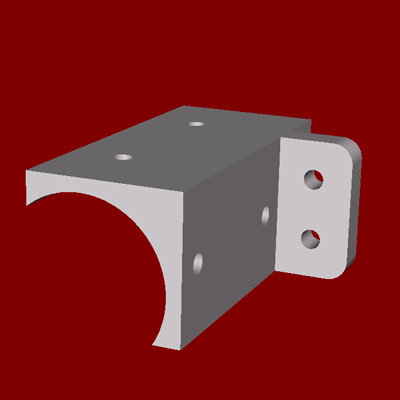

This is what I was thinking. Smooth out the tube and make a bracket like this to mount the servos/lower and shocks.
