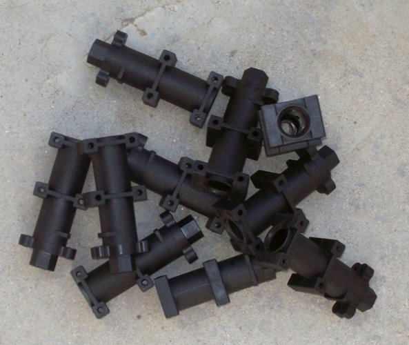

The long tubes are cut, squared, the ID is tapered (to accommodate the stub's stress riser reducer), and hand de-burred.
This is the last of the long tubes.

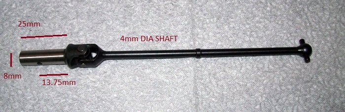

The UJs have identical dimensions to the Savage, from the pivot pin out. There are a couple ways to fit these to the stock Max knuckles, we'll hash that out soon.
The Max short tubes all came with bearings, in ziplock bags. Pulled from RTRs. As I have stated, I don't mind that a bit... I hate backorders... but don't be surprised if they go out of stock soon.
Guys, these things turn smoothly at a far greater angle than the Integy CVDs. Until they are mounted, I won't try to guess the max, but I suspect you will both be quite satisfied with your purchases. :mrgreen:"thumbsup"

I think we've got a winner here!
There is a tiny bit more angle to be had by rounding the ears with a dremel, and the useful angle will be determined by the precision and rigidity of the setup, but, according to my True Angle... the interference in the joint begins at...
50 degrees.

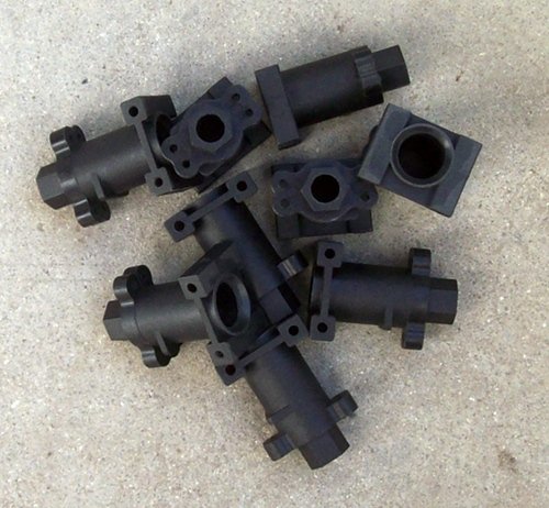

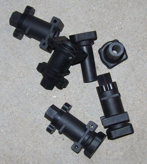

Those are the cut tubes, looks like they cut up really well.
Yup. "thumbsup"
I had to back off on the tolerances a bit on the stubs. This stuff cuts very cleanly, and the variances in the tube IDs were enough that when the stubs were cut too close, a random pairing caused a problem. I pushed a snug pair together by hand, and they jammed enough that I couldn't get them apart by hand... even warmed up. The Rover gets that set, I kinda chewed it up (cosmetically) prying it back apart.
You guys will get your pre-paired. If you lose track, just swap them so you like the fits. None will jam, but some may feel looser. This will not affect performance, but just bugs me as a machinist. I really like this stuff... the Grizzly does too. 1 RCH is easy to attain.

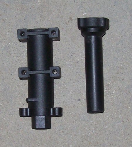

This is your first long stub. It's cut very precisely against a very tight mandrel... and you can see the difference in the precision of the Mad vs Max parts. Hard to see are the minor voids in the Mad plastic. When cut, they leave what looks like a bubble on the surface. Not a problem, just an observation on the overall quality of the moldings.
Kinda cool is the fact that when assembled, all the precision cuts and hand dressing are hidden. These things have to be checked closely to see that they aren't just 1 stock molding.
