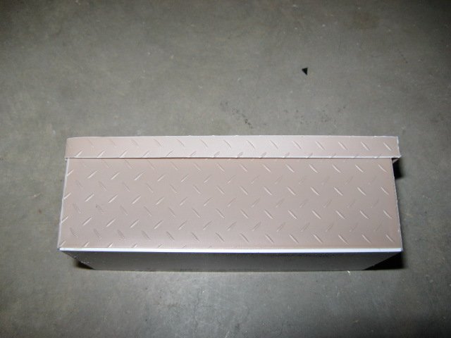

As noted above, I'm spending lots of time in hotels this month for work, so since I can't braze, I decided to break out the styrene and inhale some glue fumes! Made up a cover for the motor/tranny, and a box to put all the electronics in:

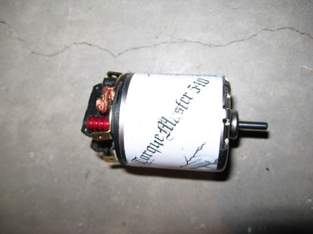

Also got a new powerplant in the mail along with some other goodies "thumbsup"
I'll likely trim the box a bit more, but there's not a heck of a lot of room in there. It just looks too high up right now. Renslipevol is hooking me up with some scale hinges for it too. After that, time to paint the styrene, then install the grill/lights, steering wheel and driver. The end is finally in sight (I think!).

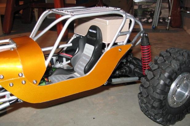

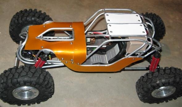

A few more progress pics:
Got all the styrene work done and painted. The electronics all go in the box in the rear. The motor is underneath the styrene on the passenger side. A 2s lipo slips underneath the styrene the driver's seat is mounted to, with the servo cord running along the frame on the driver's side, so everything is pretty much nice and hidden.
As for the lights, I ended up passing (wimping out) on the frame mounted steering for now. Partly because I had not designed the frame with that in mind (would have brazed on some more nuts/steel plating). Instead, I've cut down the grill and will mount it to the servo. I'll then work on bending the hood to have it conform to the grill. There's enough flex in the hood that it doesn't limit the suspension at all.

So got it out for a good test run today. These handwound motors live up to the hype. Lots of torque, but lots of wheelspeed too!
