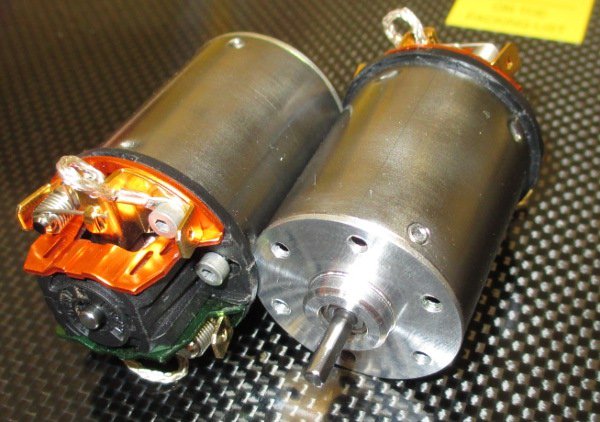

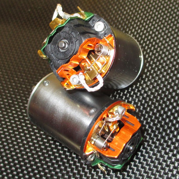

Here is a Prototype set of 16t Puller 500 Flow type in Rasta for JHall! These weighed in at 257.3 grams for the set, a few grams heavier than normal because of the higher copper fill. He will be dropping 3.2 ounces as compared to the CrawlMasters currently in the rig. It would be a 4 ounce reduction from a set of TorqueMasters.
While building this set of motors I had a few more good ideas for production. It will decrease the complexity of the motor, allow for complete compatibility between any style, reduce the amount of hardware, and reduce the machining quite a bit too. Bottom line, engineering for production to keep the final price low. I don't think we can do much better!
But in the mean time, I'll keep producing one-offs for people that want em "thumbsup"

When the next shipment of magnets comes in I will have enough parts for 50 pairs. I'm counting up all the parts this morning to see what I can build.
Dam those are pretty!!!
How would you say the torque is verse a 540 torquemaster?
I don't have a dyno for stall torque right now. I broke bearings on my XR with a set and never had an issue getting them bound down, so certainly enough for competitive driving.
