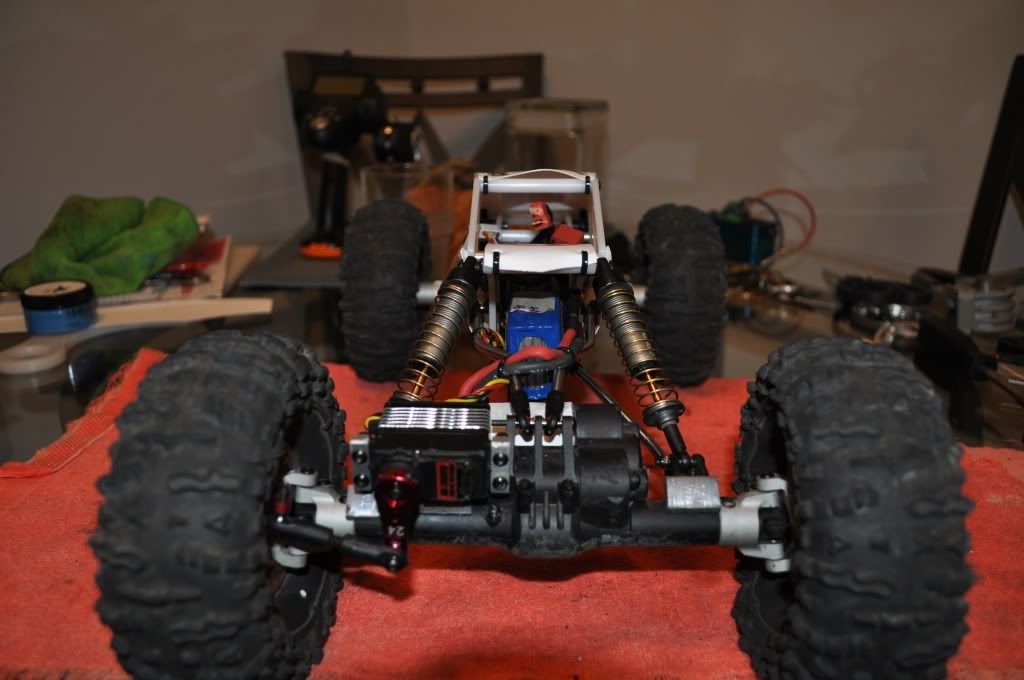

Well...take a look at what showed up at lunch today!
I went ahead and threw the 600 hubs on...much better width. I'll have to measure later, but it looks like the rear is right at .25" or less narrower on each side rather than a full .5" or more.

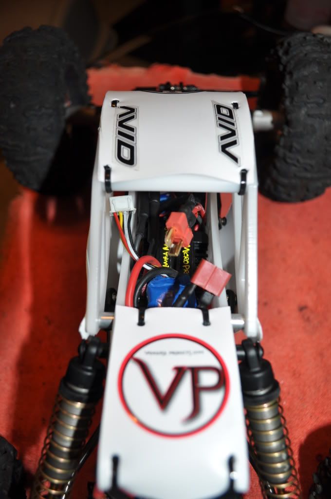

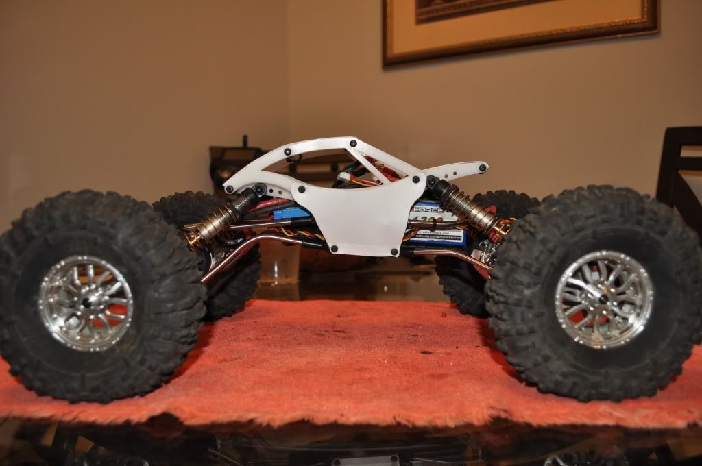

IT LIVES!!! Althought I haven't had it out on rocks yet, I can't say how happy I am with the size of the Mamba Micro Pro's. They were very simple to program (Castle Link software ROCKS) and fit in this chassis like they were designed for it. At this point I just needed to tear into the front axle and upgrade to 10mm flanged bearings and hopefully my transfer gears will show up tomorrow. Then I'm gonna pick up some 1/4" steel round stock and replace the all thread that I'm currently using for the tie rod. I figure this will add weight in the right place and not be in the wheels...and it will slide over rocks easier than aluminum or this all thread and be plenty strong until I pick up a Ti replacement. In any case here it is:

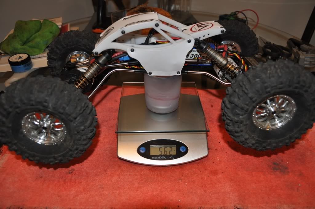

At this point it weighs in at 5.62lbs RTR

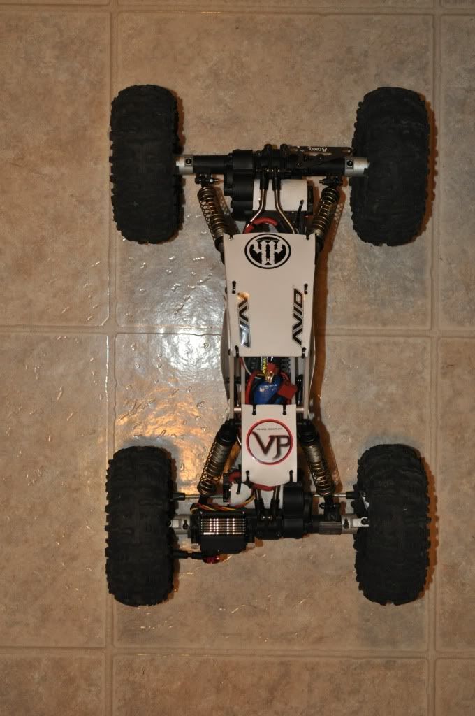

I also received the 600 hubs today and threw them on...here's an overhead view showing how close the front and rear are now. The front measures 10 7/8" outside of the tires and the rear is at 10 5/8".
