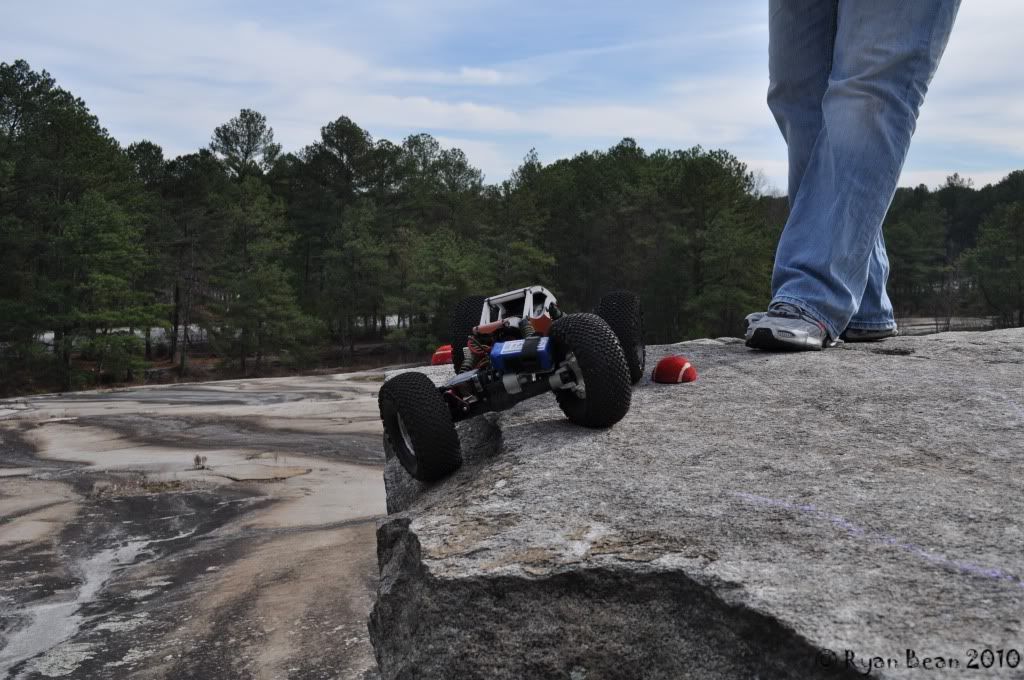

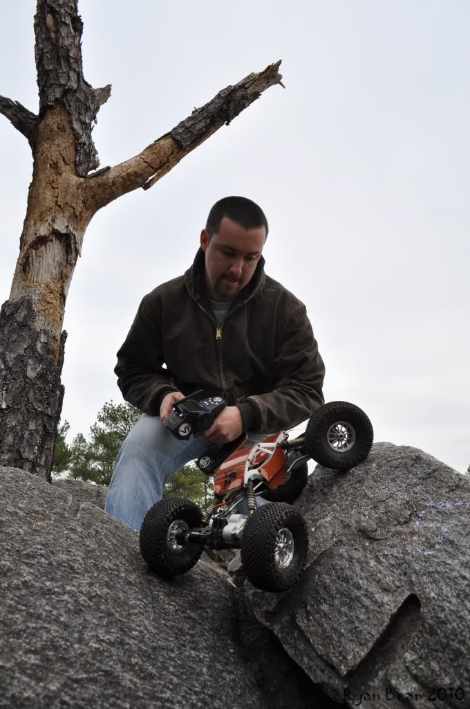

Here's some pics from the Crawling for Kids in Atlanta, GA this past Saturday...
I'll throw some more up later on.
