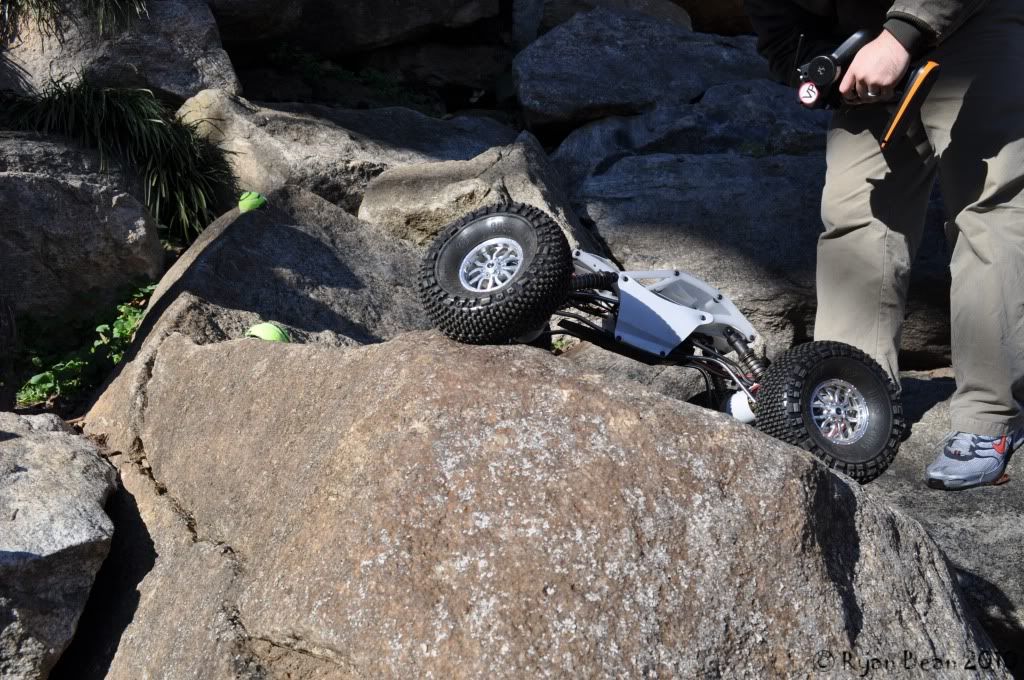

The Boss Claws seemed to work very well for you the other day. Whats your opinion on them?
Thanks Michael! I forgot to throw up a quick update the other day when all my new goodies showed up. Here's what showed up last Friday
The Boss Claws performed really well. I was curious what type of foam setup they would work the best with for my liking. I simply started with the 5.5" Novas with firm inners and soft outers. They seemed to do really well with this setup. I haven't convinced myself to cut the tread yet, but I've caught myself looking at them trying to figure out how I'd like to do it. I threw the VP tranny cases on since I finally got a set of steel pinions to replace the nearly worn out stock aluminum version (not exactly the best material). I'm gonna hang onto the axle cases until VP throws down the aluminum top portion down the road. That is unless I need them before then. I also chose to go with a smaller wire size from the motors to the ESC's. I had been running 12ga but have dropped back to 16ga for more flexibility and overall ease of use really.

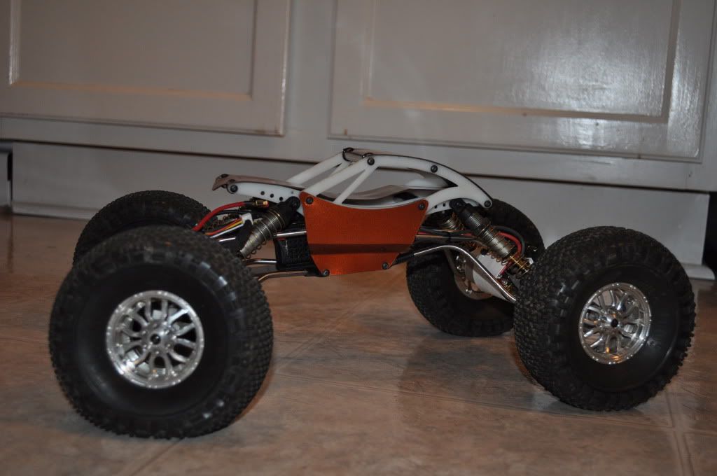

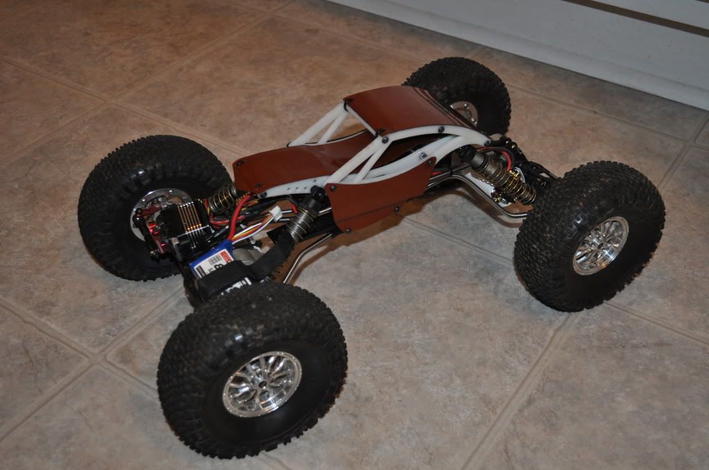

Thanks to Limited77 I have a new set of lexan body panels! I threw some paint on the just a little bit ago and bolted them on and did a little trimming. I got a little carried away with the heat gun on the hood panel so you'll have to excuse the waves. The color is Fiery Orange from Pactra backed with black. I sprayed two light coats and one heavy coat of the orange. See what ya think...
