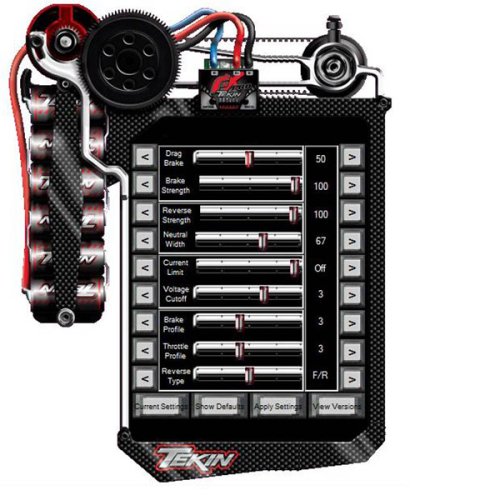

Here is where my setting are at right now............
