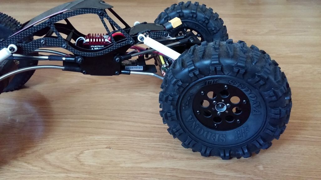

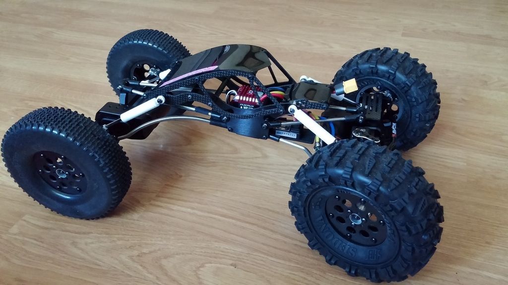

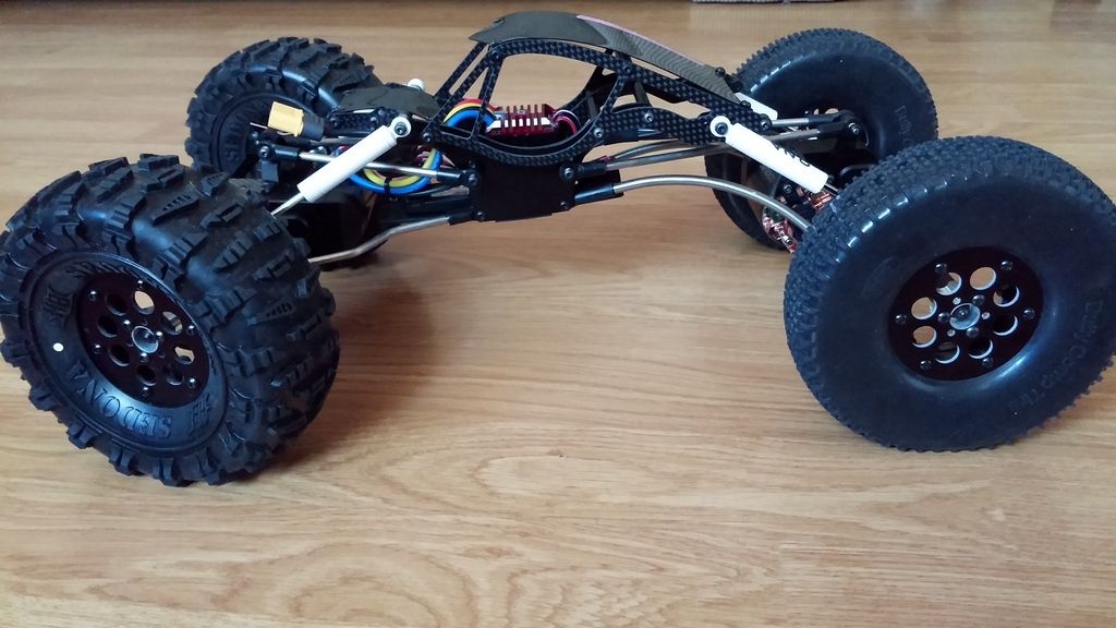

Just finished up the build, waiting for the lipo to show up tomorrow. I have some nanotech 3s 1300s that I use in my oxy 3 helicopter but they are way to big. I will get a couple pics up later of the bully.

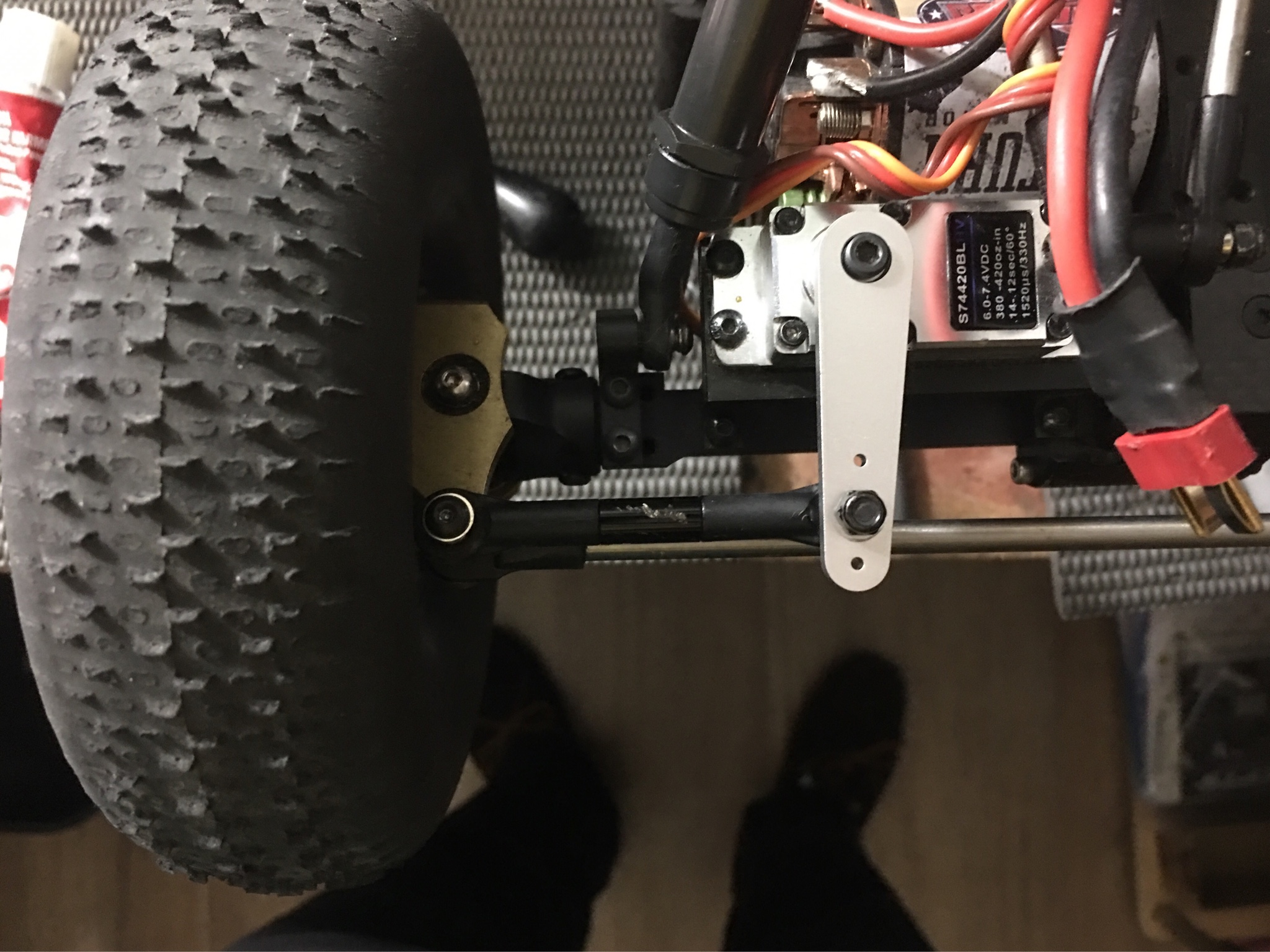

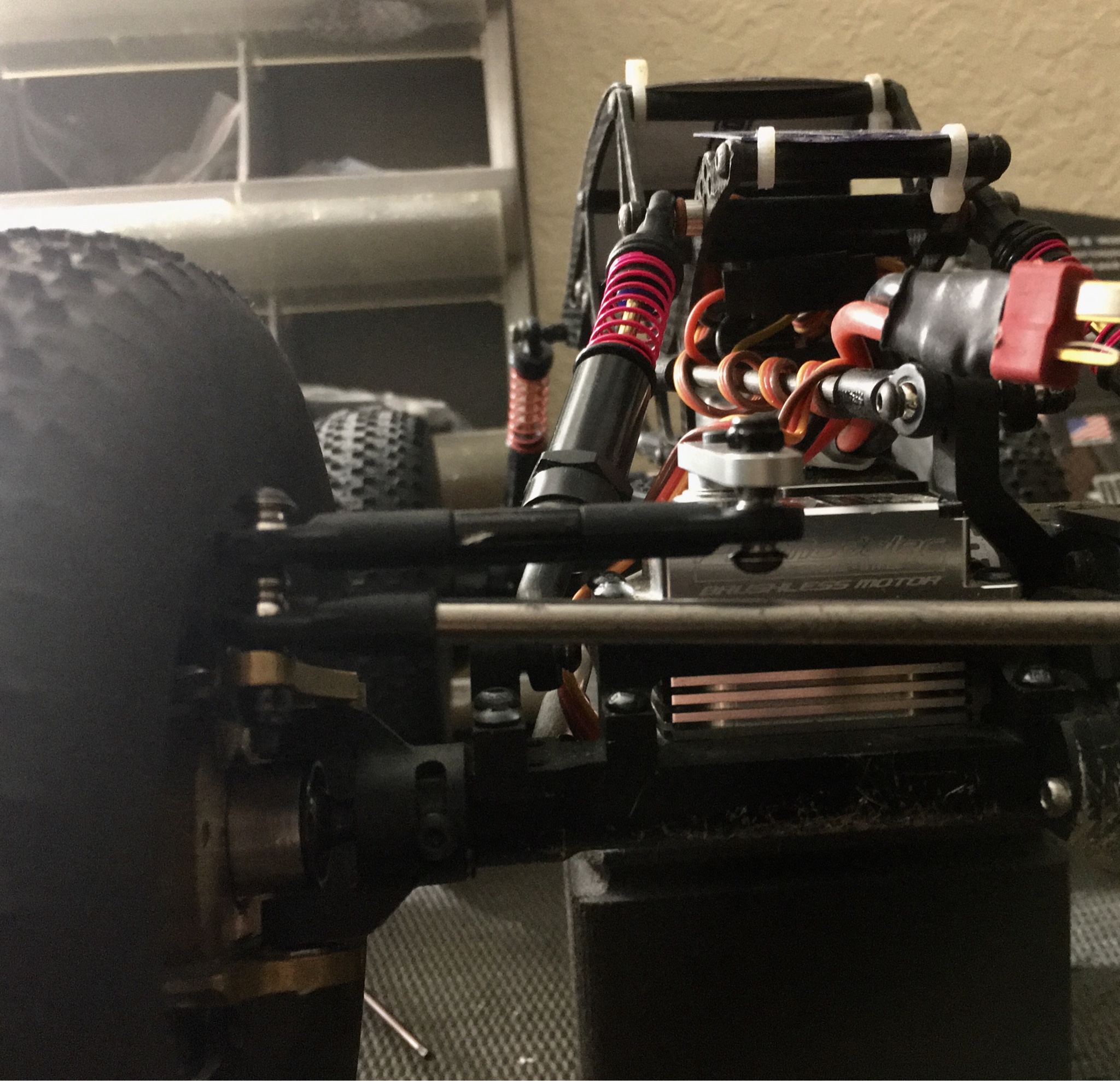

Looking good ! The drag link angle will be an issue. I fought with mine forever and when I added my big knuckles up front I had to fix it. See how mine is parallel and even with the tie rod ? I ended up getting a 1.5" Futaba servo arm.

Clock your knuckles back, put tie rod on top of the knuckles and drag link on top of that and add a 3mm spacer to your drag link. That will fix your crazy angle on that drag link.
Edit: also add longer rod ends to your rear links to clock your rear axle up.

What benefit would I get from clocking the knuckles and fixing the drag link angle?
Re: New Bully 2
By clocking you lift the motor up, that's clearance Clarence .
As for the drag link when it's straight it will be smoother, and that's always better.
I went to a longer arm and the servo works less and steers better.
Any change you make on your rig will make it better or worse. Take your time and fiddle until you are happy, or see something else !

Thanks for the explanation "thumbsup"

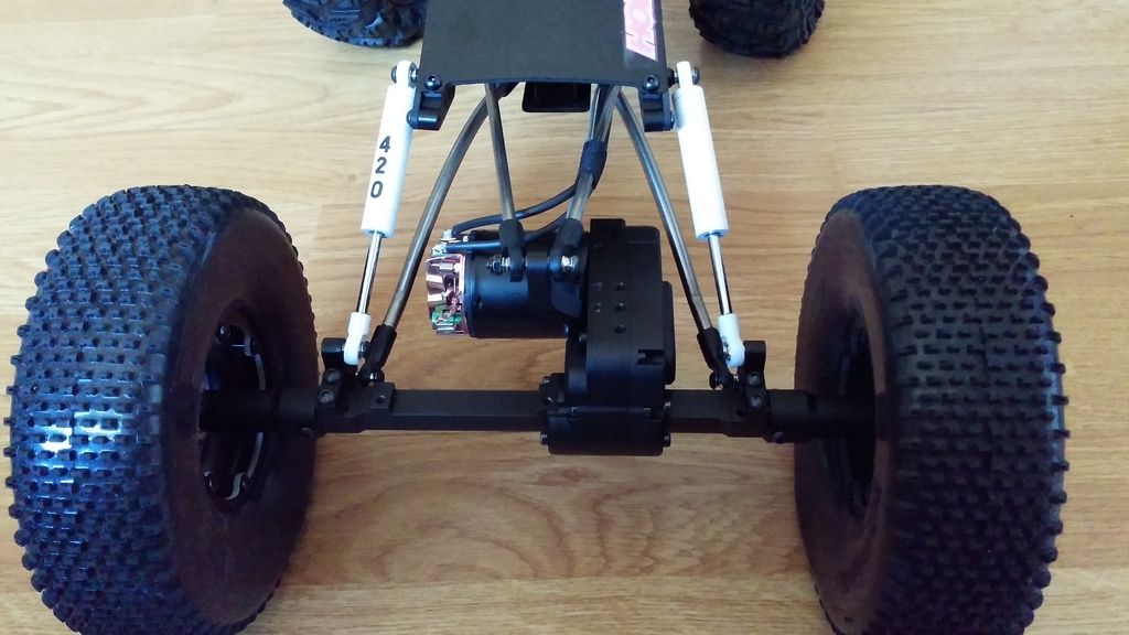

I made a servo skid plate out of a pencil tin can (not a soda can) and got my rear motor raised by installing the rpm longer rod ends.
