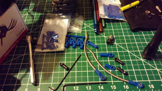

2660 + cap mod. Pink mini T springs f/r. Dlux no pre load spring cups or rcbros sells regular spring cups meant for mini T springs.
If you do the cap mod, put the bent rod end up front (ones on stock shocks) and rear use tra2742x.
3mm or 4mm? All these diy's with different size screws. The stock rod ends are 3mm so i'm assuming thats what i need?
