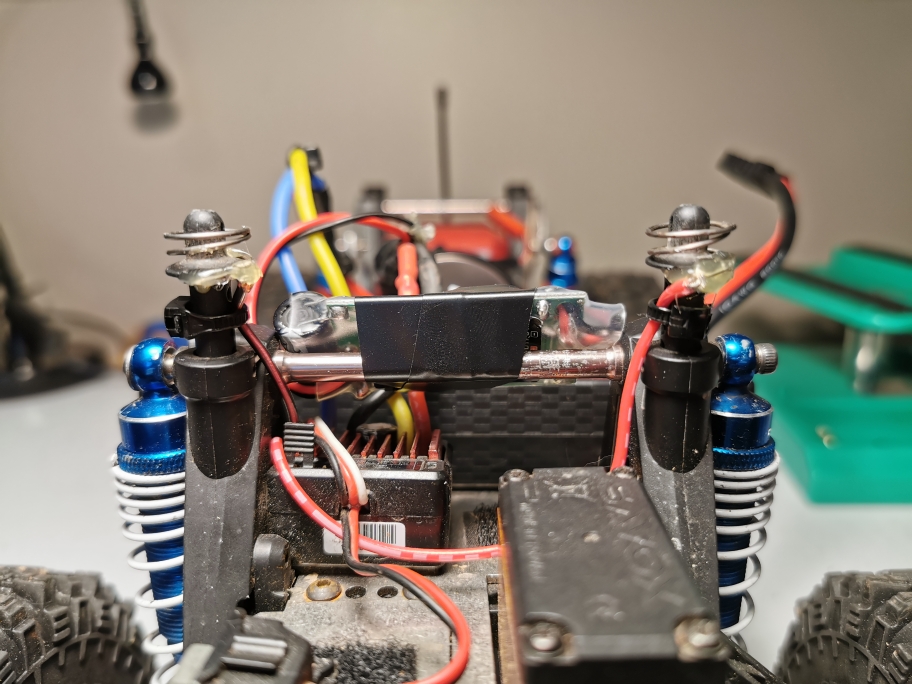

I moved the light bar from the cage to the front bumper. The light is actually useable there, as it was just reflecting off the white roof before.

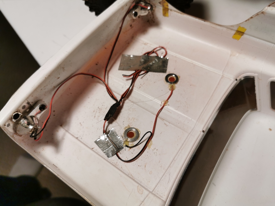

I also installed a BEC as the Savox 1230 just wasn't getting enough power from the ESC, and I hooked up the headlights to the front body posts so they'll come on when the body is put on. They are still on a switch though incase I don't want them on.
All the new wiring is temporary as I'll be redoing it all when my new ESC arrives.

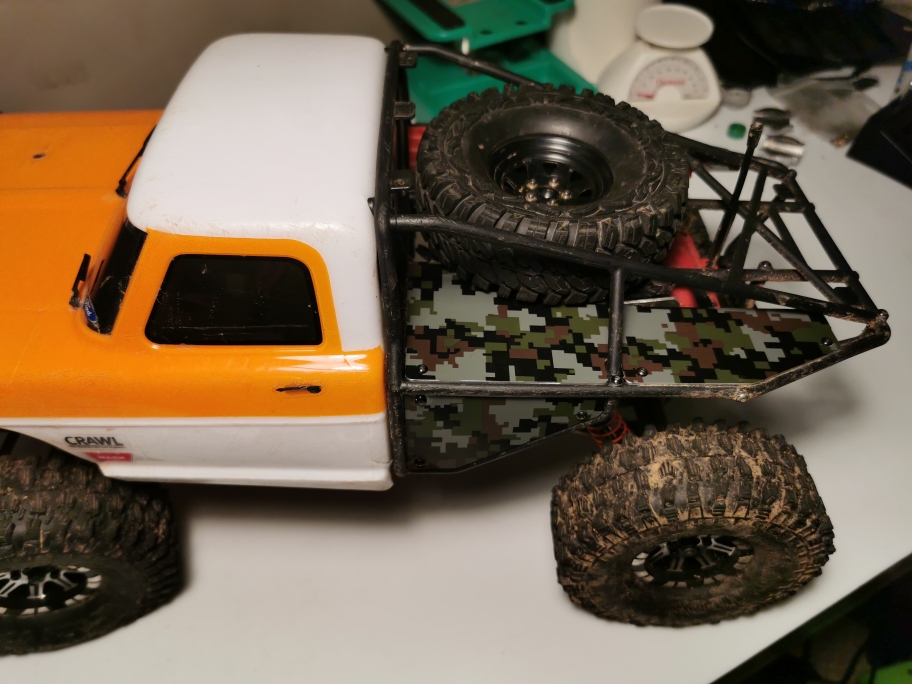

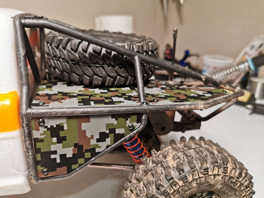

Oh, I also camo wrapped the aluminum bits on the rear.

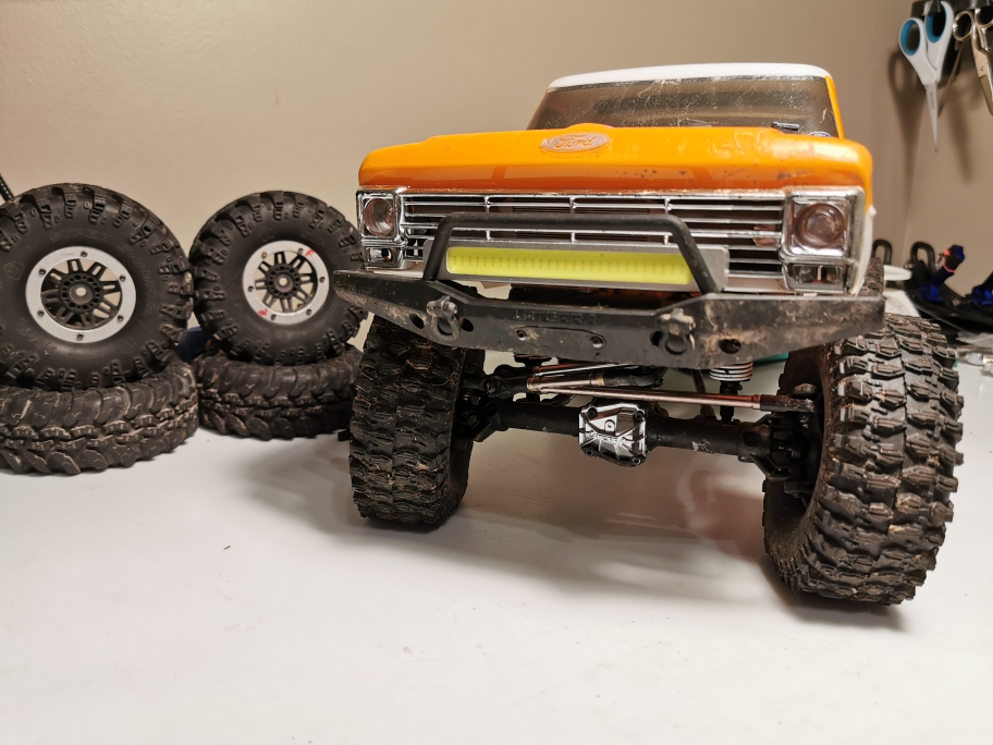

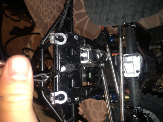

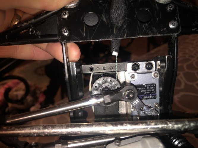

Rigged me up a servo winch. All is well except how I have the line run through the bumper. Any ideas to make it better would be appreciated

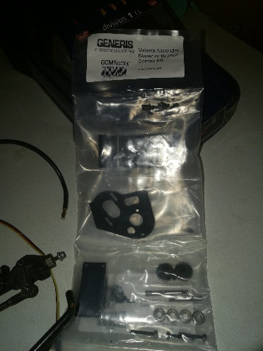

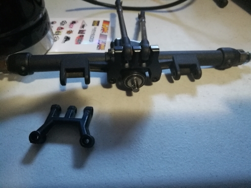

And gcmracing rear truss. Ended up readjusting both up rear links to 4.5mm instead of the 3mm gcmracing said to and all looks good.

YOu could cut out a larger hole in that bumper and bolt a fairlead on or buy/make a different bumper.

Didn’t even think about the fair lead route! This lil rig is a crawling machine. With Trujillo spring mod plus inner ink pen spring it’s solid with almost zero TT

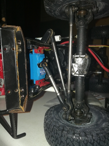

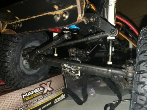

So been trying to fix the Issue of drag lin and panhard to minimize the bump steer made no progress. What are the correct link lengths for panhard and drag links? Reusing stock rod ends.
Can't tell from the pic you posted, but mine are all running steel threaded links with plastic ends, draglink to top of right side steering knuckle, very slight bumpsteer, but no flex and if your servo is strong it will steer and moved the truck! Length of my draglinks is about 90mm eye to eye.
Just measured, my custom tie-rod is 145mm eye to eye (stock uses 90mm aluminum tube with 20mm setscrews and stock plastic ends). This is same for all Ascenders regardless of wheelbase.
Drag link for WB1/WB2 is shorter than WB3/WB4
WB1-2 is not sure as I don't have one.
WB3-4 is about 75mm eye to eye, however I prefer to run a longer adjustable turnbuckle to top of steering knuckle, with plastic ends that is about 90mm eye to eye.
Stock uses 38mm aluminum tube with two 20mm setscrews and stock plastic ends, eye to eye about 75mm length.

I forgot to take the link pictures. One is with the truck on it's side and on its wheels not sure what other pictures you would need. And a flex shot of everything.
Thank you for the response it is very much appreciated and helpful. I need to get me a Calipers to get more exact measurements and details
Sent from my FRD-L14 using Tapatalk
Look at the second pic Natedog posted. The goal is to have the steering link and the panhard link parallel to each other when looking at them from the front.

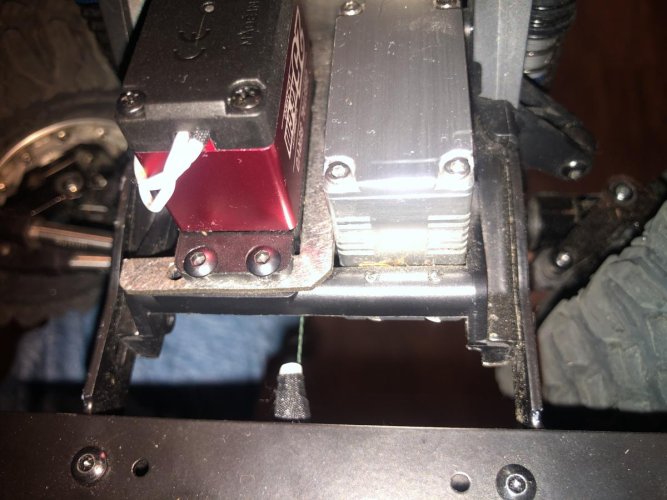

Got me some cheap beadlocks, pitbull mad beasts, and CI dual stage foams. I also made me a servo winch out of 25kg servo.
