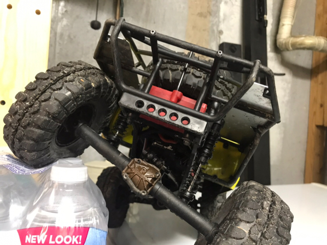

Been changing up the look of my Ascender Truggy. Been working on a new body and wanted a simple low profile bumper for it. Seemed like a good time to step into the world of Brazing. Thanks again to Ernie for all of your insight it set me off on the right foot.
This is the result of my first five welds. I may add a transverse support bar under it yet. Undecided.
I like it! Looks like an old farm truck bumper. Mucho Character!
"thumbsup""thumbsup"

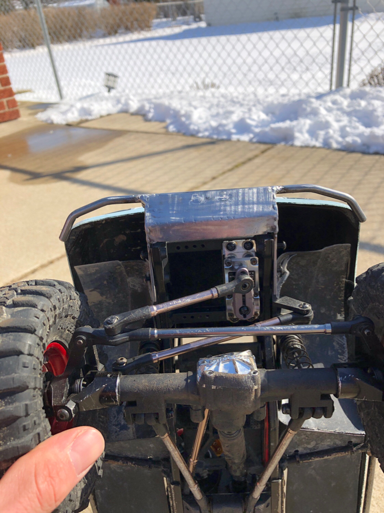

I took the neighbor kid out crawling on Sunday and the set screw somehow pulled out the threads on his draglink on his F100. I told him I'd fix it real quick back at my house...
Of course, I can't just leave well enough alone, especially after I noticed how much bumpsteer these trucks have, I don't know how I never noticed it before? Anyway, I ended up making a new draglink that attaches to the top of the passenger knuckle (instead of intersecting mid way on the tie rod) , more closely (but still not perfectly) matching the length of the panhard bar.
Doing that flatened out the draglink angle a good amount, so it was no longer parrallel to the panhard. The Aha! fix was simply moving the servo from the underside of its mount, to the topside of its mount. Now, I'm not saying it's perfect steering geometry, but it is MUCH better than the rtr setup, and almost free to make (I had all the materials/ hardware/ rod ends laying around.)
I spent some time with him setting up his radio, setting servo travel, end points, and adding throttle expo, and he noticed a big improvement in driveability. I convinced him to take advantage of RPP's 15% off for President's day yesterday, and he ordered some SSD brass knuckles... it's almost as fun fixing up someone else's ride as it is my own! Cheaper too!

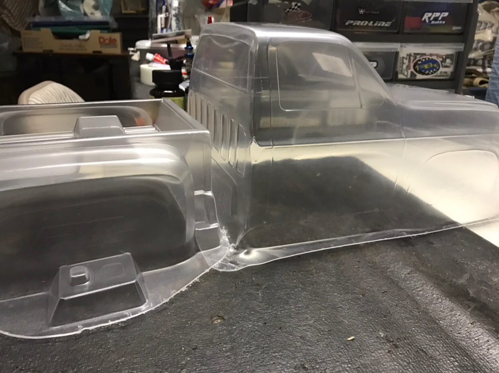

Picked up a proline 78 k10 body, wish it was a fleetside but oh well. Going to make it look like my 86 k10.

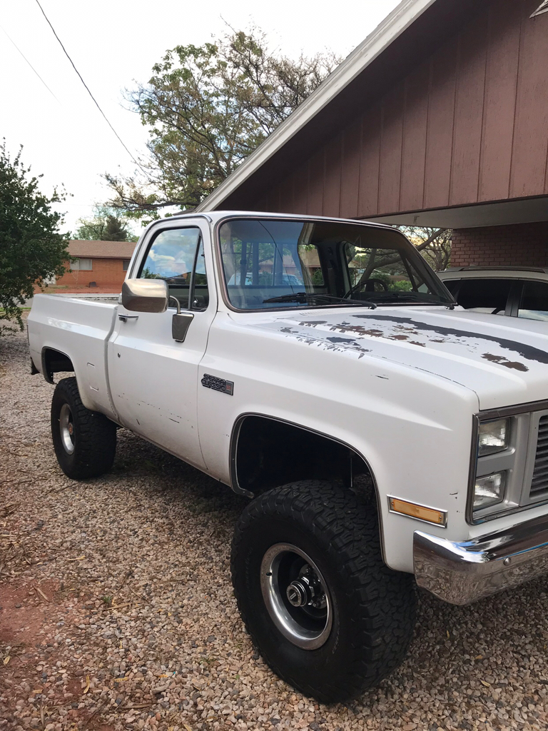

I finally decided to delete the spare tire and mount on my K10. Lowering the COG for free, without adding weight just seemed like a win.
