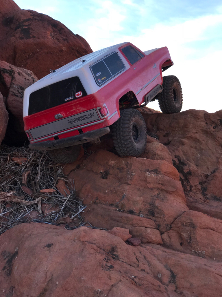

Been trying to wear out my RC4WD IROKS but they wear like iron and still have tons of traction

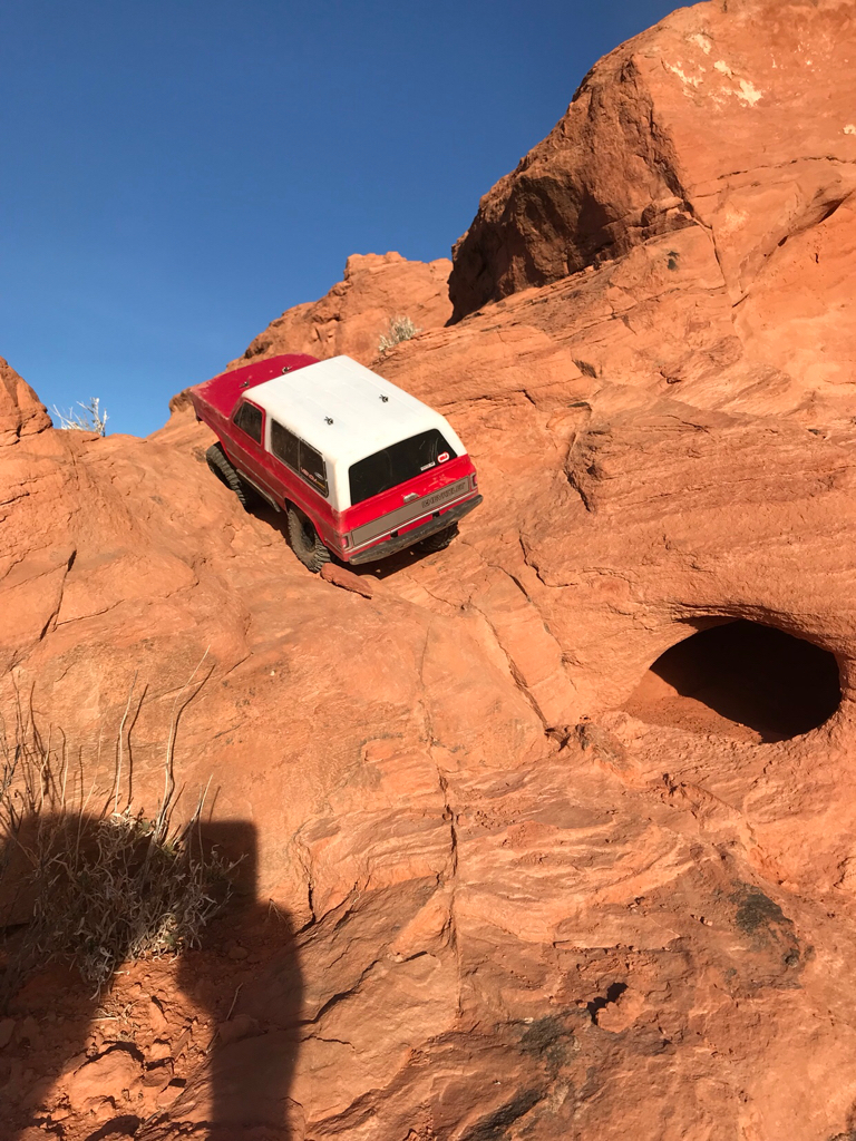

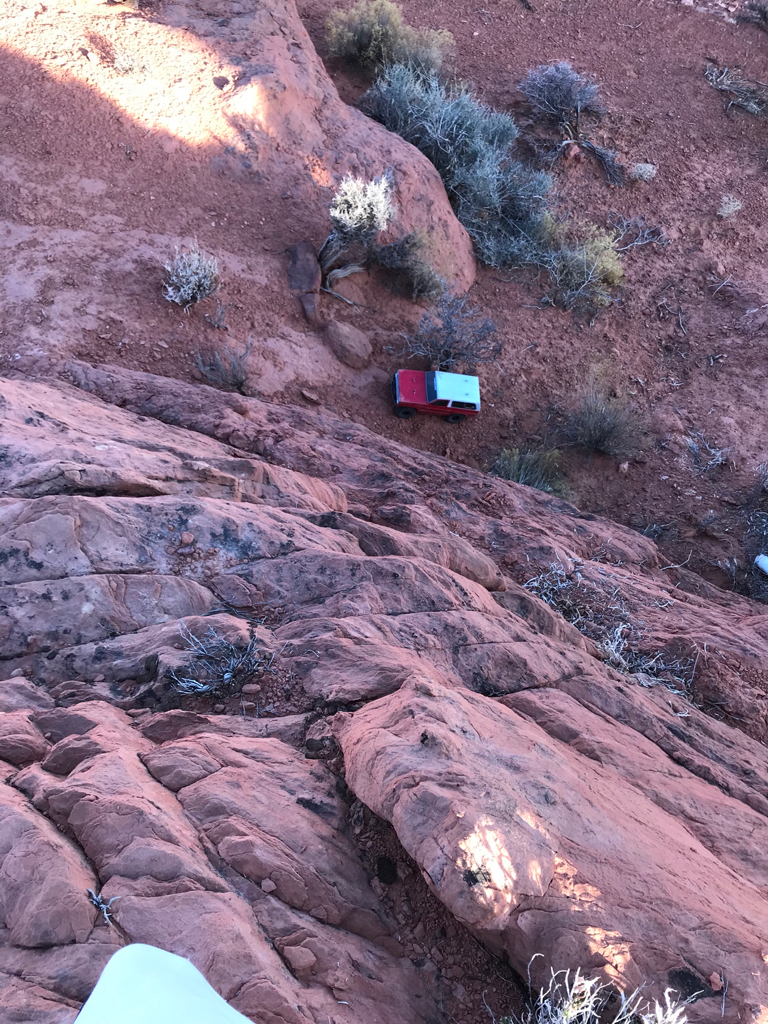

It’s like a cat, lands on its feet every time. It fell about 20 ft. More like tumbled end over end

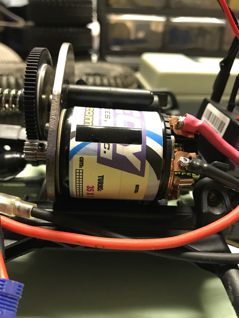

Finally picked up a shorty battery. Ran it for a good 2 hrs and voltage was still at 3.5. Anybody know what the voltage cutoff is set at from factory. Also I finally got my new motor installed that iv had sitting around for a couple months. Nothing wrong with the old one just thought I’d try it out. I
iv heard people say the newer intent motors are junk and not as good as the old one but so far so good

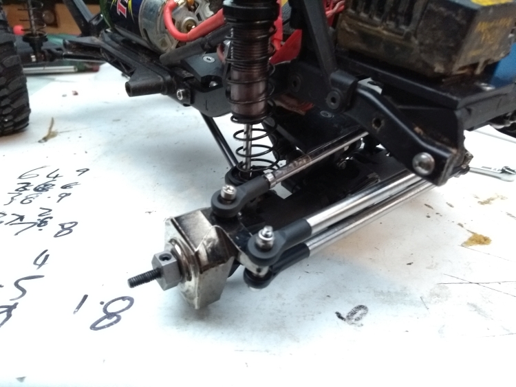

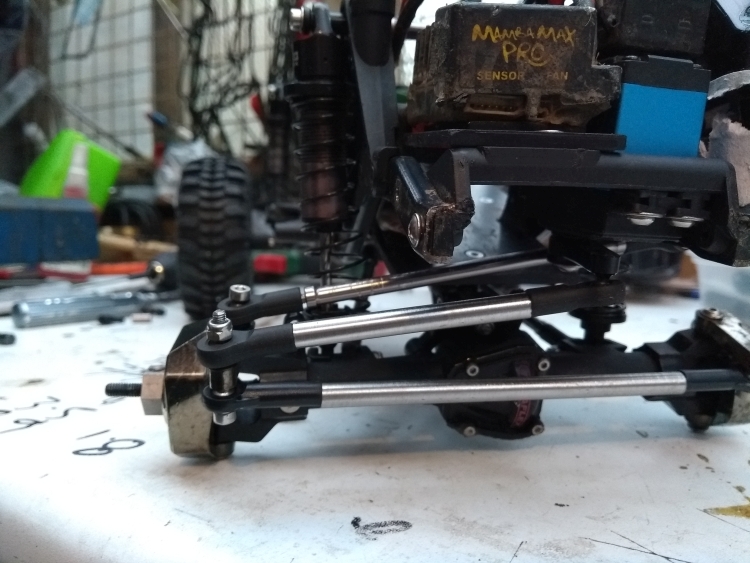

Made up steering links and also panhard bar today as it's raining (again!!). I used 3mm stainless threaded rod, and 6mm stainless tube. For the steering the old drag link is long enough to use the original ends and fix to the top of the knuckle which should reduce side movement a bit. A couple of small washers to shim. Steers and move fine in the kitchen floor test drive.

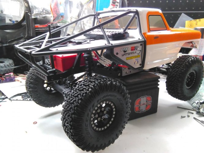

Did a little work,outboarded shocks, rear upper link mounts,lowered battery tray,new tires and wheels.
