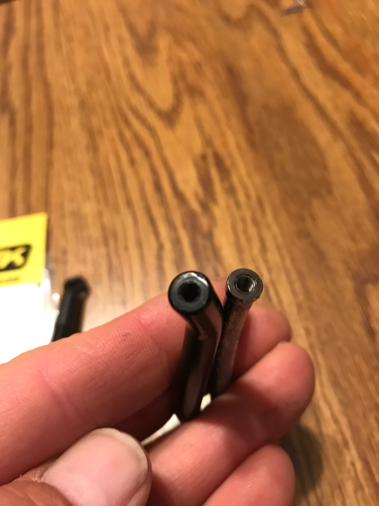

Just get the SSD links and be done with it. Those blue things have an aweful ridge between link and end, will get caught up on everything.

Pinion angle was the same because the links are the same length as stock. Just one piece. I never bent a stock link. Don't drive like a savage. I actually wore them to a flat bottom and was tired of aluminum sticking to the rocks. I'm not a ssd fan boi by any stretch, kinda critical of their lack of perfect fit for price ratio but I do like the links.

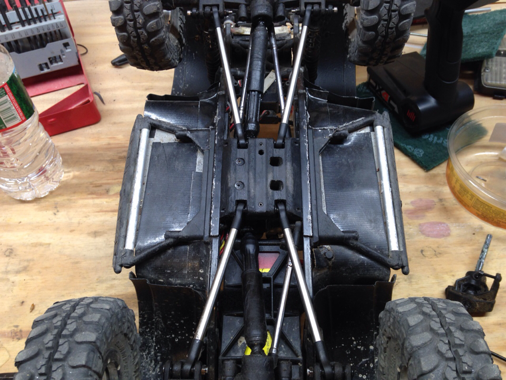

I think I paid $12 for 4 of these, I can use the stock ends and some minor trimming and they will fit right in. They are aluminum but thicker then stock.

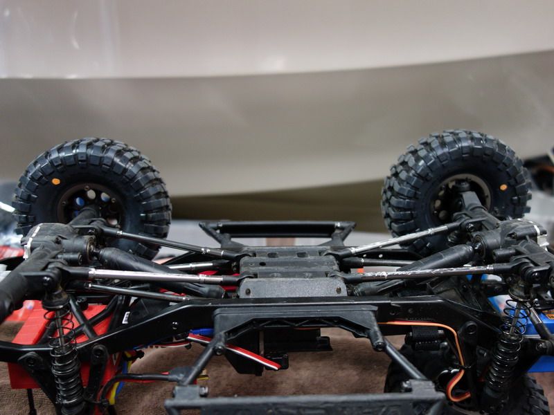

Here's a pic that shows pinion angle pretty well on my WB3. The rear lowers are the ones I shortened about a mm - probly need another 1 or 2mm ground off them...
I was curious about proper pinion angle for these - I know in a 1:1 if it's off they'll vibrate a lot, so the output for both ends are supposed to be the same angle. We would put a CV joint in the TJ Wranglers and tilt the diff up and point it at the TC.

Thanks for the picture, I also have lots of 1:1 lifted truck driveshaft experience and it doesnt' translate 100%, but does have an effect. I've done the opposite of your lower link shortening, iirc I added 2-3mm spacers to rear upper links, just enough to tip pinion up out of the rocks, but don't ever let the rear joint angle go over center as the suspension compresses. :ror:"thumbsup":)
I would have done that but the overall WB is a couple of mm long so shortening was a good option for this one.
I was surprised at how much more tilted up the front was. Of course Vaterra isn't gonna custom build links for each wheelbase, so I get that. Some fine tuning seemed to make sense here.
I'm trying to work something out with 'titaniummike' on his bent links. I'd be fine with SS, and just the lowers. Will keep ya's posted... 8)
Cool, upper and lower rear links are same length, shorten the uppers little too. :)
I was trying to get the pinion more level or even pointing up a bit. Mission accomplished, but likely could have gone another mm or two. Maybe I'll fiddle with it some more.

"Titanium-Mike" is all 8 links only for $80. So I got a pair of SSD's for lowers front and back. That will have to do for now.
